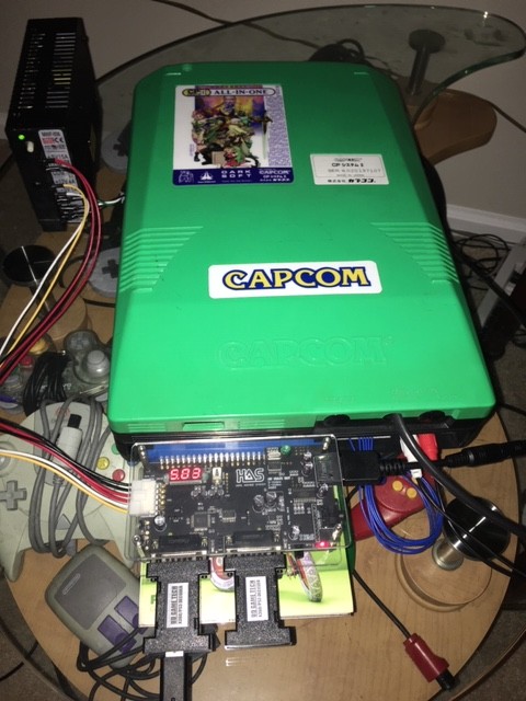

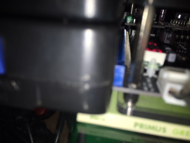

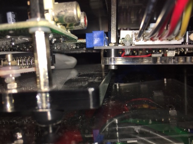

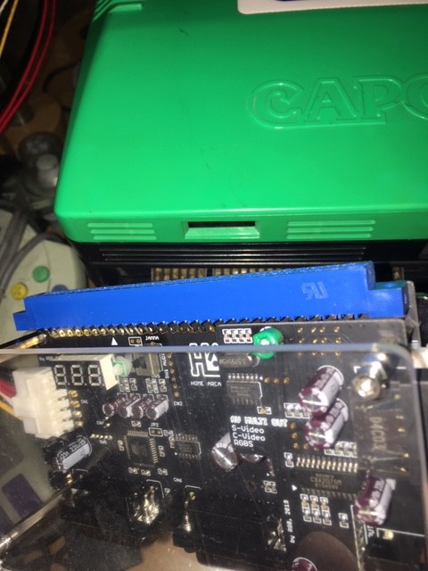

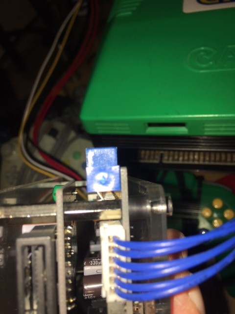

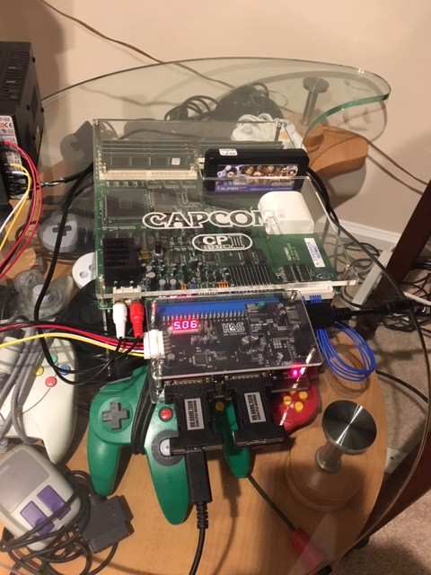

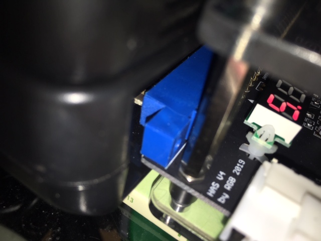

New HAS really does connect fully to stock cps2 and highflow.nl cps3 plexi.
I have to put a book under cps2 to raise it up and then a digipak cd case under the HAS, and for the cps3, I do nothing under the cps3 and a DVD/ps2 game under the HAS.
I’ll take pictures later.
Would it be nicer with a reliable JAMMA extender? Yes. But I don’t have to take the cases apart or anything
As I told you before, the only issue I've got with CPS2 is @twistedsymphony 's 3D printed LCD holder, if you aren't using that then you won't have a problem.
Likewise for the CPS3, the Highflow case is a copy of Jasen's case and yes I too can connect to this PCB without an extender.
I'm talking about MK1, System16, TMNT, System18, M72, CPS1... Yea... NONE of thos!
Also part of my issue might be I've got the HD15 HAT installed (so my case sits a little taller than a stock HAS).
However you slice it, I'm trying to be helpful here... If you intend on getting into plexi cases/3D printed LCD holders you really should get that extender.

Here’s my set up
