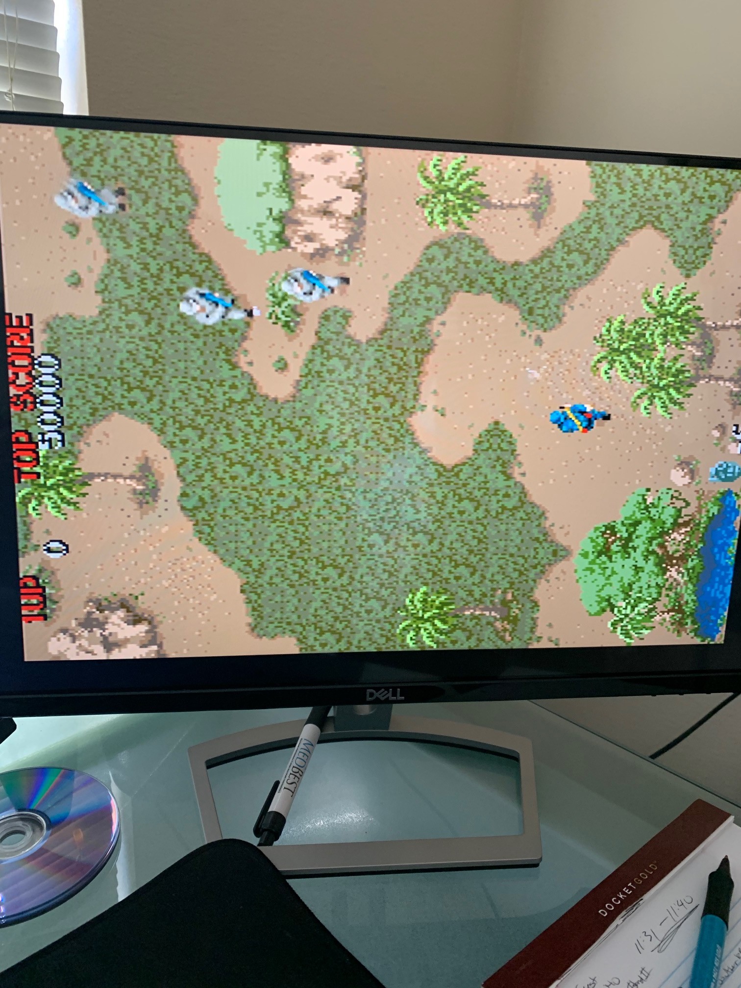

Finally got around to fixing the cable ...
Success! Now I've just got to finish the controller I was making!
