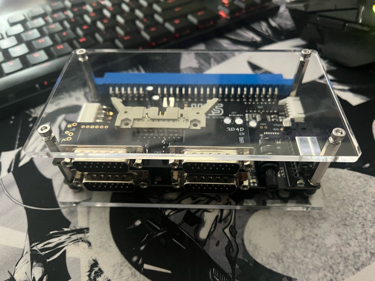

Hello everyone
I can now finally say i have my first HAS supergun (i know am late).
Thanks to the new store website it was super easy to order and came fast shipped to my doorstep in less than 2 days amazing.
I would highly recommend anyone looking for a quality supergun to check out this product/store if they are looking to get into the hobby.
Thank you guys i really appreciated all the hard work and innovations over the years. :)
