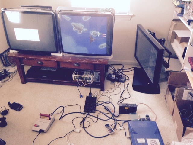

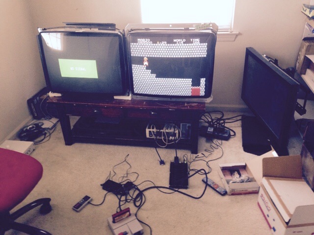

Testing - the HAS and D9200 & $220 gscart switch.. It works, I get great pictures but on my monitor the frequency buzzing sound gets very loud, I played with the jumper on the HAS no go. Played with the jumper on the scart switch and no go.. Maybe I would need a different scart cable?
I plugged in the NES and the frequency buzzing sound was present, changed the jumper on the scart switch to HV sync and the sound went away. The NES great picture.. For people with trisync arcade monitors maybe this is an option if you can not find a professional monitor..

Most times a buzzing on a switch is caused by the voltage line from the cable. You can try disconnecting it and see if it stops. I've seen some switches have that problem.
