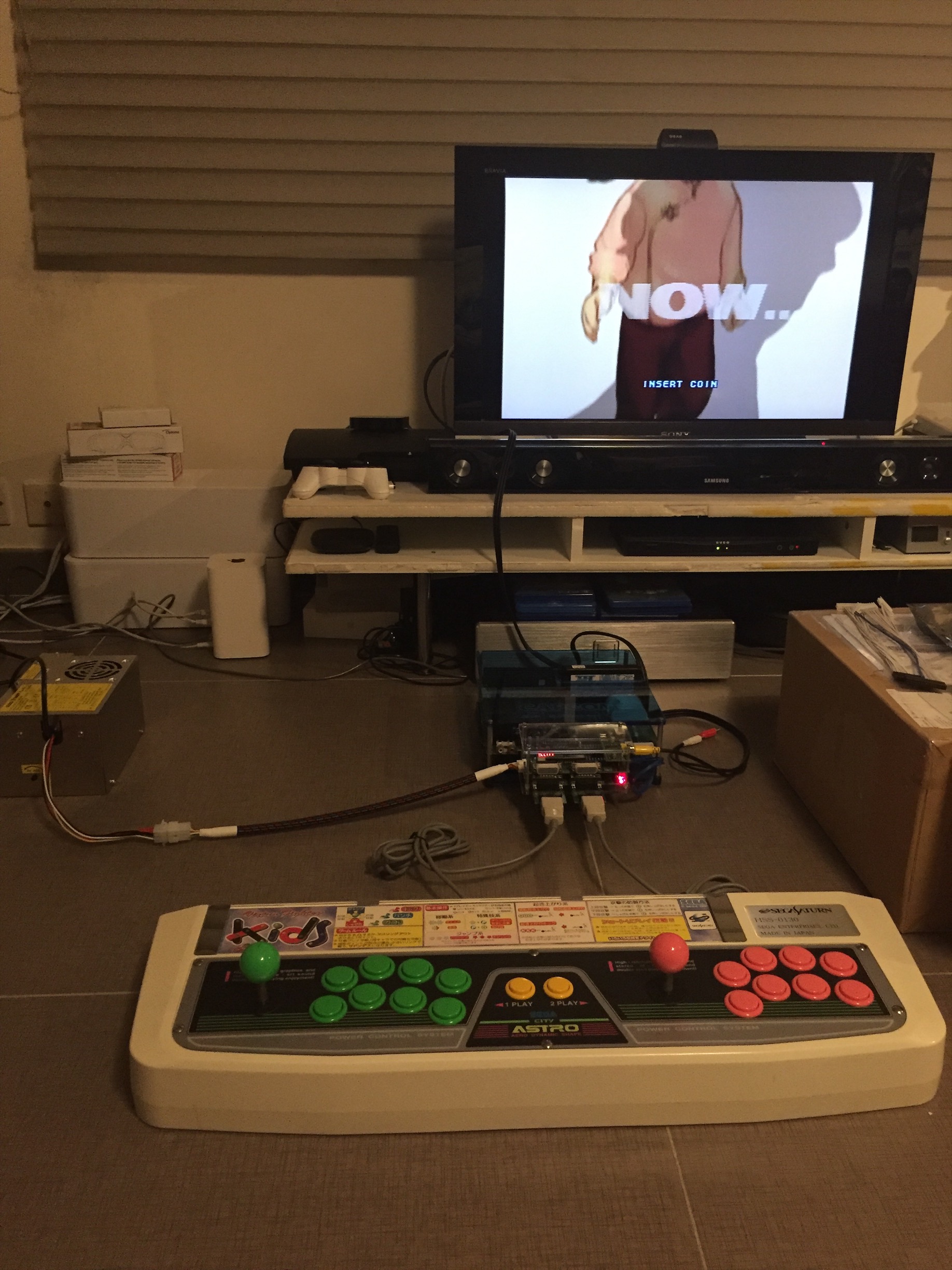

Finally have everything setup, the quality from composite video is really just like playing sfc on Tv, but my budget is so tight so framemeister is not an option yet.
And I need a Jamma extension harness too, because with 4 Saturn adapter and other add-on, the weight of it is too much for the Jamma connected that hanging in the air.
Still waiting another sega Saturn virtua stick pro to come, so I can try some 4p games.

And where can I get a nicely made Jamma harness?
And I choose that power supply because of Smokemonster :D
