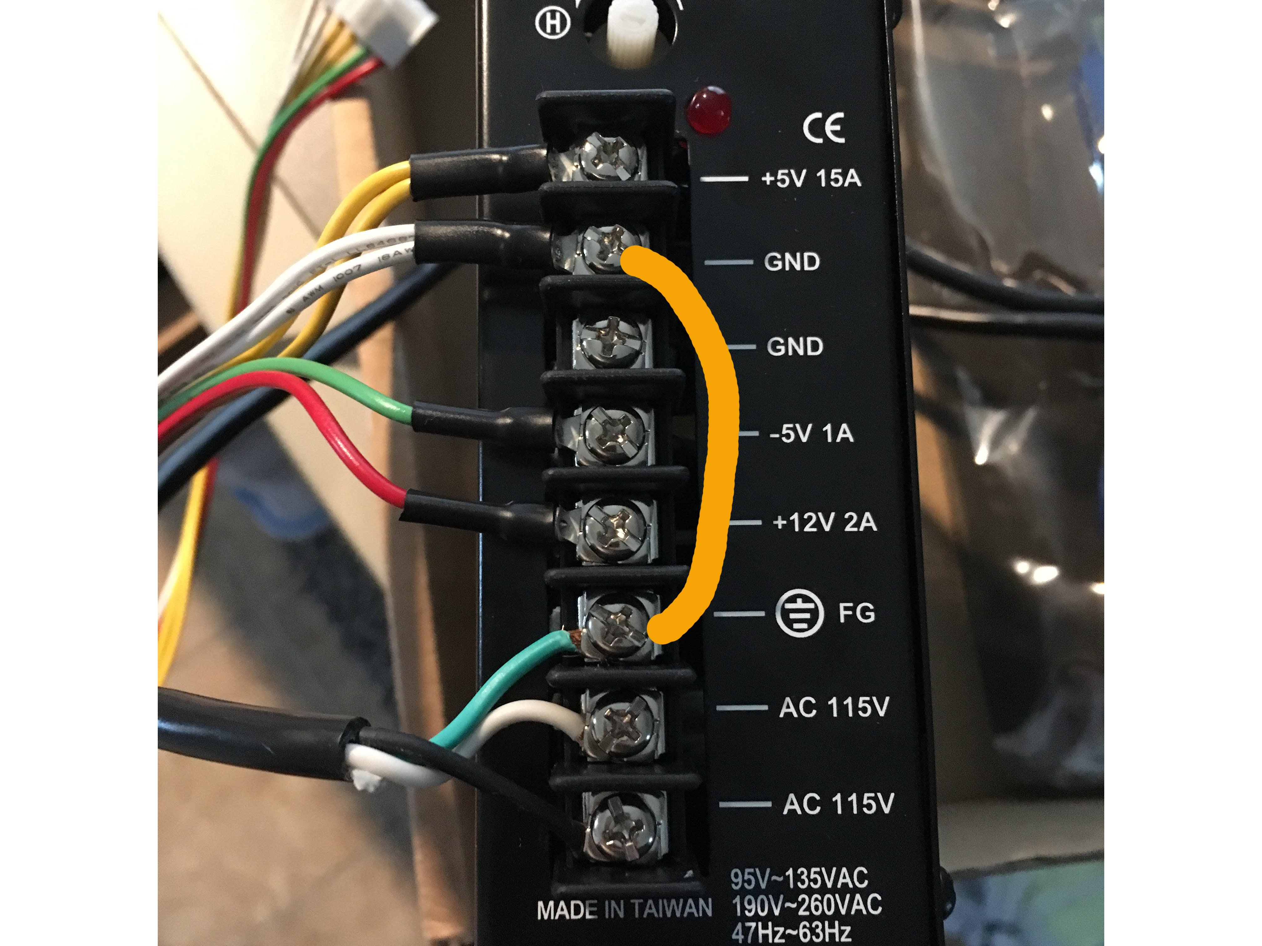

This can be remedied with an easy fix, at least in the case of the SUZO Happ Power Pro (see image below). Here's an excerpt from my recent troubleshooting post detailing the issue and fix:
Rolling Diagonal Video Interference
With the CPS2 side of the equation working as expected I was now going to tackle the slight video interference I noticed both when playing on my PVM and via OSSC. I double checked that my video and power lines were separated. I re-examined all of my PSU wiring. Eventually I hit Google and discovered a solution. Other arcade users had noted that the Suzo Happ PSUs (or at least the ones they had access too) didn't bridge Earth Ground and AC Ground within the case. Suspecting the same was true for mine, I crimped a new wire across the two ground points on my PSU and was delighted to see that it completely eliminated the interference I had witnessed. bridge_ground.jpg

It's a more complicated topic:
He talks about the oscilloscope, but the rules apply to all equipment really.
If bridging Earth Ground with COM works, that's fine, but you really need to understand what you are doing.
I checked the 5V rail on my scope by soldering an SMA connector to a jammafier (coax connection all the way..). The root of the issue was ripple on the 5V line, earthing stuff may fix it - but AC outlet power stuff is a bit above my pay-grade. The PSU in question that I used was properly earthed, and my apartments electrical system was rebuild from scratch in 2014, so i don't think that's the core of the issue. The problematic power showed a VPP ripple of 178mV (video looked terrible), my lab PSU in exact same setup had 33mV ripple.
Executive summary: it's was not 'interference'.

Now I don't expect people to have linear expensive lab supplies laying about, or solder coax connectors to their system and hook it up to oscilloscopes to trouble shoot video issues - but if you have video issues, it may be worth the trouble to check with a different supply.
