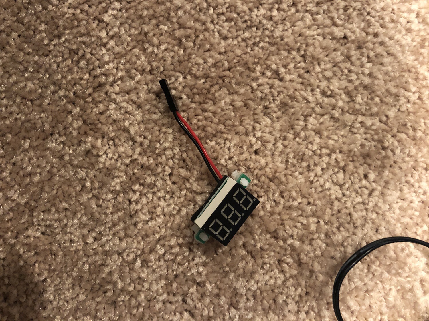

Ps. @RGB do you have extra Voltage guage, mines worked the first day I connect the HAS but then it stop working. @ekorz did some testing on it and its differently that piece but the HAS its self works perfectly (See picture)

About the voltmeter - I'll send you a new one.
Yeah my voltmeter went udders up on the second day, but my HAS has been working like a champ. It is ULTRA nice.
