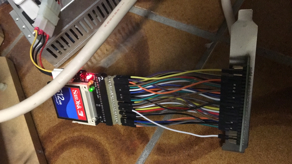

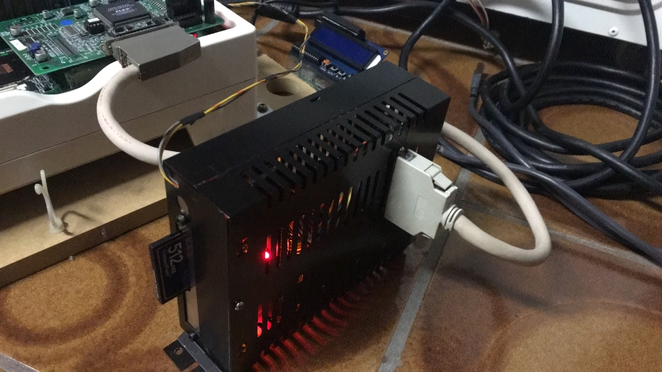

Hello So it runs the error was the CF adapter used have two more built the other work!
But unfortunately not with the Zero key from here have made one myself
the one on the last picture on the far left of the cf adapters is not working

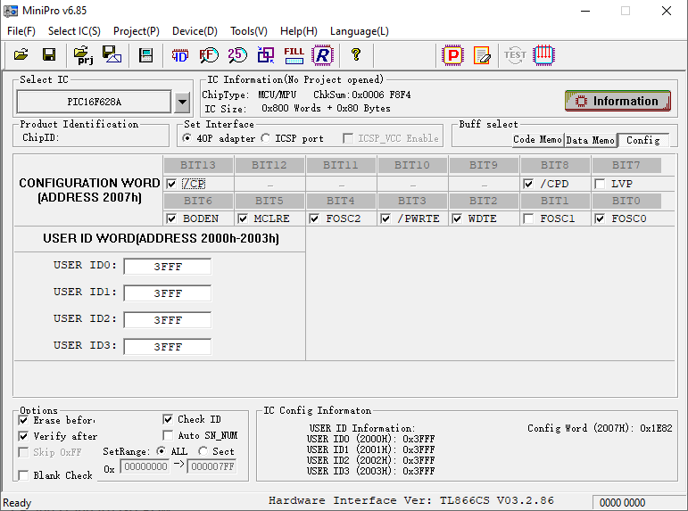

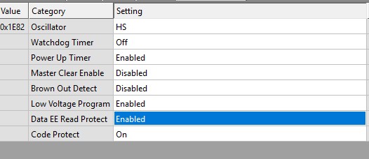

EDIT: I have tried to configure my programmer Minipro with the TL866. I only make 0x1E82 like this way of the image. With this key (flashing net file), I have Error 25 in GD-ROM mode and "Checking Network Please wait..." on netboot mode, but in this case it will never end showing this message. Ping doesn't work either.

My word configuration is right then? The problem is with my motherboard? The Error 25 in GDROM mode is correct, but the endless network checking pisses me off.
It looks correct but I do not own that programmer, maybe there are other people here with the same programmer as yours who can confirm that it works ?
Is the programmer asking for a BIN or HEX file? My Topmax 2 will not accept a bin. Kept burning bad chips. I had to convert it to a hex.
You know right that TL866 software tool has all the tick boxes inverted? At least the previous releases, I don't know the latest ones, I'm out of these things quite a bit. Just check this thing out.

Hi, I can confirm that making the Chihiro zero key with TL866 ad this configuration works with net and compact flash mode.

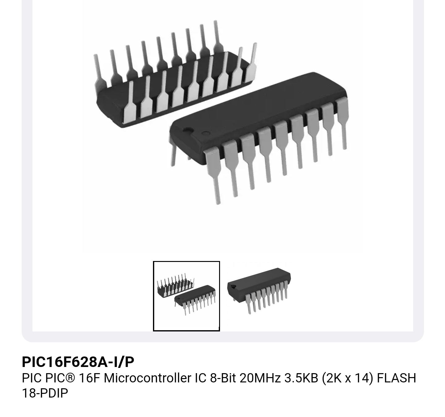

is this the right PIC to buy to program the zero key?
Thanks!
