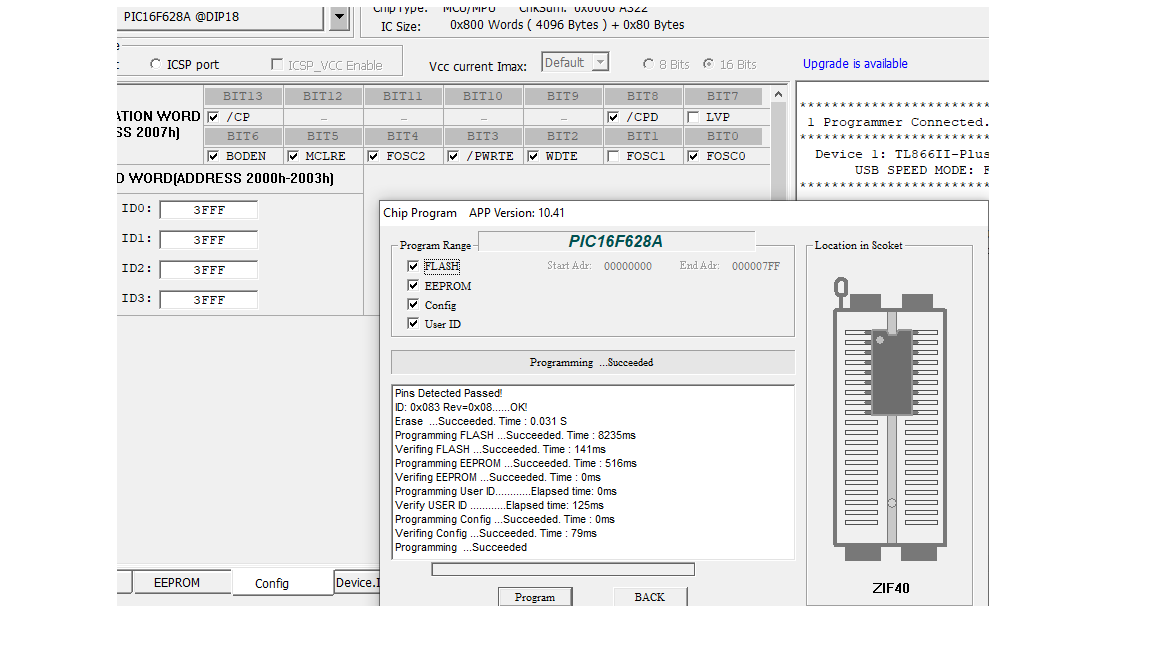

my zeropic killed itself again. Can anyone tell me how I can program it with the TL866 especially what to set in config in minipro v6.85.
I got it working last time but I forgot my settings -.-

First of all load the correct bin file, than select the config as rtw's image in the first post. You need to be sure that your config word is 0x1E82. You can see it in the IC Config Information. Than just flash and verify the device.
Thanks zeruel,
I used the settings you posted with the minipro program and it worked. Any idea why trying to netboot KOF11 kills my zerokey? It happened again.
