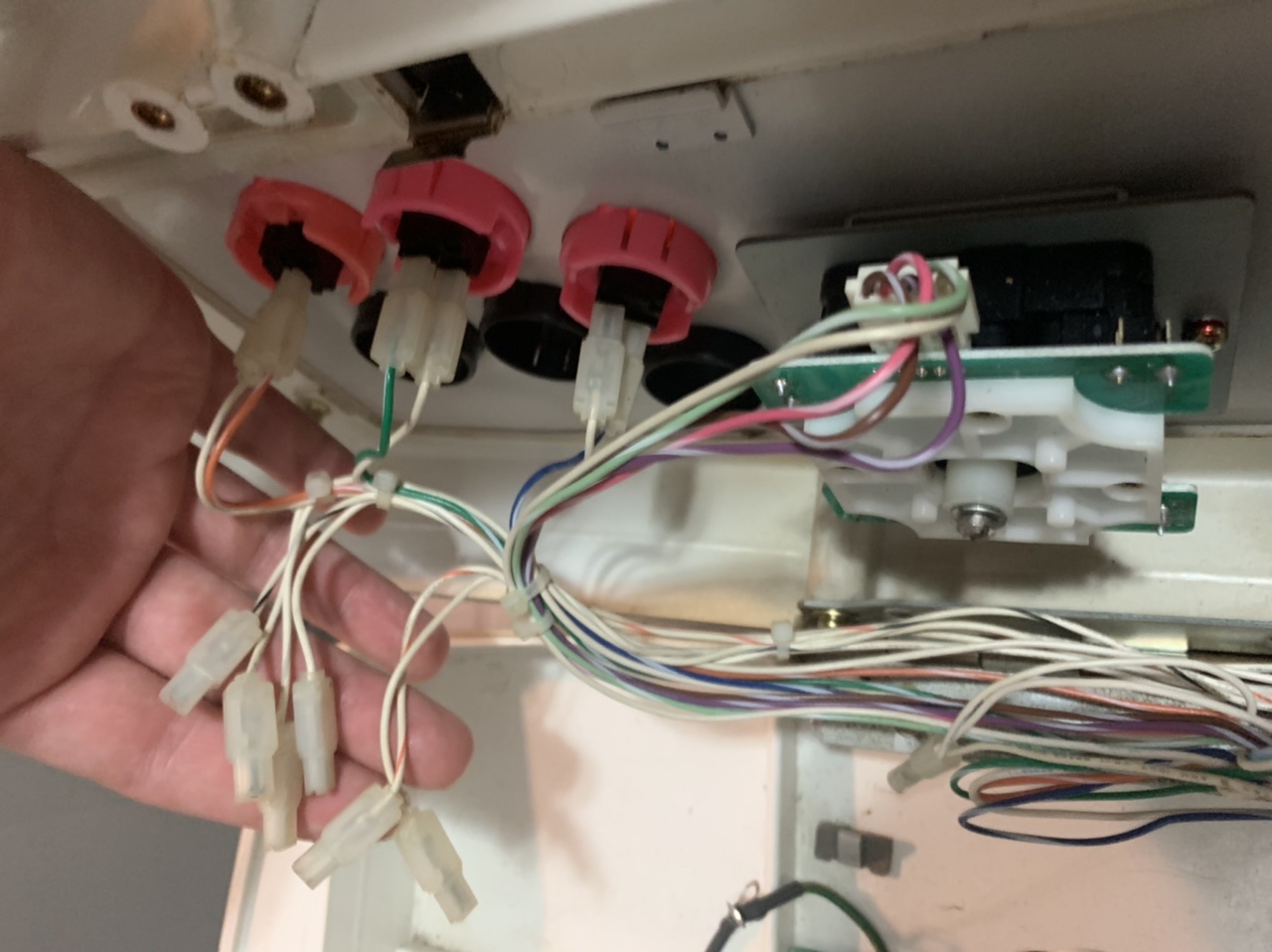

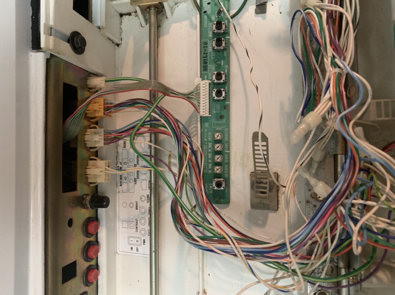

Okay so first thing I plan on doing is adding the kick harness. Under the CP there are 6 loose connections for 3 buttons per player. Do I follow those down to add the kick harness? Where specifically does the harness plug into? Also do I need a specific kick harness?

You should be using the connector in the blast's CP to run the kick harness.
Hopefully someone who owns one currently can chime in. Maybe @8bitforlife

theres a connector on the io board for kickharness. Cps2 to that blast connector on io board then on cp you need a kick for buttons
