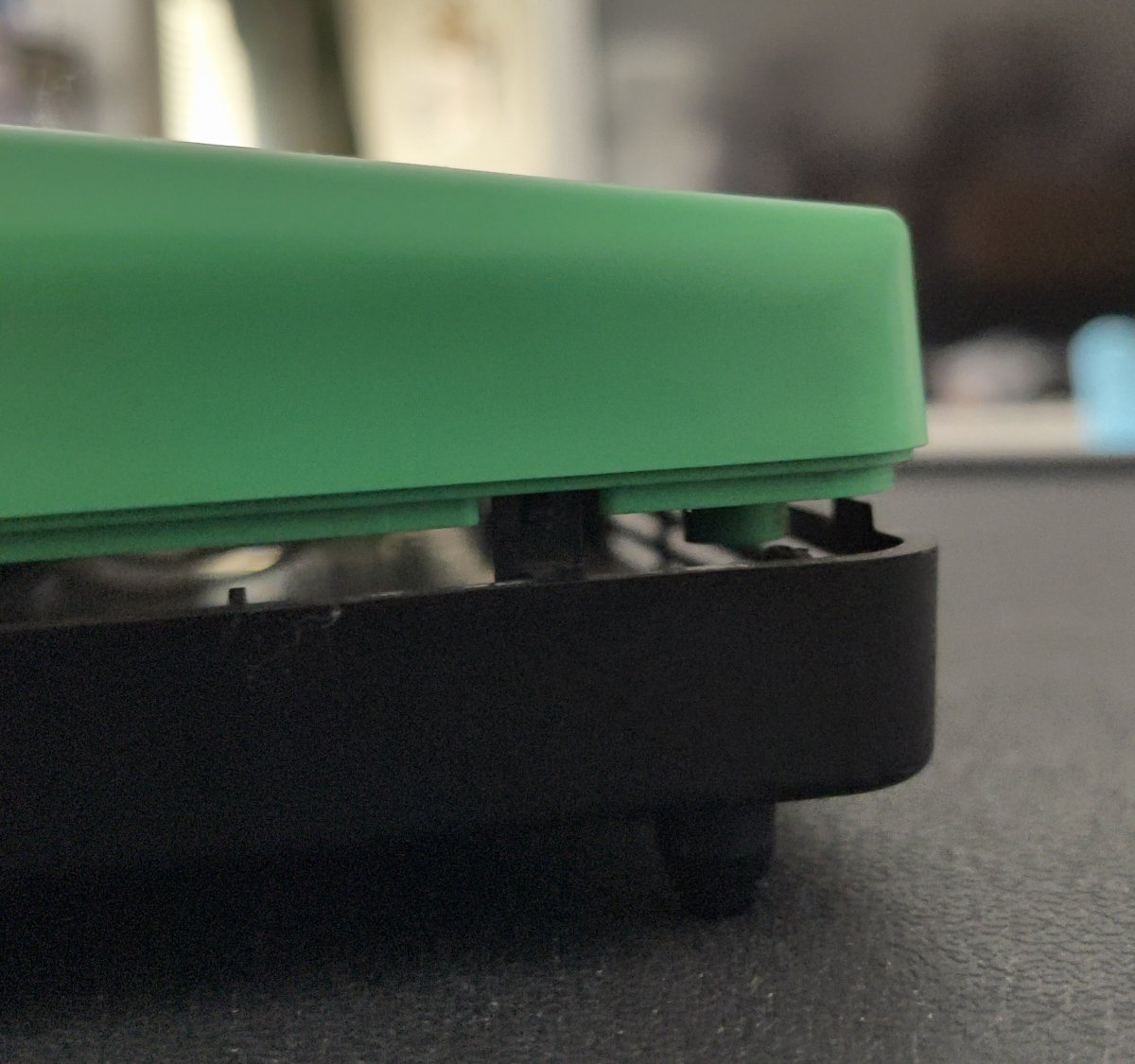

To open CPS2 B shells without snapping those plastic posts I normally gently warm first, either in a warm house or with a hair drier, nothing crazy like a heat gun! Then front edge against by belly, ease the back clips out first by pushing the black base in while wiggling the coloured top half of the shell up with my fingernails, once the back two are off its normally possible to jiggle the rest of the clips free carefully without any risk of damage.

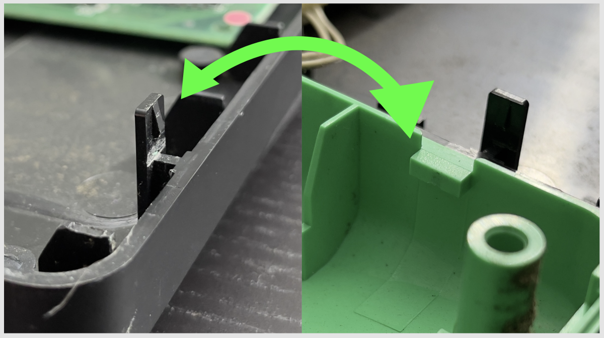

these hooks have a gap in the shell where they sit, I wonder if it is for a tool used to open these?

Hatmoose nailed it -- you need to push in on the black plastic right where the clips are, but it can be difficult to know exactly where they are.
