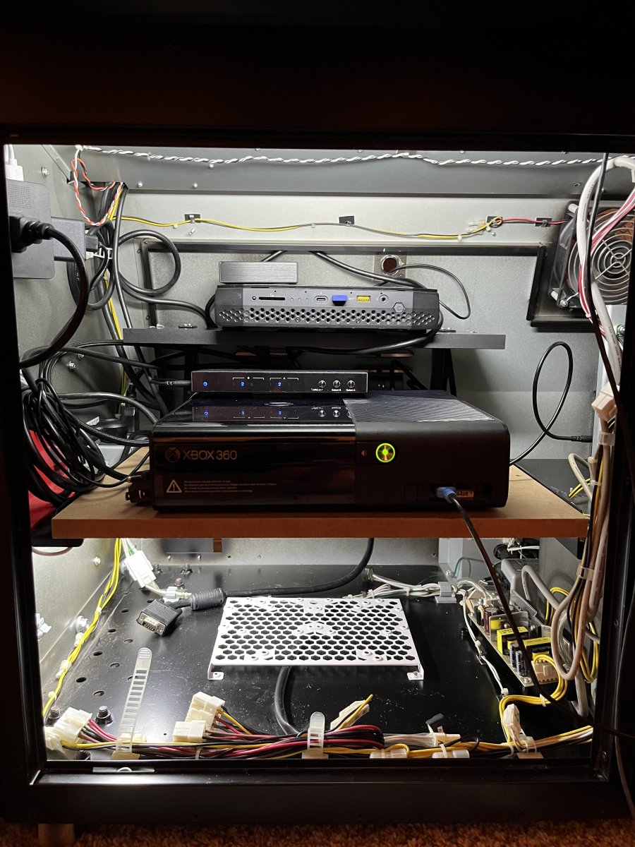

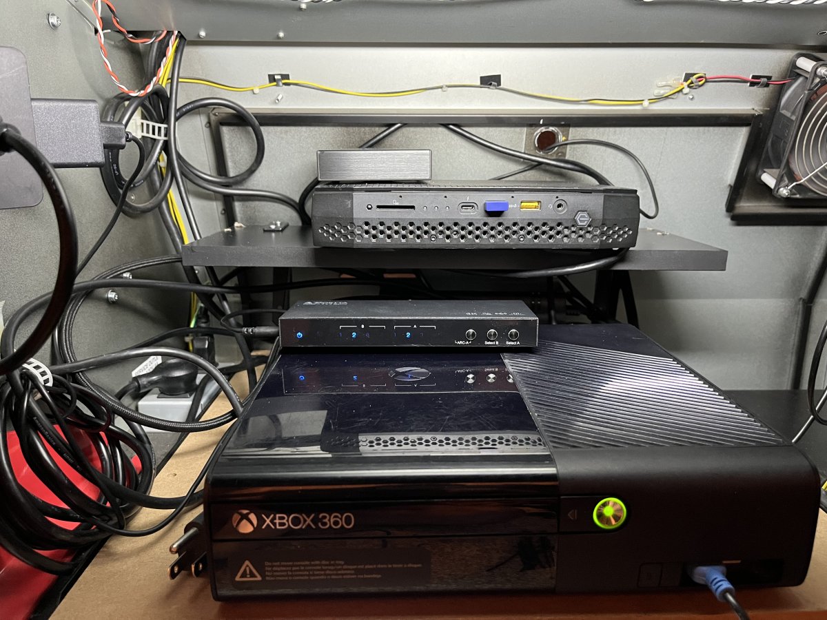

Rewired the cab for not only the Phantom Canyon but also the Xbox 360 E, and readied cables for the upcoming Namco 246 and Taito Type X3. Switcher mounted hidden on the top of the lower cab. Made a shelf and mounted the pc to that.

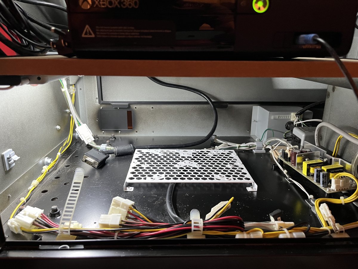

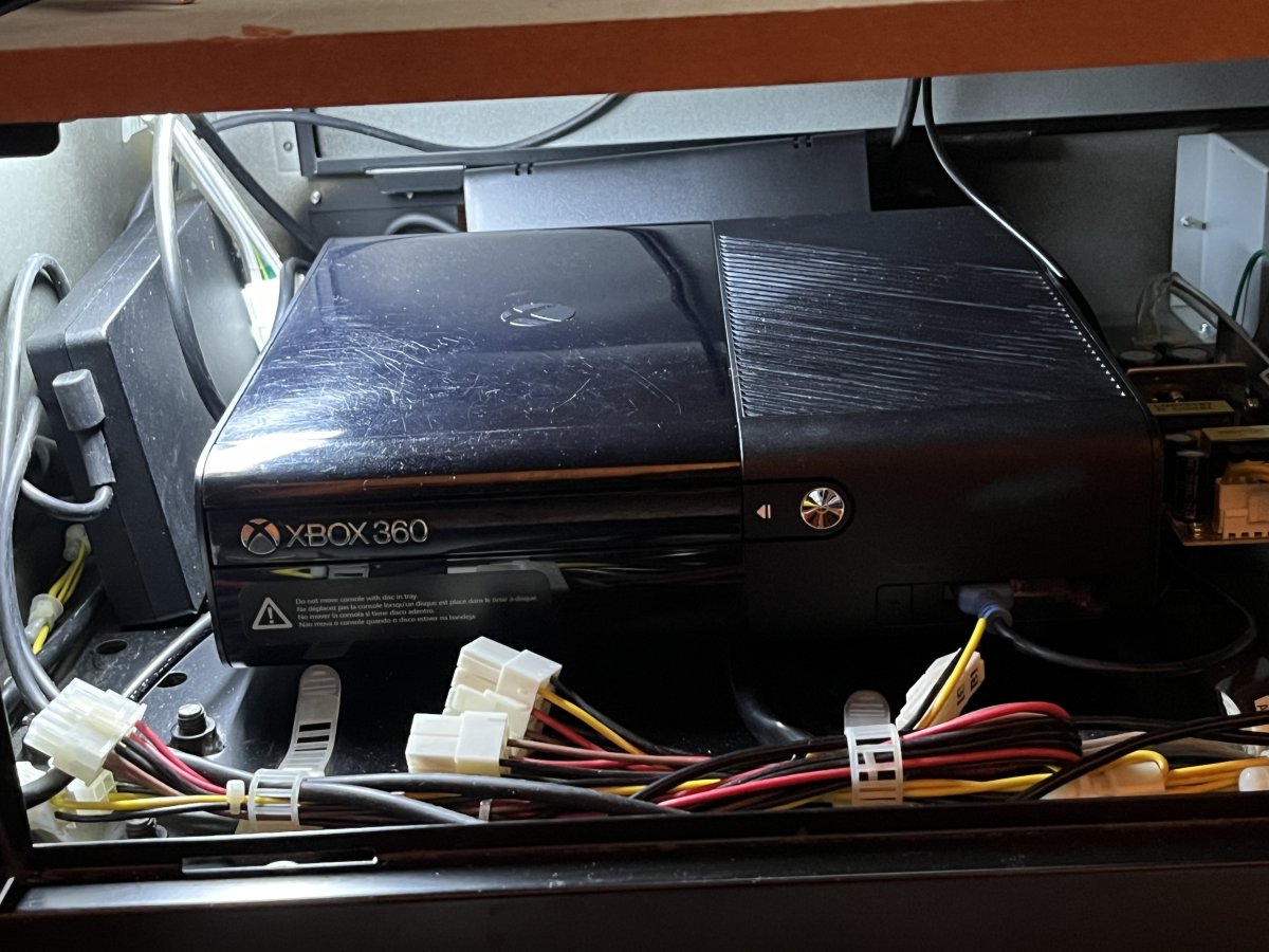

Gambling it should give me enough clearance for one arcade pc (Namco or Taito) beneath it. Xbox on a quarter inch tall metal rack so it clears the arcade wire loom that runs below it. So it lays flat and doesn’t rock on the loom anymore. Remote for switching video inputs and usb under the control panel, hidden away. All four pieces of hardware will be hooked up to it.

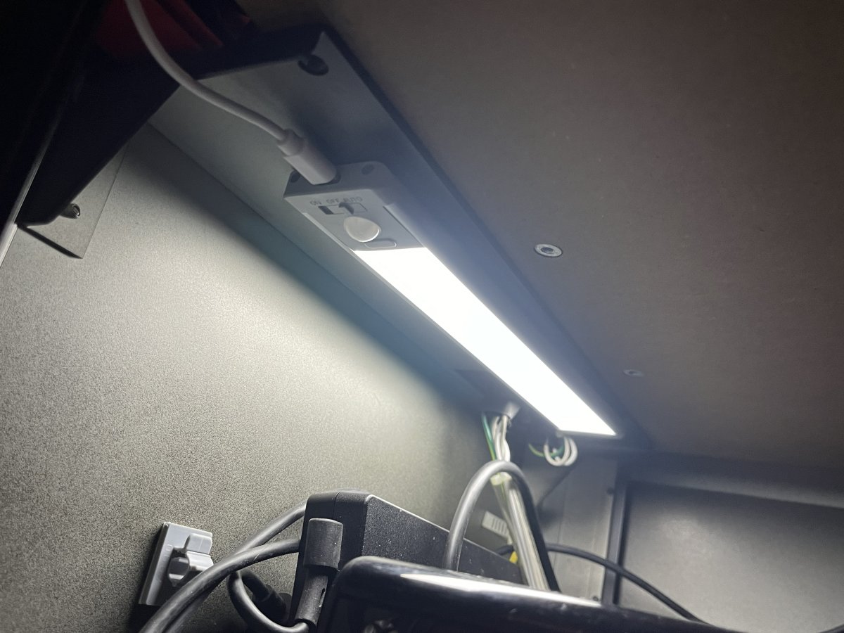

Hardwired led lights on top and bottom via usb to the power outlet on the left. Activates via motion. Mounted with built in magnets.

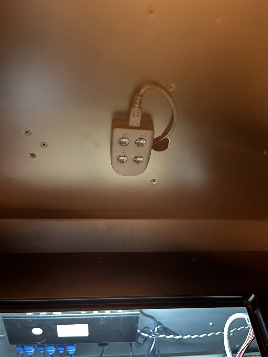

Wired input remote for the KVM mounted to underside of the control panel. If I want to switch video and usb connections I just hit a button for the corresponding hardware. And you can’t see it and it’s all tucked away nice.
I spent longer than I care to admit on this. But it’s super organized now and everything is tucked out of the way and ready for expansion. My back hurts but it’s been worth it!

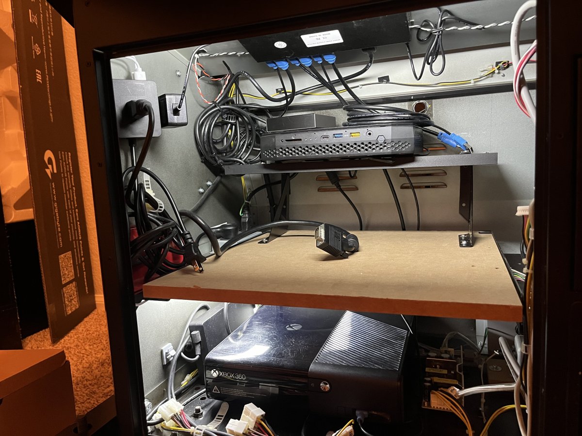

Previous switcher was junk :(. Switcher after that was also junk lol. (Can’t make this up)
Found one with proper hdcp support and…it worked! ……..on the Xbox 360 lol. Pc is a big goose egg. I officially give up.
I’m going to get hdmi extensions for each system and just manually plug in the system I want to play to the monitor cable in the main compartment and be done with this crap.
And of course I realized this after I did all my cable management …. Again. I figured it worked as it tested fine on the 360 initially. But then I realized I had audio issues as the expansion feature was trash. This made me nervous to try the pc and I couldn’t even get a picture lol. Going to just get the Xbox 3.5mm audio and run that directly to the amp and call it a day, with hdmi acting only as video (already confirmed it pushes out both signals at once).

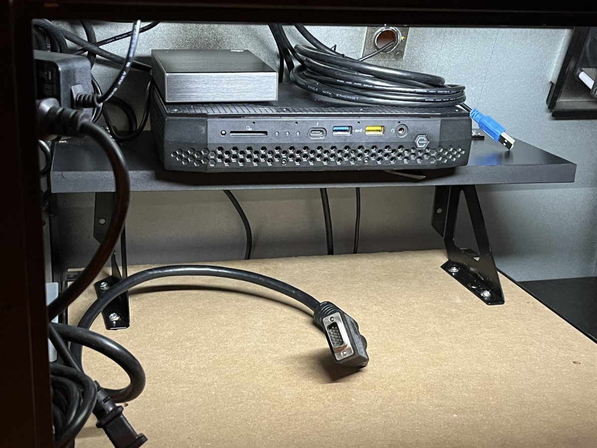

Mounted rack so that the X3 will lay flat despite cables running underneath.

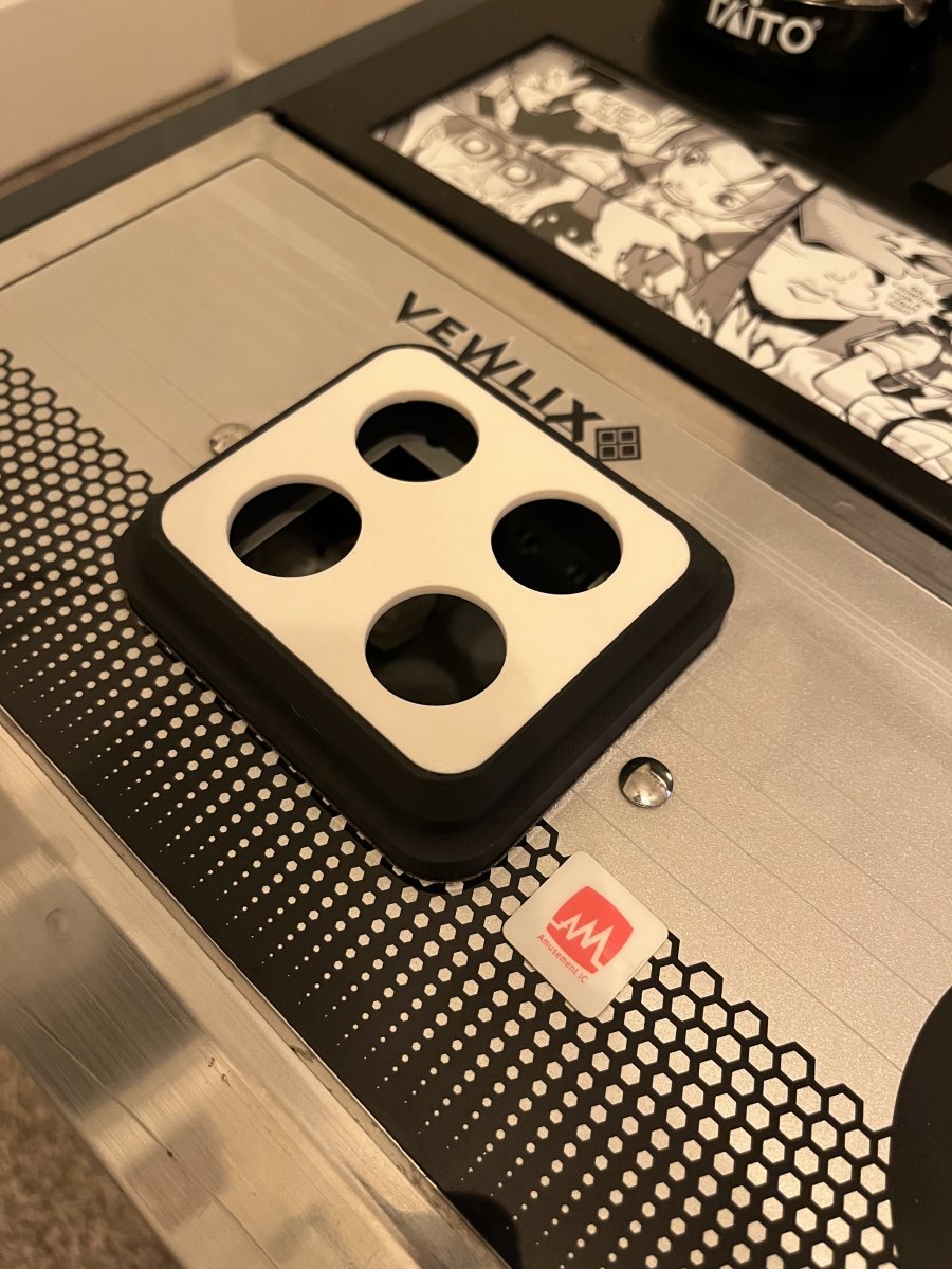

Dummy panels are forever safe. Four buttons to come!

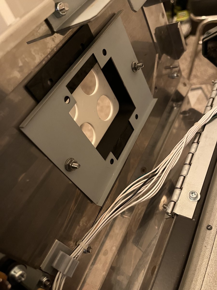

I've never seen the Banapass Vewlix panel. I'm interested to see if this will mount correctly. I designed it to completely replace the reader and mounting bracket in a Noir. If it ends up not working, let me know and I can probably make a new model.
Oh geez, I didnt even realize you didn't make it for a Vewlix. I'll double check when I get home to see if it remotely matches up.
Good news. While the screw hole mounts were extremely far off, the shape of the unit was the same. And thanks to the mounting plate pinching the enclosure to the control panel it honestly makes zero difference that the control board can’t be screwed down. There’s no wiggle or anything with this plate so I think it works just fine!
Can’t wait to install the buttons, now.
