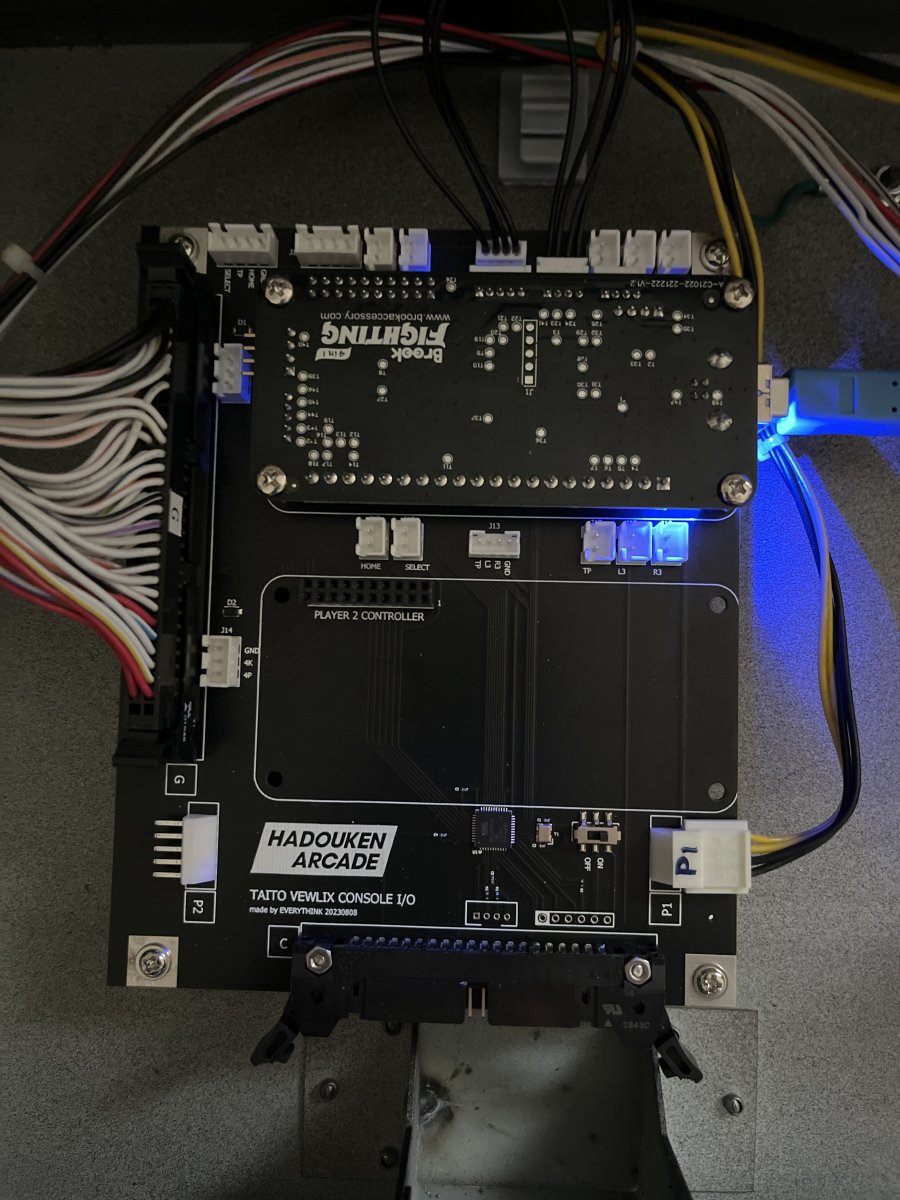

How is the latence by adding one more I/0 to the Brook ?As far as the custom io. This is how you hook it up. If you want home touchpad or other buttons you need his other harness which plugs into the top left port. He gave literally no instructions so don’t feel bad. Took some time for me to trial and error my way through it, too. I emailed him for some help, but his response didn't help me at all...
Basically, plug into the center port on the brook board and into the nearby port on the custom IO. Control board harness goes obviously on the left. I only have one player controls, but if you have two, you need another brook adapter and to do that all over again below. And then of course plug in the P1 harness on the bottom right. (if you have another player, plug in your other harness on the bottom left where it says P2)

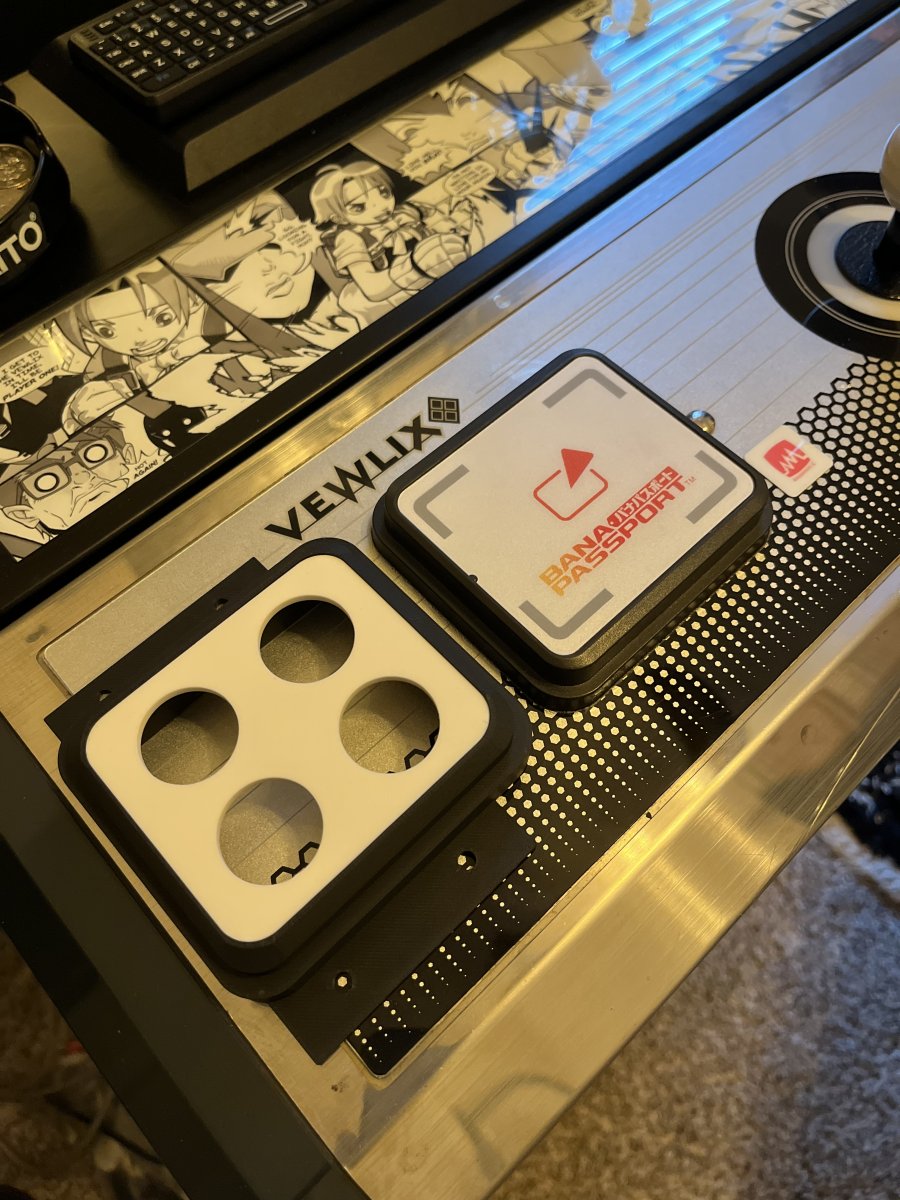

Good looking vewlix!![]()
Dummy panels are forever safe. Four buttons to come!

I didn't print that one specifically but it's my design and I do offer to print them.Good looking vewlix!
Question: where did you buy the 4 button custom banapassport mount? I am looking for one to buy or 3d printed for my namco noir 2. Thanks
