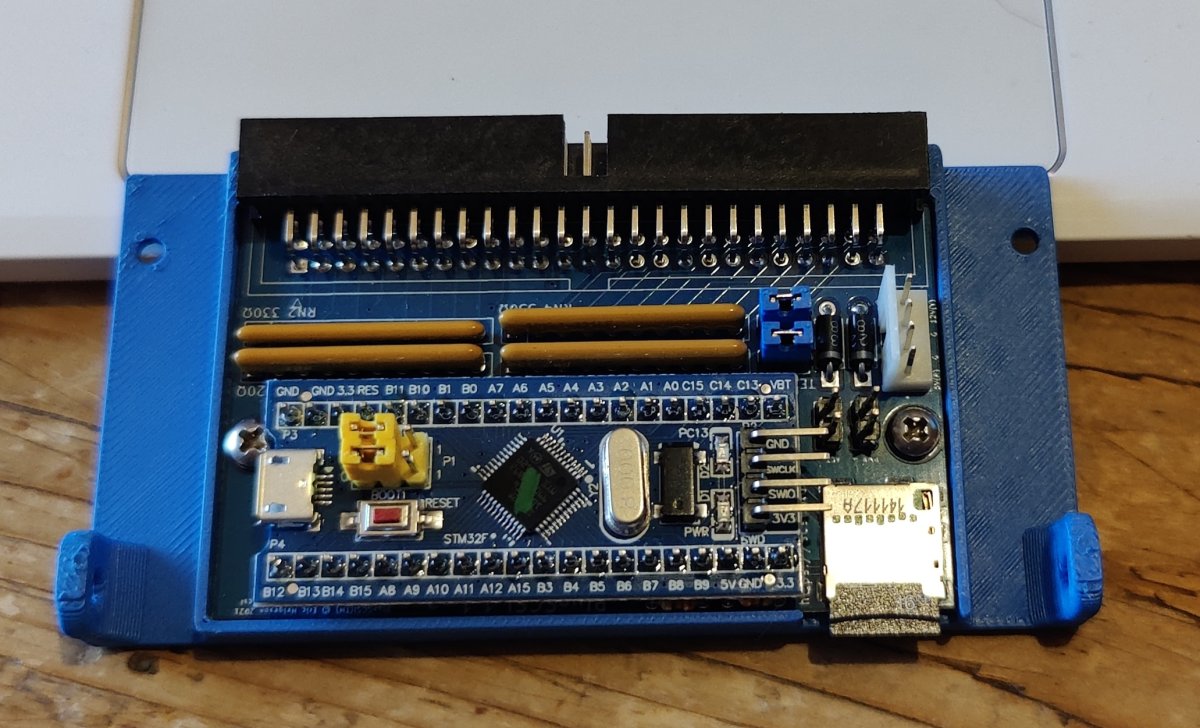

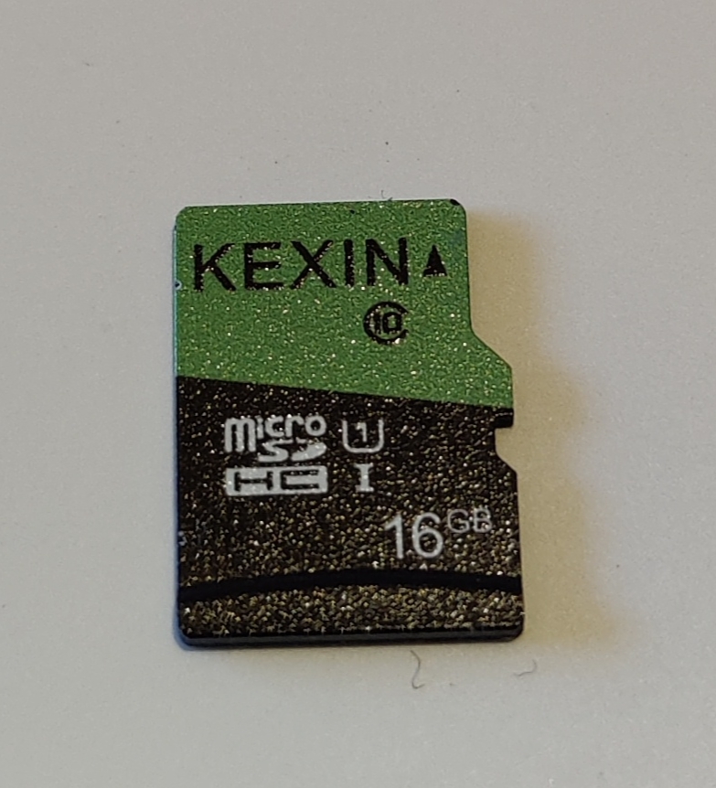

3- I wrote the ISO with HDD Raw Copy tool 1.10 on the SD I left the 4 jumpers in the position in which they arrived;
4- Connecting the reader to the Cps3 it gives me the following message, The CD-ROM Drive is not properly connected. Please turn the power off and correct it properly.
I put two photos, one of the SD card and one of the reader with the position of the jumpers, 2 on the upper yellow card and 2 on the lower blue card. I left the 4 jumpers in the position in which they arrived.

2- I renamed the ISO file from "UniCD-CPS3_for_standard_SH2_V4_Unmodified_MakotoFix.iso" to "CD10_2048-CPS3SH2CUSTOM.iso";
I think the problem may be at this step.
The "Standard SH2" chip is ONLY used on the Darksoft reproduction CPS3 security cart
The "Custom SH2" chip is used in all factory CPS3 security carts
Unless you are 100% sure that you have a reproduction security cart, or have modified your factory cart and removed the old chip you will be using a "SH2 custom" chip.
If that is the case I suggest you download and try this instead https://www.mediafire.com/file/1nnh...or_custom_SH2_V6_Unmodified_MakotoFix.7z/file

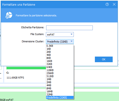

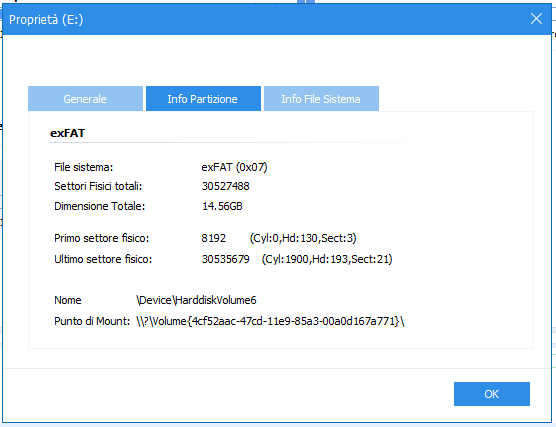

Not being very sure about this program, that after formatting, if I go to the properties it says: "File System: FAT32".
So I decided to try another program to format: "AOMEI Partition Assistant 9.15.0".
From the properties here I believe I'm sure I've done an exFAT.
But unfortunately by installing the ISO and carrying out the test, the response of the Cps3 does not change ;(
There are various sizes you can assign:
I tested the default 32KB and 2KB. But inexorably, the test was unsuccessful :dead:
