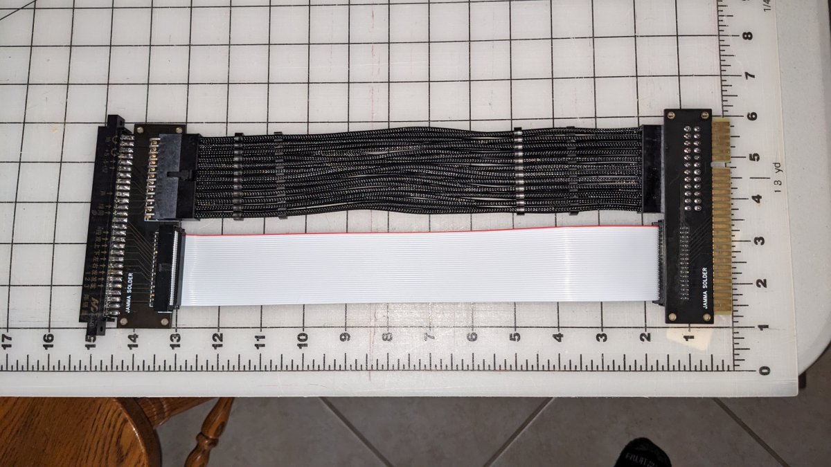

Ha! That thing - those Hirose pins are DF1B which you can read about hereJust wanted to say, your write up was great. After screwing up my first attempt soldering THS7374 a year ago I finally got around to trying this again but with the solder paste method and it worked out perfectly. One question I had was on the aliexpress x2.54 crimping tool you bought will that work on the hirose pins also? I'd like to give creating the kick harness a try.
https://www.hirose.com/product/docu...menttype=Catalog&lang=en&documentid=D31684_en
Hirose do make a specific crimp tool for those pins, which costs over $US700. So I've been using Harwin Z20-320 which is designed for M20 pins (and also costs moonbeams) and does a good job
