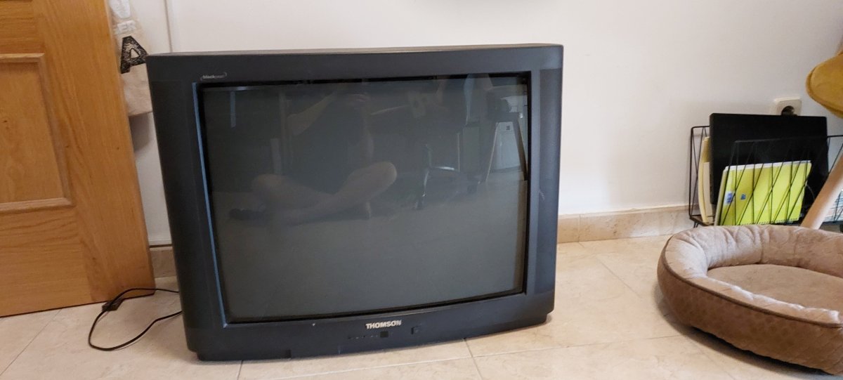

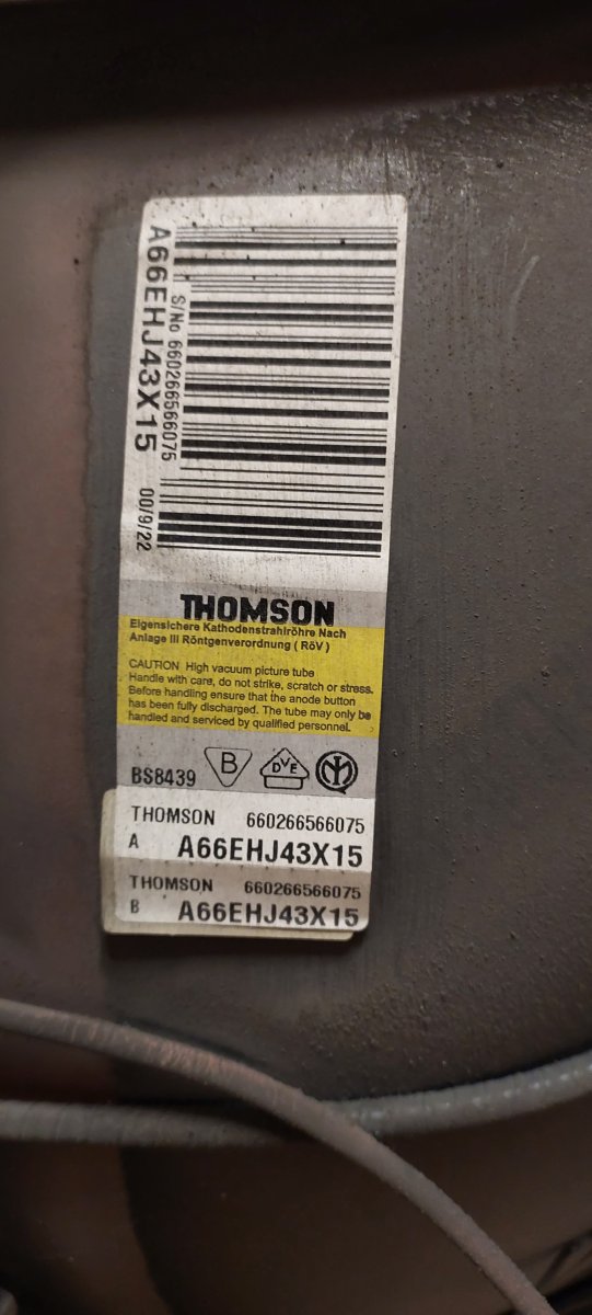

Hi there, I have a very burned tube inside an Astro and I was hoping maybe this one will fit. It's a THOMSON tube from a TV set with the same name. I just grabbed the TV for next to nothing thinking that it might be the right curvature. This set has excellent colors, and a very bright image, however I think the flyback might be damaged as the TV makes a "clank" kind sound every 20 seconds or so. When I opened it up to check on that I saw a little spark under the flyback everytime the sound is made. But I am very pleased with the overall image quality. I'll atach a few pics:
So, right now I'm wondering what to do as course of action:
- Replace / repair flyback and try to snug the tube and TV chassis on the cab
- Try to do a tube swap and get geometry and convergence as good as possible.
Any tips from experienced enthusiasts that might help me out in here?
A66 is 28" Japanese. 26" is A63.
But yes, it's too small.
Another issue is that has a single magnetized yoke ring, which you would need to hack off for a Nanao tube swap. It could work as is with a Hantarex Polo chassis though.
Thank you nem. I'll try to fit it into the cab and just use the TV chassis. I just can't live with that burned monitor no more. I'll also give the flyback a look see if I can atleast stop the spark until I get a replacement. Will post results during the weekend.

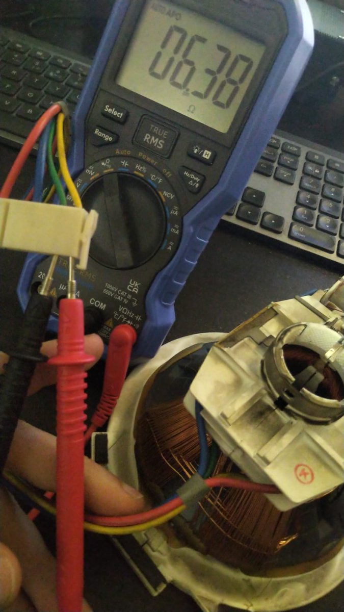

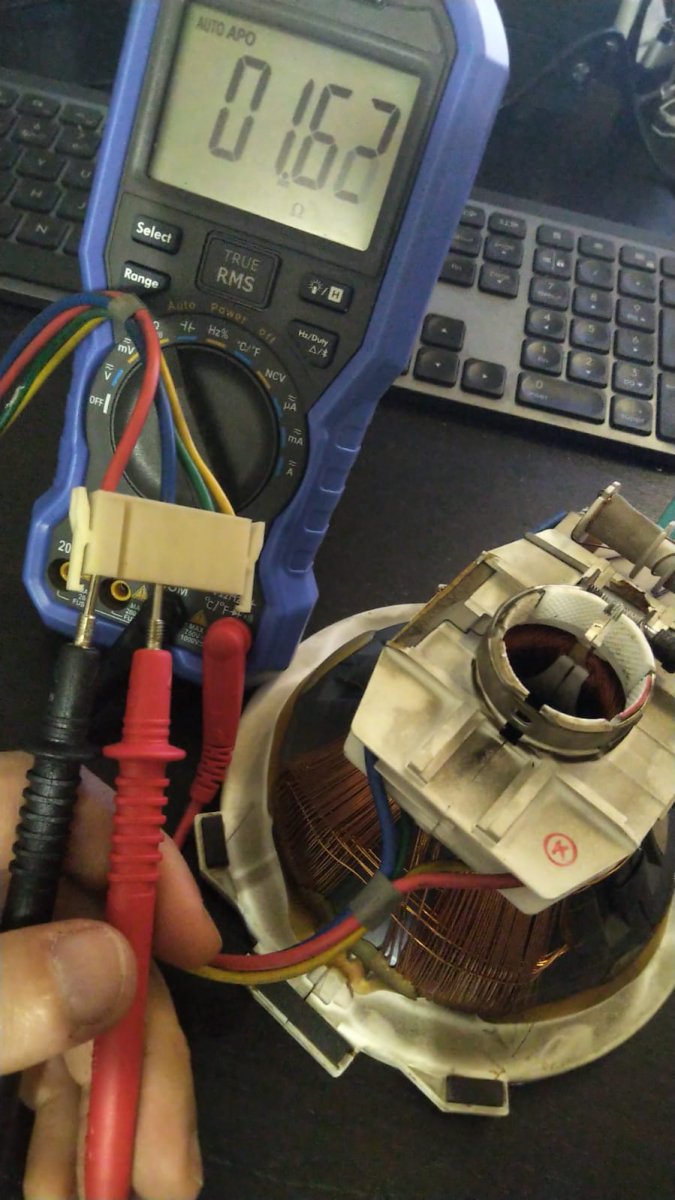

Hello again. I've measured the resistance on the yoke, it's 9.6 and 1.6 ohms. I can get a hold of a Polo 1 chassis and also a Polo 2 110°. Do you think any of those can fit this tube? Or at least be sure the chassis wont blow? Thanks for helping a newbie out.
1.6 ohm horizontal and 9.6 ohm vertical will work with a Polo 1.

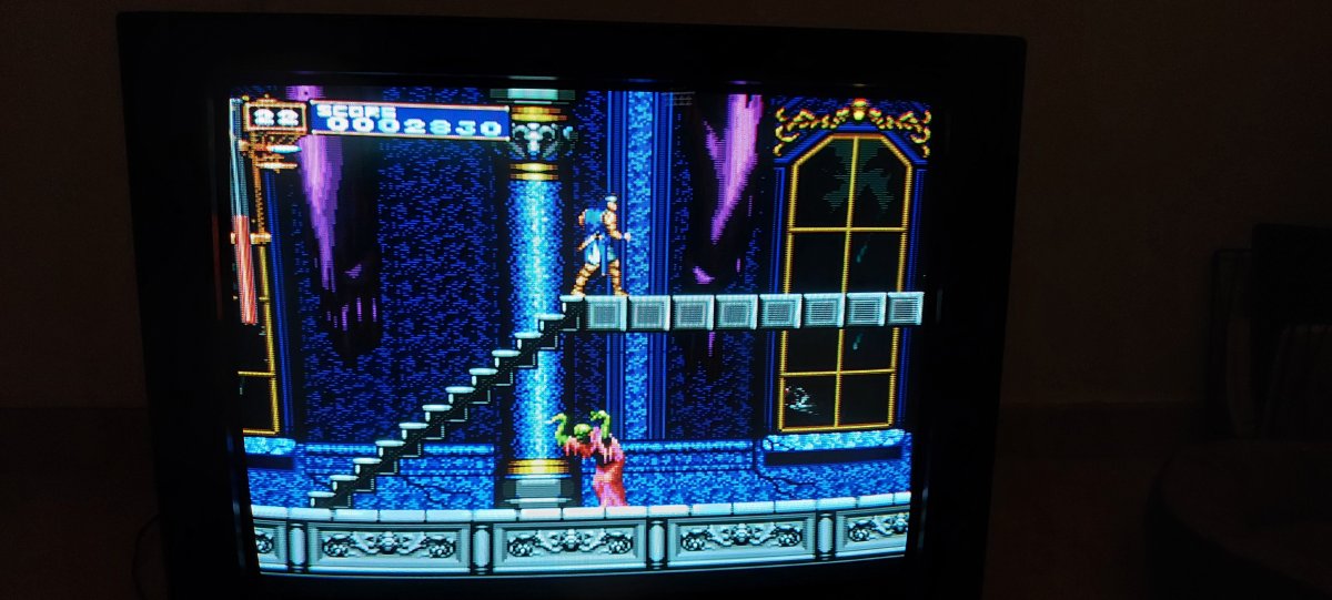

Hey all, not sure if this would be the right thread but it seemed like a good thread to ask if I need to swap some parts on my extra astro city monitor. I think it’s a MS9.
The tube quality is great, however, it’s dominated by a blue hue. I happen to have two astro cabs and when swapping the the control units and adjusting the RGB values with the knobs, there was no change. I assume given this was from overseas perhaps it got damaged as before the machine was sent, it was working flawlessly. Any ideas or suggestions? I’m also thinking of just selling if anyone is interested, feel free to DM. Thanks! Video below.

You're missing red but should definitely turn down blue a bit.

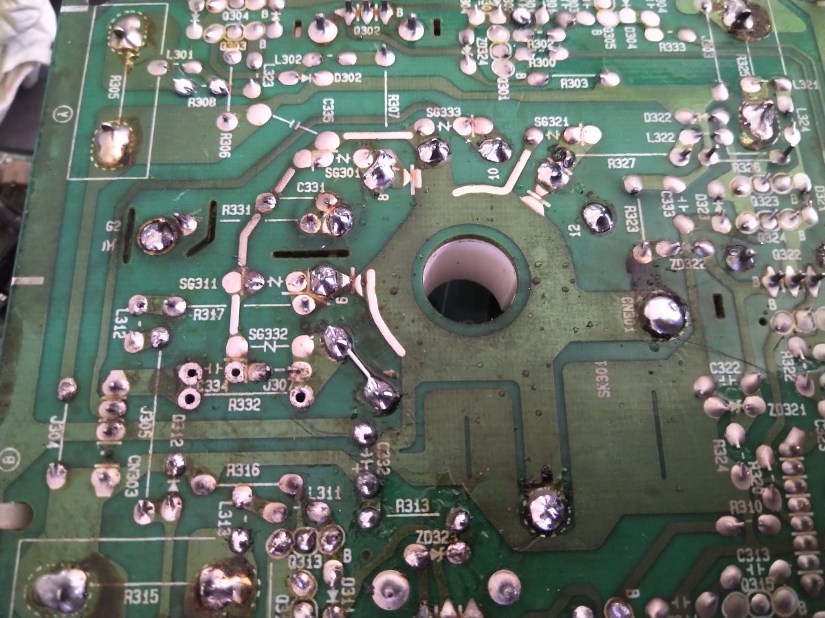

Yeah, but it’s not something I can fix from the controls unit, I think the board itself needs re/soldering or repair maybe cause nothing I’ve been able to try has brought red back.
Right now I’m not selling the astro cab itself but will sell this monitor with the caveat it will need repairs. If you’re interested, DM me!

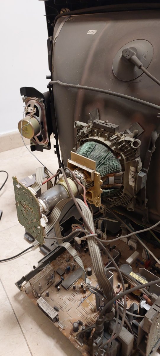

Hi again. So I managed to fit nicely the Thomson tube in the Astro cage. I paired it with a Hantarex Polo as @nem suggested and the image is quite good. I played ghost and goblins for around half an hour and it felt great, but when I switched game on mister this happened:
It's similar behavior as what the old flyback was causing in the TV, but way more severe now. The hantarex flyback is brand new and the chassis has been recapped. I cleaned the socket pins and greased the anode in case it has been moisture or something. I haven't made any adjustments yet. I also noticed later a slight screen oscillation in the menu:
I have no idea of what could be causing this behavior. Any help would be appreciated 😀

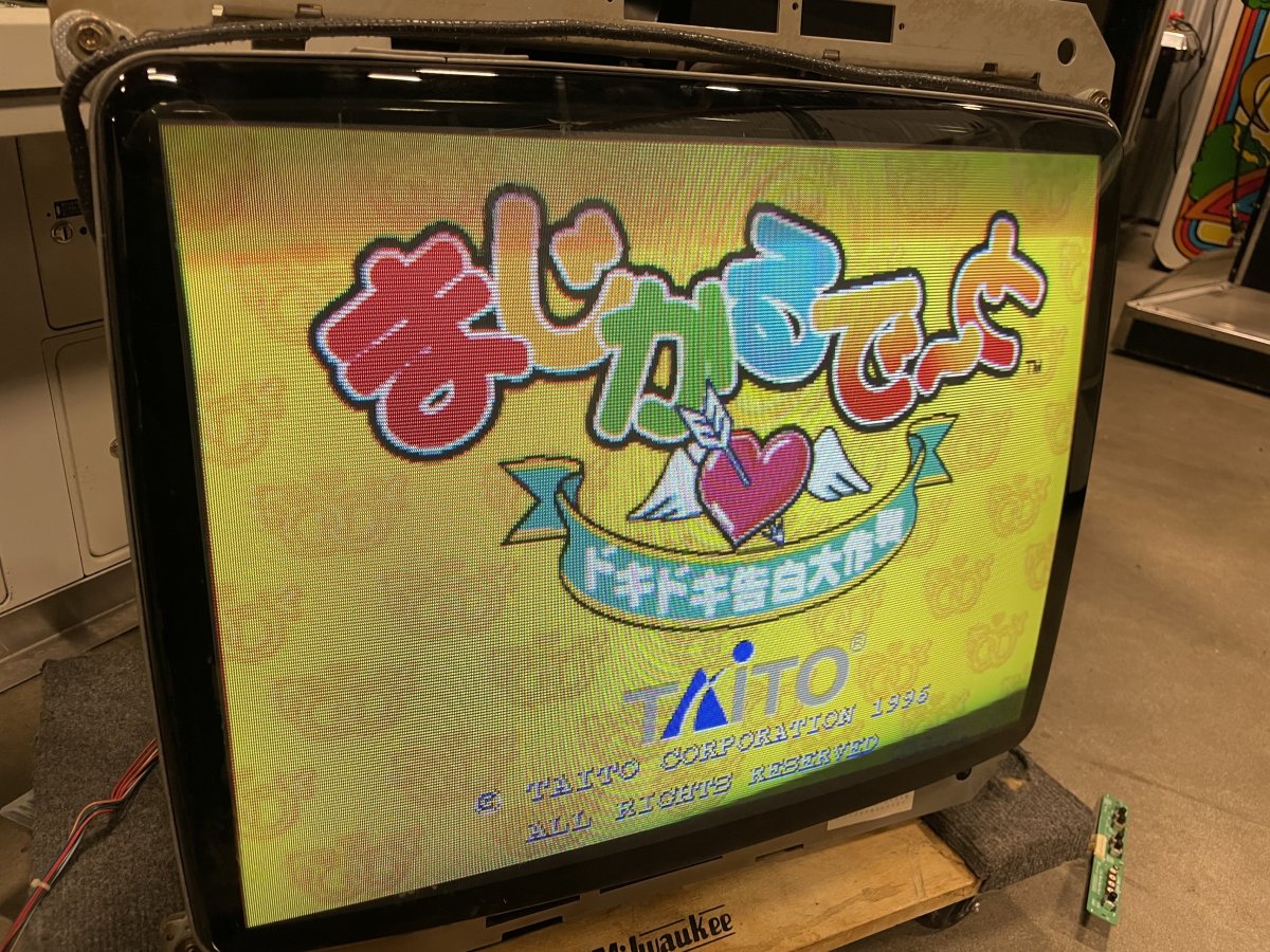

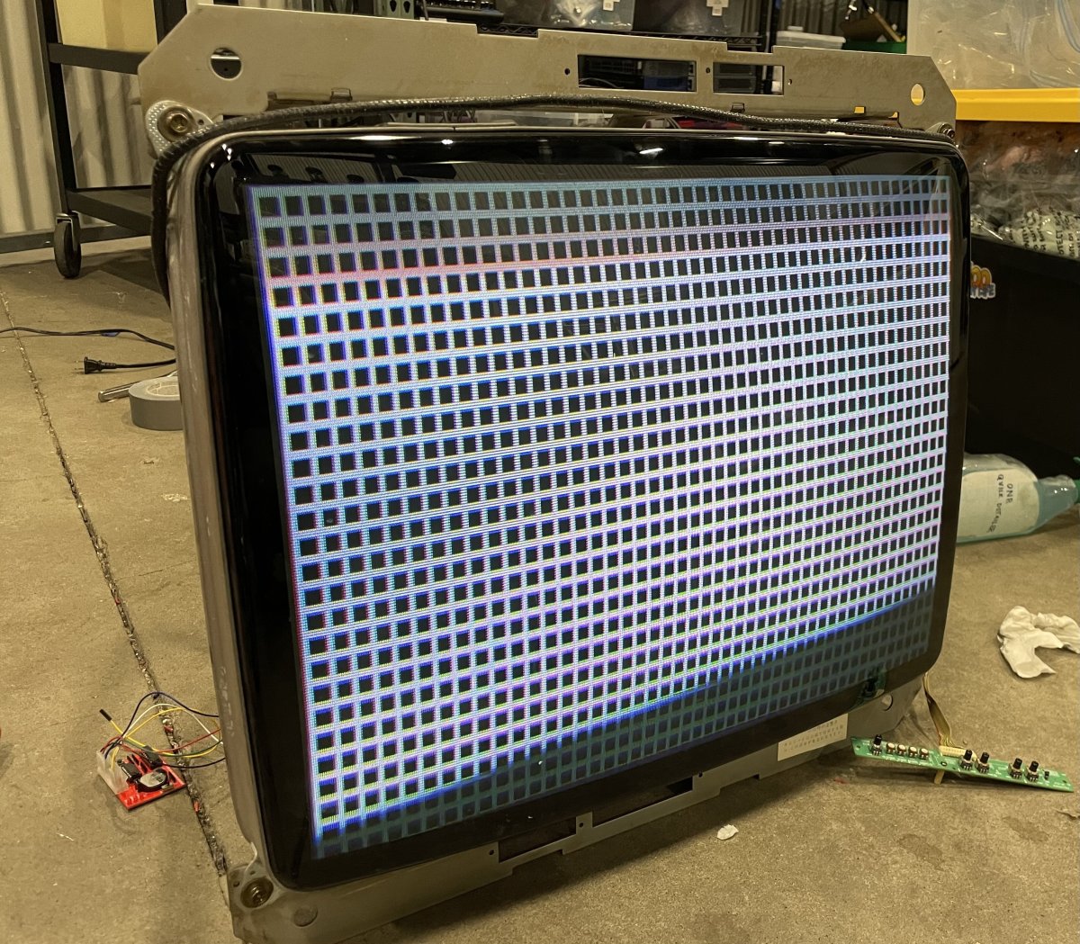

Had a successful tube swap today on a sad filthy MS9-29S from one of our fleet cabs I'm refurbishing, which came with horrible mahjong burn. The new tube is a Samsung A68KVL74X from a Korean "Ducksan" monitor we were given that caught on fire. Looks like the tube was also used in some Mitsubishi, Sanyo, and JVC TVs along with some Kortek monitors, so it should be easy to find.
Setup was extremely tedious. The rubber yoke spacers had to be removed and the yoke repositioned *exactly* in order to achieve good purity and convergence. I mean exactly--no tolerance for error. Once I got the yoke in the correct position, I tightened the clamp and pushed the rubber wedges in place and held everything firm. Shut it off and glued everything in place with hot glue to tack things down, and turned it back on to ensure the picture was still where I wanted it. I did this probably 4 or 5 times before I got a good result! I then used some blobs of construction adhesive to permanently secure the yoke and wedges.
Anyway, purity on all solid colors is perfect with no chevron magnets, but there is a slight dirty screen effect on a pure white screen. Focus is good, convergence is overall acceptable. I didn't have any strips on me today so I'm sure it could be improved with some more effort. Massive improvement over the dim and burnt original tube either way.
Someone recently told me there were "no known MS9 tube swaps" so figured I'd post in case it helps someone.

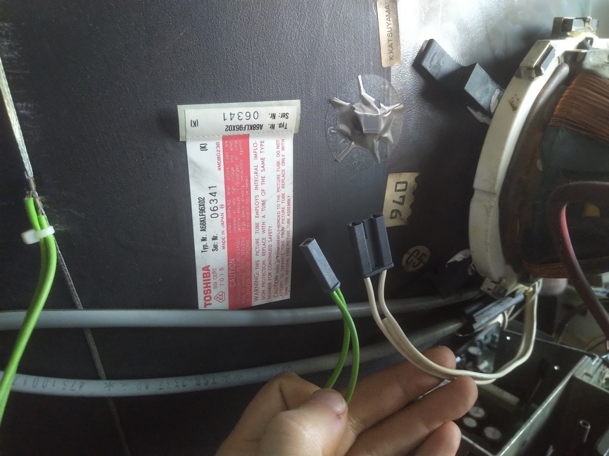

So thanks to iori's awesome post I could find a Toshiba 2927DF TV here in France, and I can happily confirm that yes, the TV's A68KLF96X tube is a perfect fit for an Astro City ! :thumbsup:
Sharing a few non-problematic details first :
- The tube's original yoke resistance measurements confirm that it has to be replaced with an MS8/9 yoke indeed.
- Ground and degauss naturally require connector adaptations

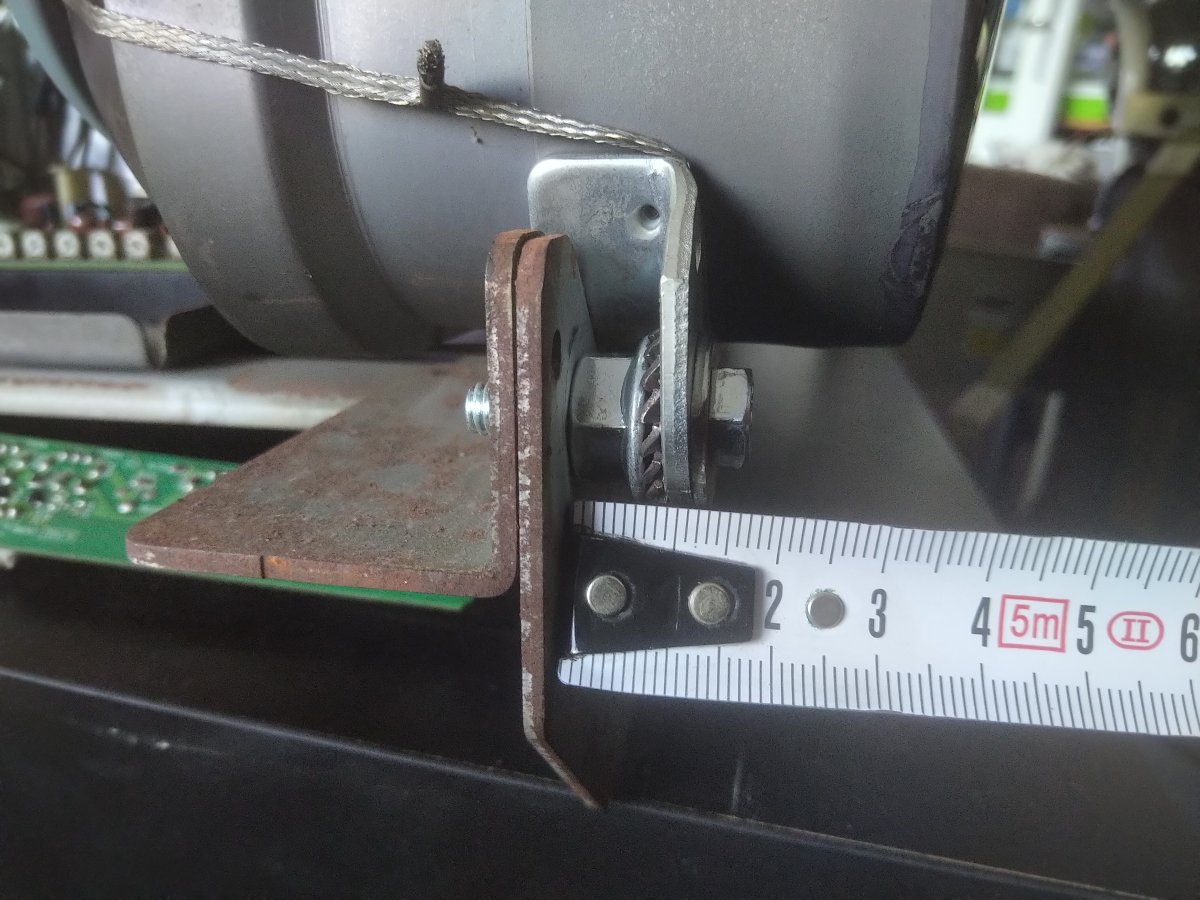

- Frame assembly requires depth adaptation (around 1 centimeter forward)

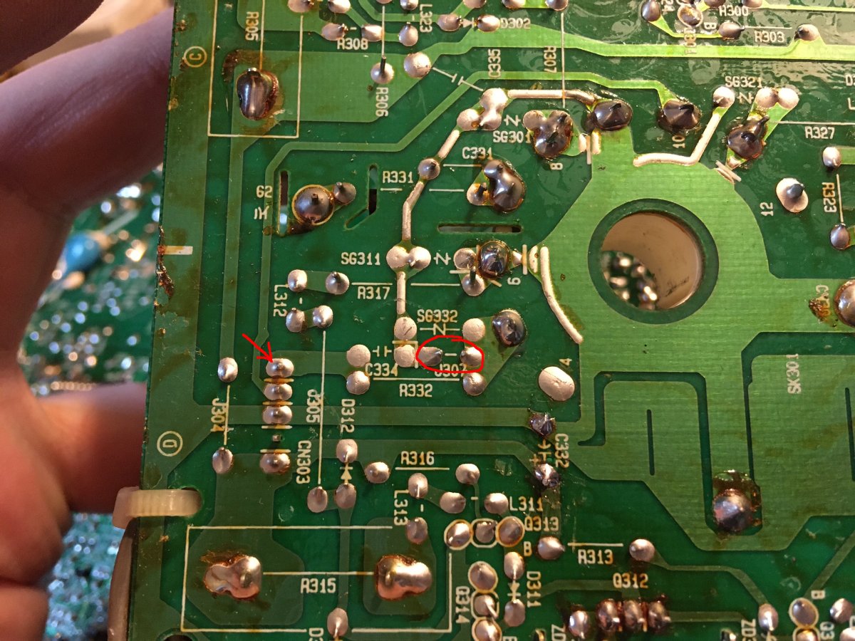

Then compared neckboards between MS9 (left) and TV (right) :
(ignore red indications, image shamelessly stolen from Mike's awesome MS9 guide :D)
- The MS9 ignores the tube's pin 4 : the neckboard's socket doesn't even have a female pin 4 populated.
- Meanwhile, the TV directly links pin 4 to pin 5 (G1) with a jumper.
That's how I suspected this difference to be a potential cause of arcing, and I connected pin 4 to pin 5 on the MS9's neckboard, without really understanding why such a difference in tube pinout.
Please note I also replaced the socket with the one coming from the TV in order to have female pin 4 populated.
The playlist's last video shows that it seems to work indeed : no arcing noise anymore, woohoo !
