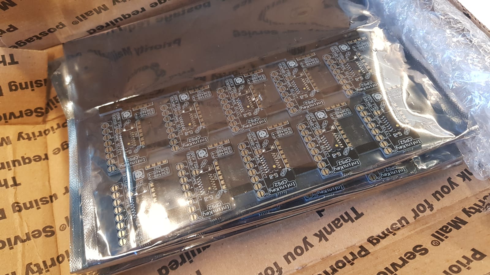

InfiniKey-CPS2
Our stock arrived today, will be shipping our existing orders tomorrow :D

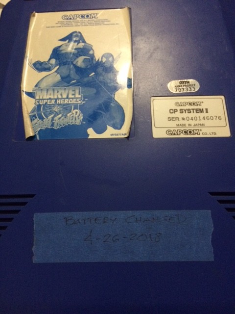

Alrighty bud, one last question. Us responsible CPS2 B-board owners have swapped out our batteries and added labels with the surgery dates to let us know when we have to do this again in the future. We don't need to do that anymore. But how about an official undamned CPS2 Infinikey logo we can print out and slap on the boards so that it can be known that this board doesn't need to be troubled with again?

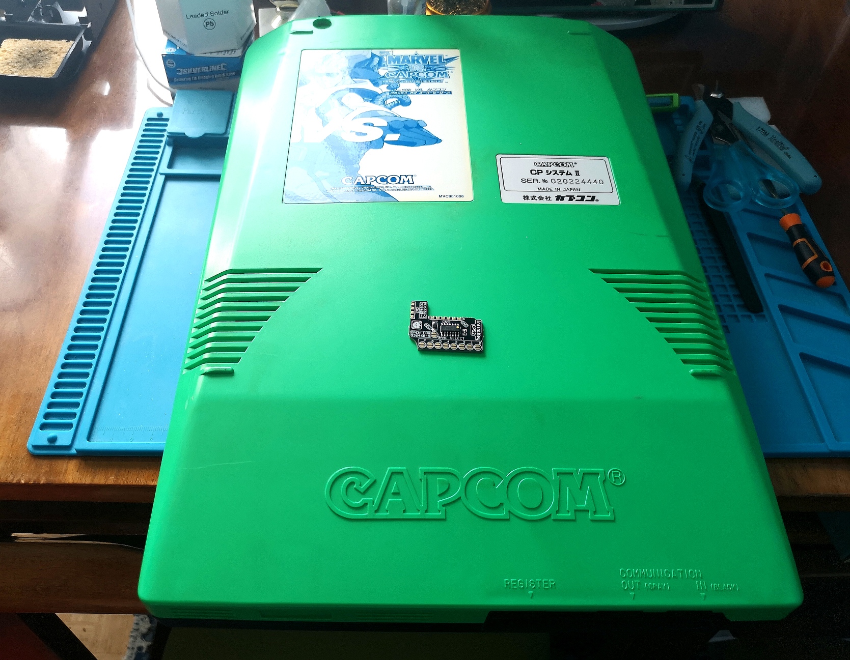

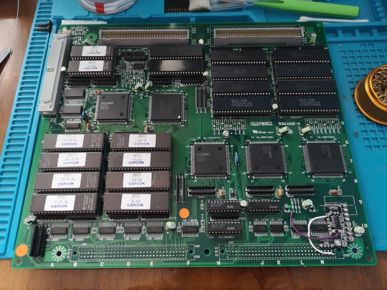

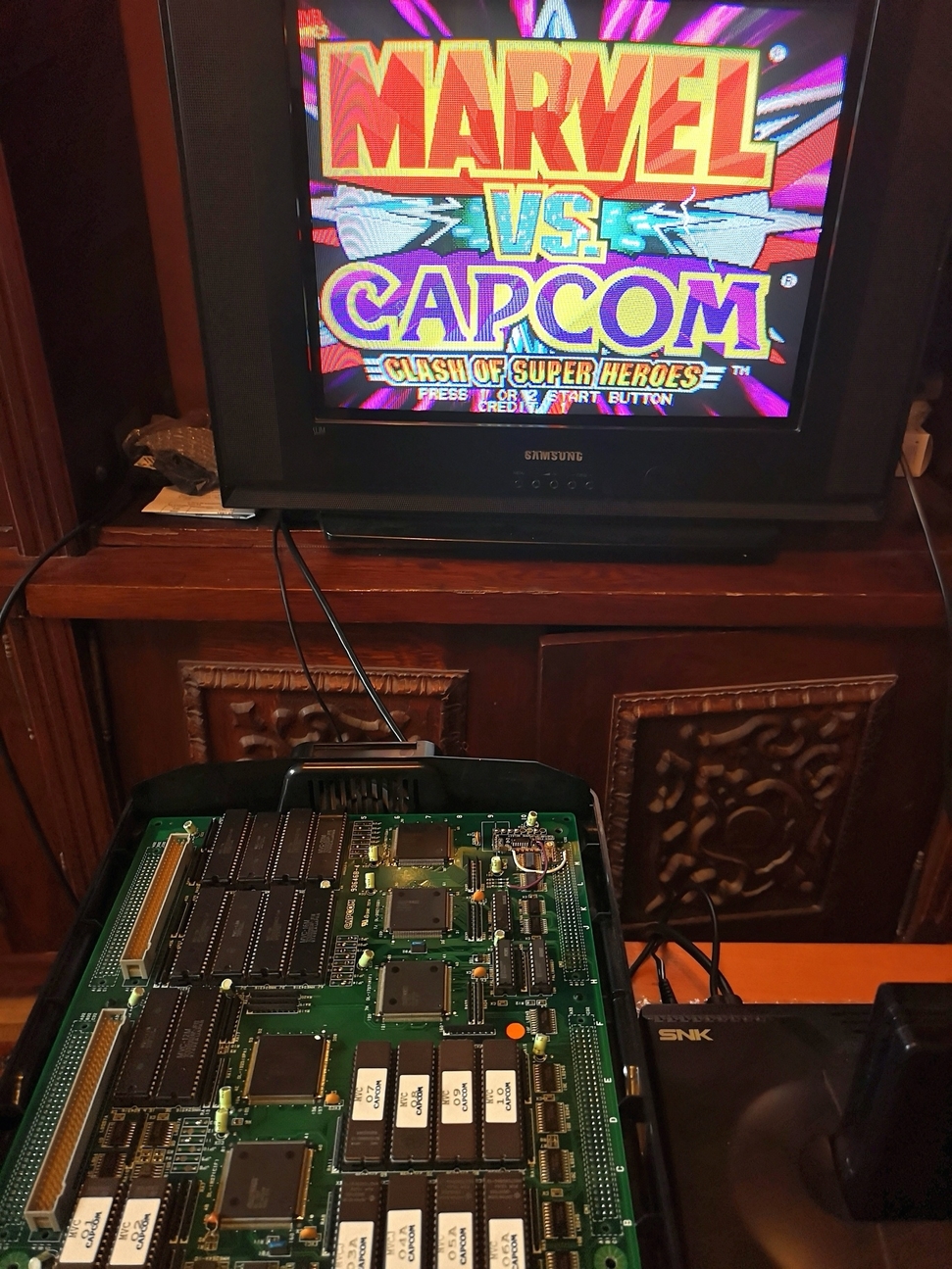

Here is my jap MVC b game with battery (93 / 09 - i think it's from September,1993) replaced with the InfiniKey ^^
ps : Hey, mr. @Ud, you were right about my CPS2 jap MVC game - is a rev.4 (i don't like them :whistling:)
