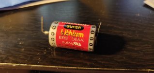

Pulled this battery off a working SFZ3. This must of been the original battery, never changed in over 20 years.
I did an install.
Removed battery, and did an install on Street Fighter Zero 3. It was working fine but now I am getting solid color.
I will try to clean up and recheck.

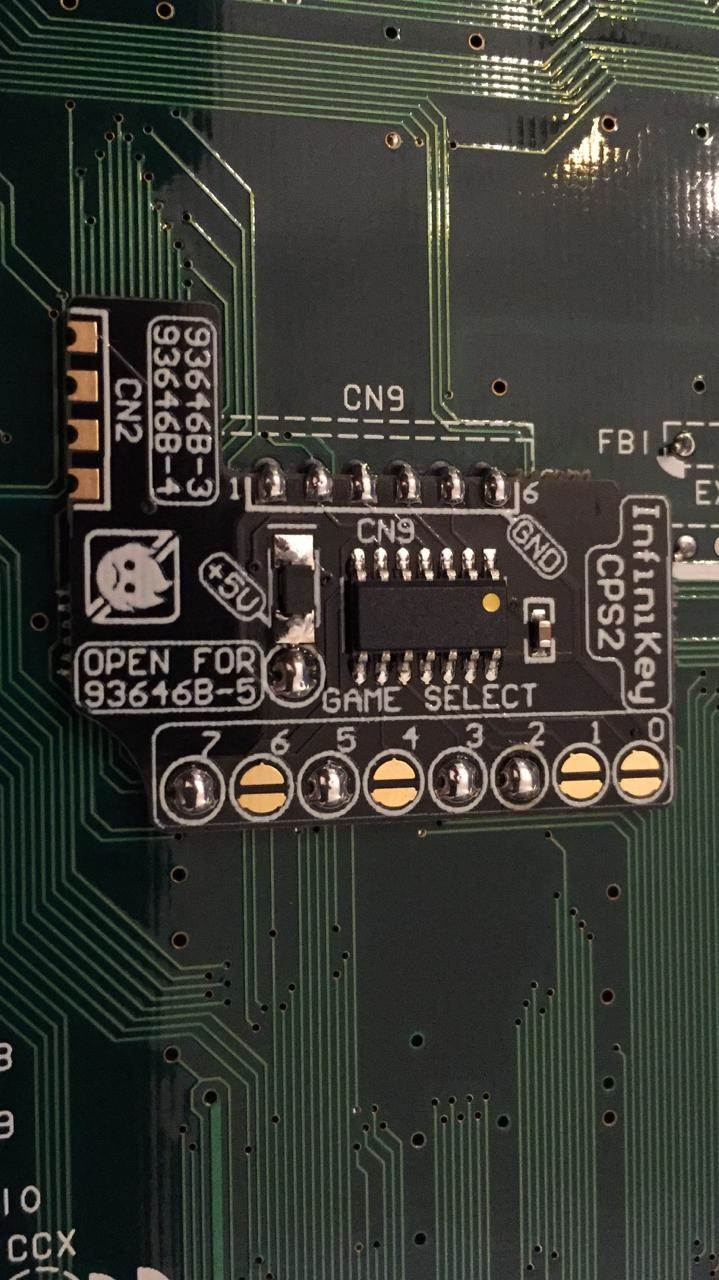

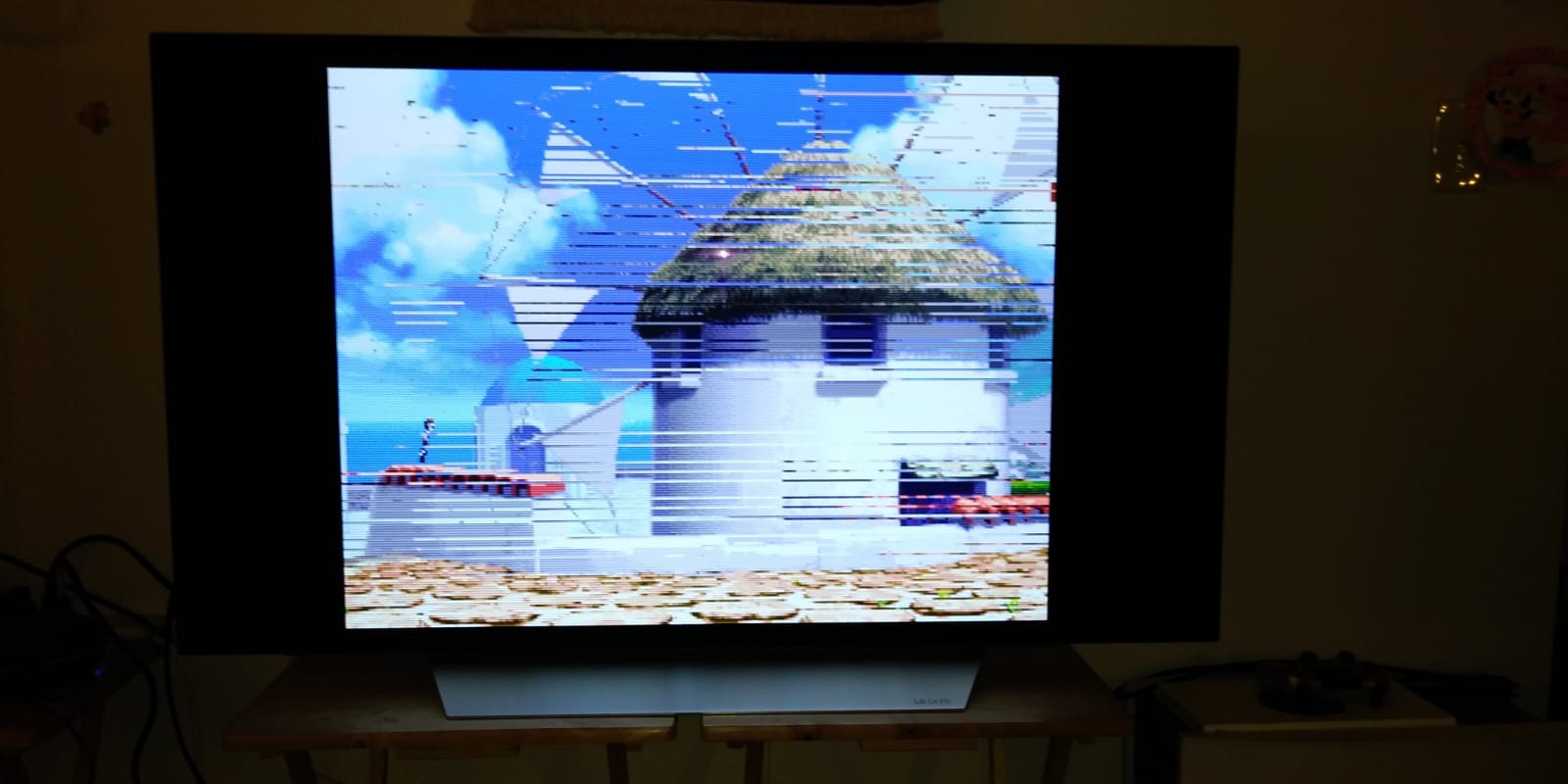

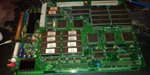

Sorry to keep you guys waiting. I opened up A and B and re-seated the ROM chips on B Game Board. The game starts but this happens. If freezes after a few rounds.
I did the install myself, did I miss anything ?
Just wanted to mention, A Board is good I swapped the game to Street Fighter Alpha 2(Zero 2) played it for a while...no issues or Super Street Fighter 2 works perfectly.
I was extremely careful, I hope I did not mess anything up unintentionally. From visible inspection everything looks okay. NO broken traces or anything else for that matter.
Any help will be appreciated.

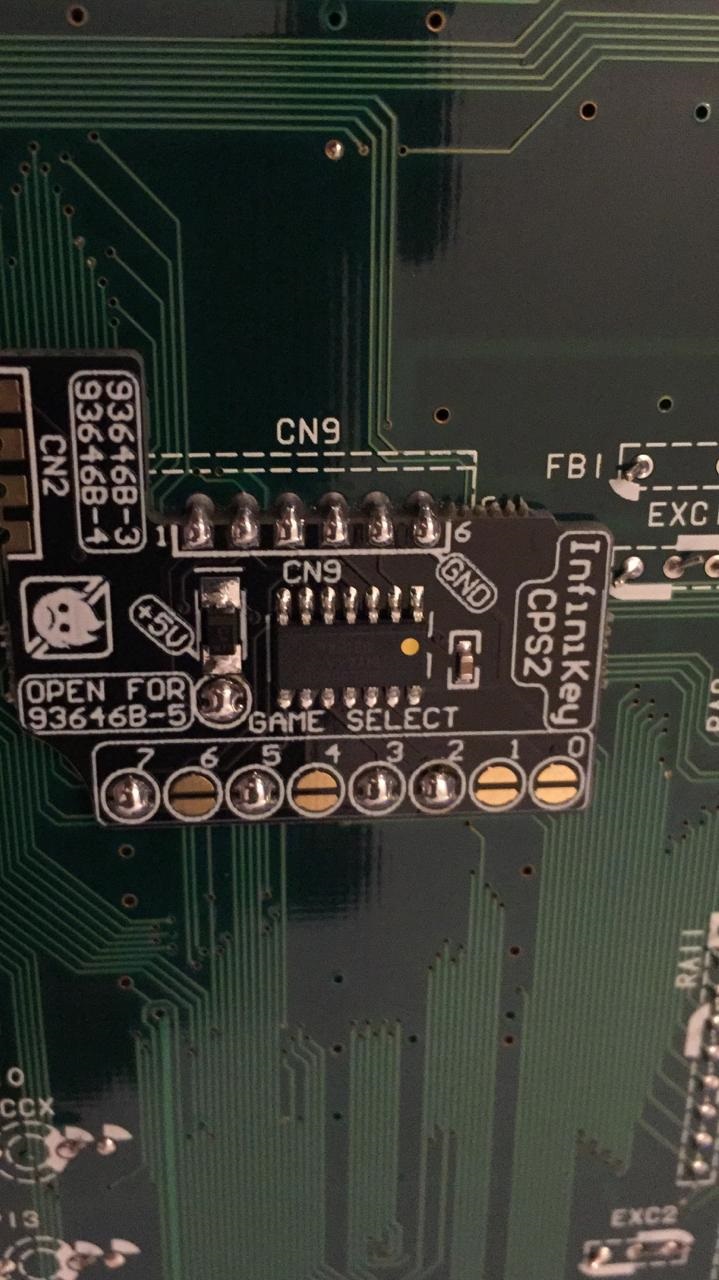

In photo labeled B2, it looks like the Rev 5 jumper might be bridged with the +5 point on the cap next to it. Can you test with a meter and make sure it isn't?
@Max_Power your soldering looks fine. Was the game dead when you got it? If you still have a good battery on hand, solder it back in, power up (so the key gets written), power down, desolder the Infinikey, power back up and play for a while. Does your game still malfunction?
In my experience, either the Infinikey works or it doesn't. I've never seen "sorta works and then fails."

Hi UD, just wanted to provide you with an update. I am not sure what happened but the game is working without issues. I played it for good 45 mins and I let it run for 4 to 5 hours.
I guess the InfiniKey got scared and started working correctly once I reported it to its master !!!
I am about to start the operation you suggested.... haha
Thank you
