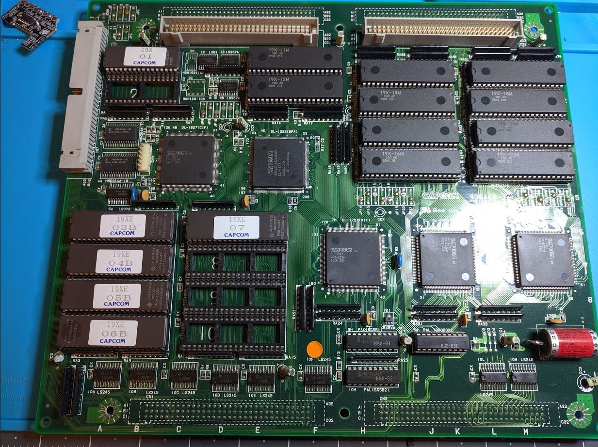

Hello!
I've just recently acquired a 19xx and was looking to install an infinikey but when I looked for the gamecode in the list, 19XE isn't an option.
It boots as 19xx 960104 euro and I can't seem to find any information on the web relating to this particular combination for 19xx.
I dumped one of the program chips and tried to run it through romident but it came up with no matches either :(
Is this version of 19xx supported by the infinikey or is this going to be one that I have to maintain the battery for?
Love the product, have done a few others with no issue.
Thanks!

Hey, sounds like you found a new one! Yeah, like xodaraP said, we have some dudes that can get it submitted to mame. @idc, could you generate a key from these files?

Dumped 01,03b,04b,05b,06b,07.
Looks like two of them did end up matching:
Identifying 19xe....
19x.01 = 19x.01 19xx 19XX: The War Against Destiny (USA 951207)
= 19x.01 19xxa 19XX: The War Against Destiny (Asia 960104)
= 19x.01 19xxar1 19XX: The War Against Destiny (Asia 951207)
= 19x.01 19xxb 19XX: The War Against Destiny (Brazil 951218)
= 19x.01 19xxd 19XX: The War Against Destiny (USA 951207 Phoenix Edition) (bootleg)
= 19x.01 19xxh 19XX: The War Against Destiny (Hispanic 951218)
= 19x-01.1a 19xxj 19XX: The War Against Destiny (Japan 960104, yellow case)
= 19x.01 19xxjr1 19XX: The War Against Destiny (Japan 951225)
= 19x.01 19xxjr2 19XX: The War Against Destiny (Japan 951207)
19xe.03b NO MATCH
19xe.04b NO MATCH
19xe.05b NO MATCH
19xe.06b NO MATCH
19xe.07 = 19x.07 19xx 19XX: The War Against Destiny (USA 951207)
= 19xa.07 19xxa 19XX: The War Against Destiny (Asia 960104)
= 19x.07 19xxar1 19XX: The War Against Destiny (Asia 951207)
= 19x.07 19xxb 19XX: The War Against Destiny (Brazil 951218)
= 19x.07 19xxd 19XX: The War Against Destiny (USA 951207 Phoenix Edition) (bootleg)
= 19x.07 19xxh 19XX: The War Against Destiny (Hispanic 951218)
= 19xj-07.6d 19xxj 19XX: The War Against Destiny (Japan 960104, yellow case)
= 19x.07 19xxjr1 19XX: The War Against Destiny (Japan 951225)
= 19x.07 19xxjr2 19XX: The War Against Destiny (Japan 951207)
Out of 6 files, 2 matched, 4 did not match.

In all likelihood, yeah, but it'd probably be quicker to just submit the dump to MAME, they will be be able to reverse the keys.
