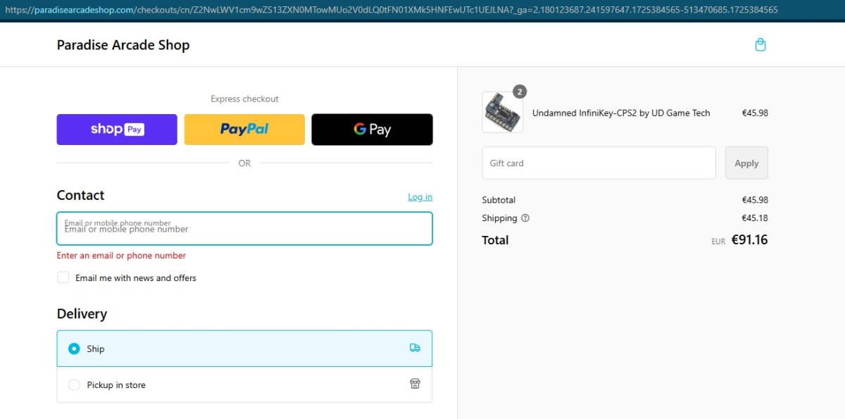

Hi, any idea for new stock in videgame perfection? I try to buy 2 infinikeys from paradise, and the price is 91.16€. Price of 2 is 45.98 plus 45.18 shipping. 8|
Alberto sent me astro city panel, airmail 5 days with tracking and was a lot less than 45€
In this price better to buy10 units to undamned.
The shipping is a deal breaker on those arcade parts sites from the US sadly
If it wasn't so high I would be placing a ton more orders

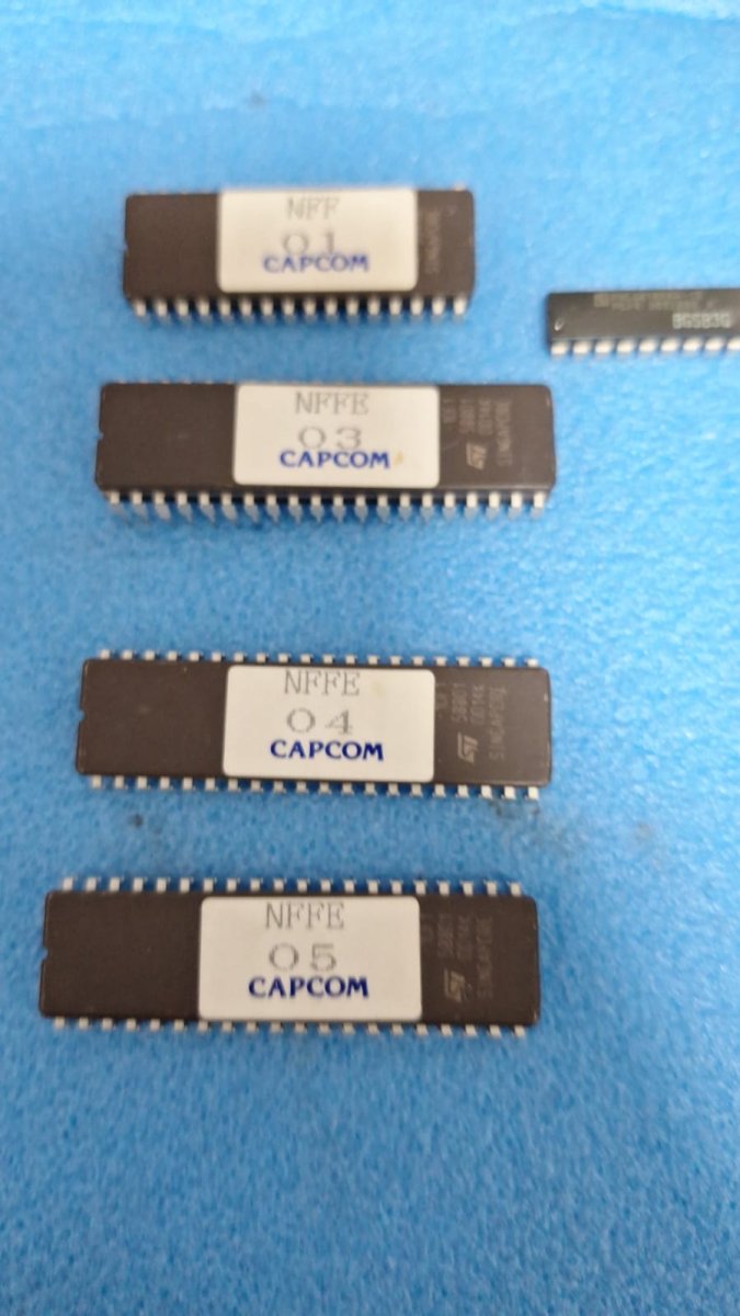

hey ,
i have a 1944 euro version
At the time, this version was not known, so I specifically sent the MAIN PROGRAM CHIPS to UNDAMMED, and he provided me with a code.
Unfortunately, the code doesn't work, and I'm getting a suicide screen, even though I verified that both Board A and, of course, Board B are functioning properly.
(also tried anothe infinikey)
Does anyone have an idea how to find the correct code?
many thanks!!!

sorry i dont understand, if he gave me the combination after downloading my roms-ist it enough?
The key data for games is in the firmware, the solder jumpers on the infinikey pick which key data to sent when re-programming the cps2 board. I don't see that game in infinikey's install docs, so it would require an updated infinikey firmware that adds the 1994.key data and a new jumper setting that picks it.
