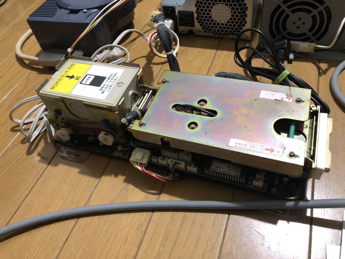

For what it's worth, I have just shipped 4 of my 5 card readers over to Ken in California (from me in Australia) to get fixed. (All 4 are not powering up, so likely the SMD fuses have blown).
I do not need all 4 back, so assuming he can fix them all, then I can look to part ways with 1-2 of them.

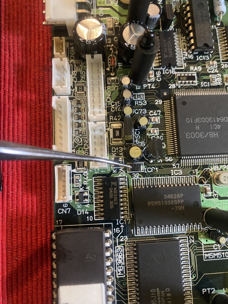

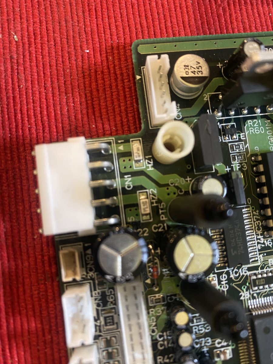

I just revived my slave side card reader. Check. These three fuses : hz1 , hz2 , icp1. If you have nothing happening then icp1 could be dead. I just changed mine and the thing came back to life. Now I have a connection error 🤪 the front motor is just cycling , opening the front and closing it, just like the master card reader
