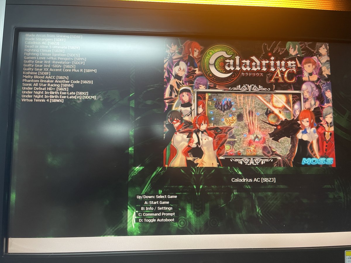

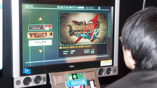

yes, based on that screenshot that's the Niko multi, not the official Sega one.
the official menu looks like this:
though poking around it seems there are a few replica front ends if you wanted an official looking UI
