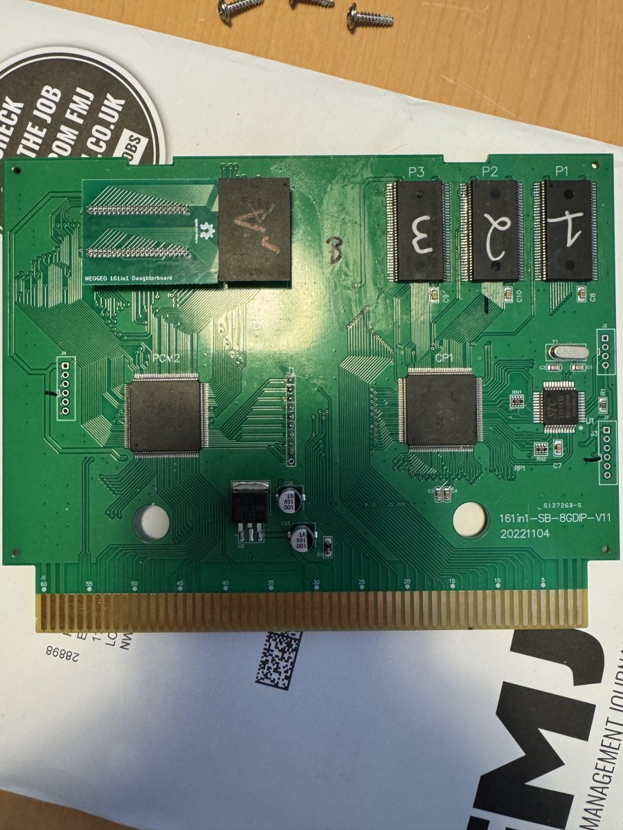

A couple of questions, I have the cart apart now.
Is the Prog pcb the one with P1,P2,P3 chips?
And which is the Jtag connector? I can see where I connect the 5 wires to the USB programmer, any chance of a pic. Thanks
And… The jtag connector J3 on the program board, is pin 1 the square hole?
Yes. And give me a few moments, I'll upload it somewhere more permanent. I didn't realize that link would expire!

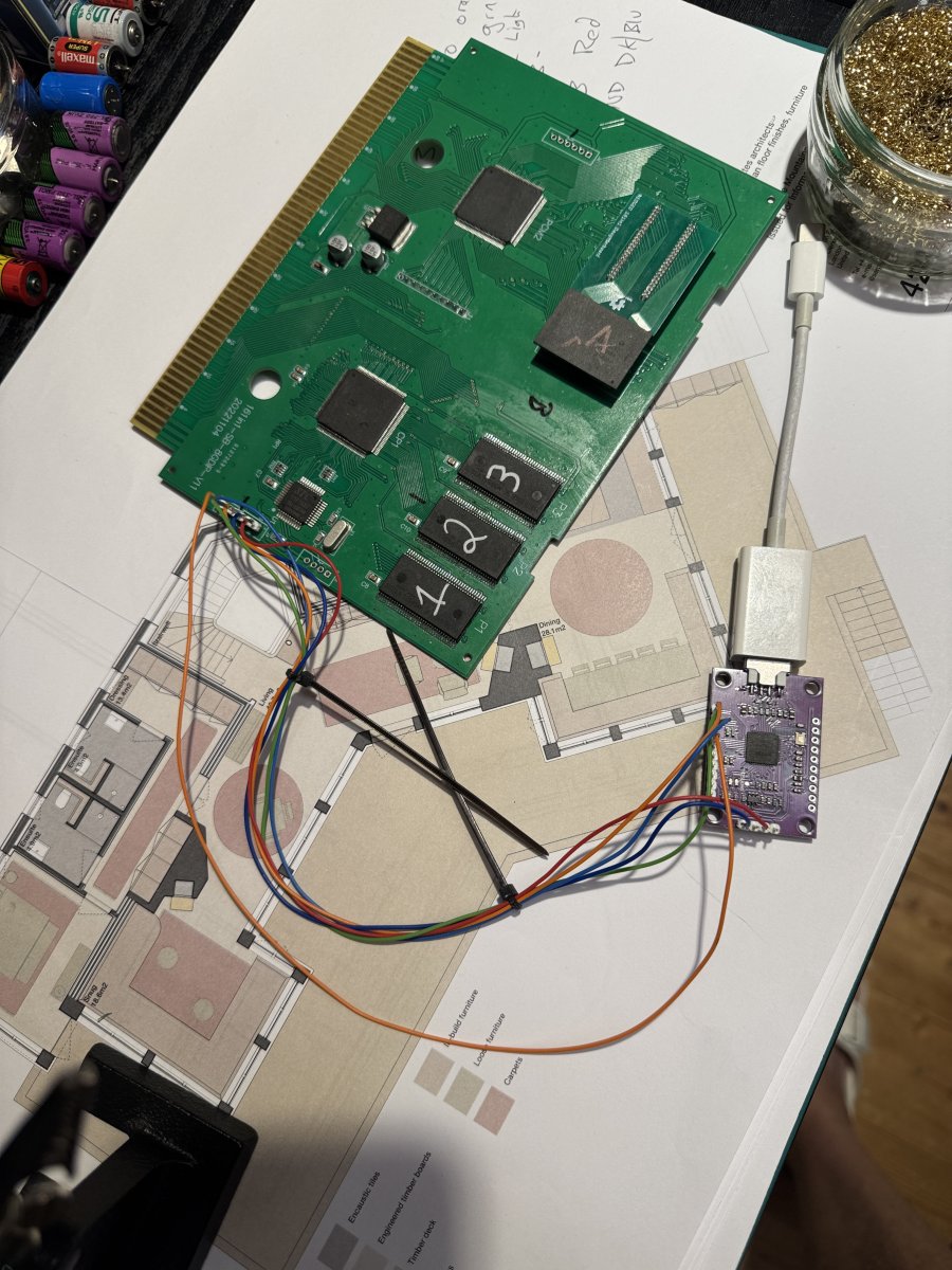

So I have everything connected up but cannot seem to find a version of Openocd that will download and open on my Mac.
Seems like 12 is the latest version.
I have downloaded the file that needs writing, I don’t suppose anyone is up for VNCing into my Mac and doing this.
Cheers, happy to pay for your time. :-)

I have not attempted doing this on a mac at all. Is 12 not the correct download? What sort of issue are you having opening it?
