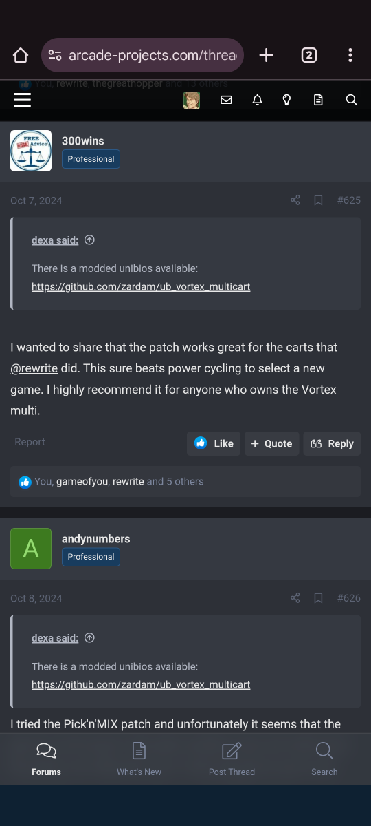

Received the cart and have tried it out briefly. Amazing work! This is a truly amazing cart. I have the unibios v4, with the reset-to-menu patch, and it works perfectly. Many thanks for taking the time to build these.
I'm not familiar with this v4 patch. Is there a link available with more detail?
It wasn't clear in earlier discussion but then I found this post, must have missed it initially:
It was pretty clear.

This one is pre-patched here:
https://drive.google.com/file/d/1dzdcFixIGvltdJReTPK_-_i4x0ihW1Vl/view?usp=drive_link
Since unibios is free now, I don't see any harm in sharing the pre-patched version.
