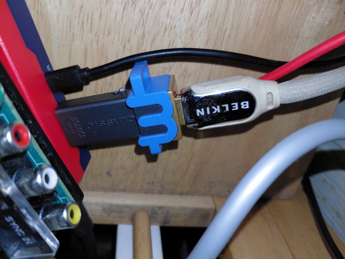

I have to ask- what is up with the filter on those images? It looks like that "supereagle2xSAL" (or whatever it was called) filter on emulators where smoothed all the edges on pixel games. How are you getting that on real hardware?
Also as far as I recall, the VMC worked on both my rewrite and leonk carts when I had them.
Yeah sorry thats either my clone retrotink or the built in filter on the Mclassic. I usually turn that off. The games I listed absolutely do not work. Like I said maybe certain games.
