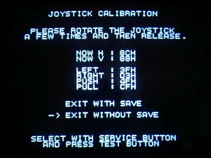

My original Monkey Ball stick gives these readings:
Pots are Tocos RA25Y 20FB5K and amp is OEM.
Thanks @nem. Your readings are quite different (greater range) to the gundam stick / 2k resistor / op amp combo.
Left: 63
Right: 211
Push: 79
Pull: 207
Travel between axis:
Left & Right: 148
Push & Pull: 128
The game feels fine, but I don’t have the OG to compare to. I wonder if the variance alters gameplay much or the game adjusts based on the values seen in calibration?
Or do I need to change the value of the resistors and install new pots?

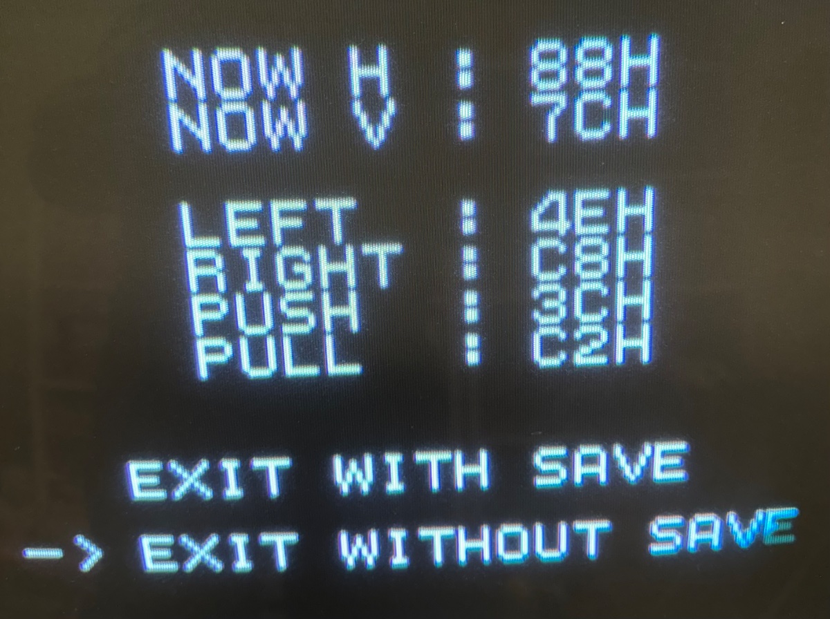

My readings, Gundam Stick, no Op Amp, no resistors but with a 3D printed restrictor based on nems measurements.
Feels good. Played a lot on a friends original and dont feel any difference. Plays great with this setup. Managed a flawless clear which gives you the 3 extra stages on normal for the first time.
^ closer to @nem's readings.
Thinking the value differences now are due to the resistors installed? Paging @Lemony Vengeance for some info on the science and possibly his readings...
I installed the restor values that XeD suggested in the gundam stick thread, they have been deemed “pretty darn close” to the legit values when used with the AMP PCB.
Easy. Can you post up you calibration screen. The values @FrAshi and I are seeing are a bit different?
I’m wondering if those resistor values took into account the Gundam restrictor and now with this repro installed, the resistor needs changing?
