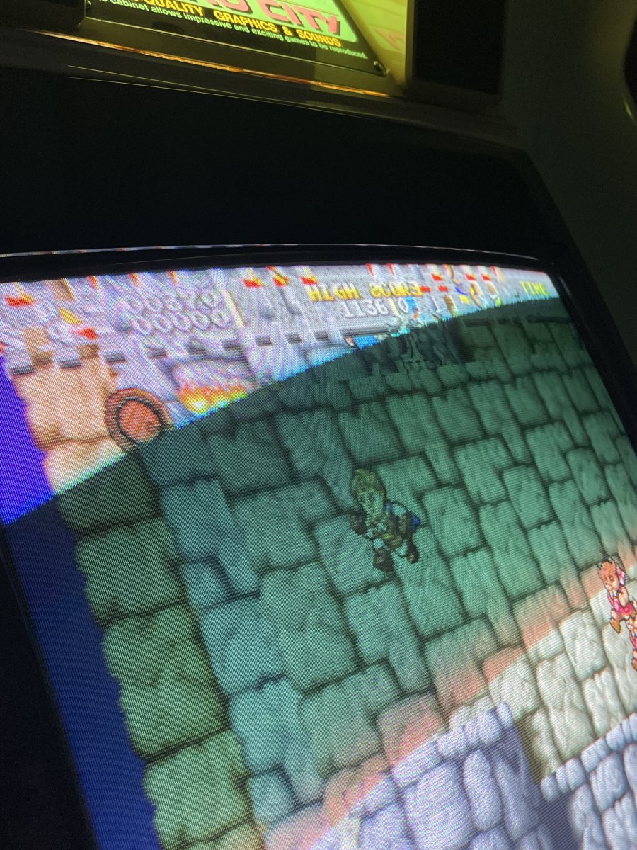

So I’ve taken a like to Legend of Hero tonma… and i have a graphical issue and i think i remember seeing the issue mentionned somewhere but perhaps it was removed since Apoc left?
The issue is on the top of the screen, not all the time but often, you can see the “high score” has some letters inverted below.
Help?!

I played the first stage several times tonight and didn't see this happen with my hardware.
