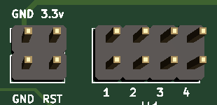

Hmm... No +5V on that header though.
Anyway, for clearance (for others reading the messages): the picture shown above in BladeZX post is for S18, NOT for M72 PCB/Multi as this topic is/should be. We are wandering fast off-topic here :)
I believe we should end discussion about S18 now in this topic. @BladeZX - I'll send you PM later.

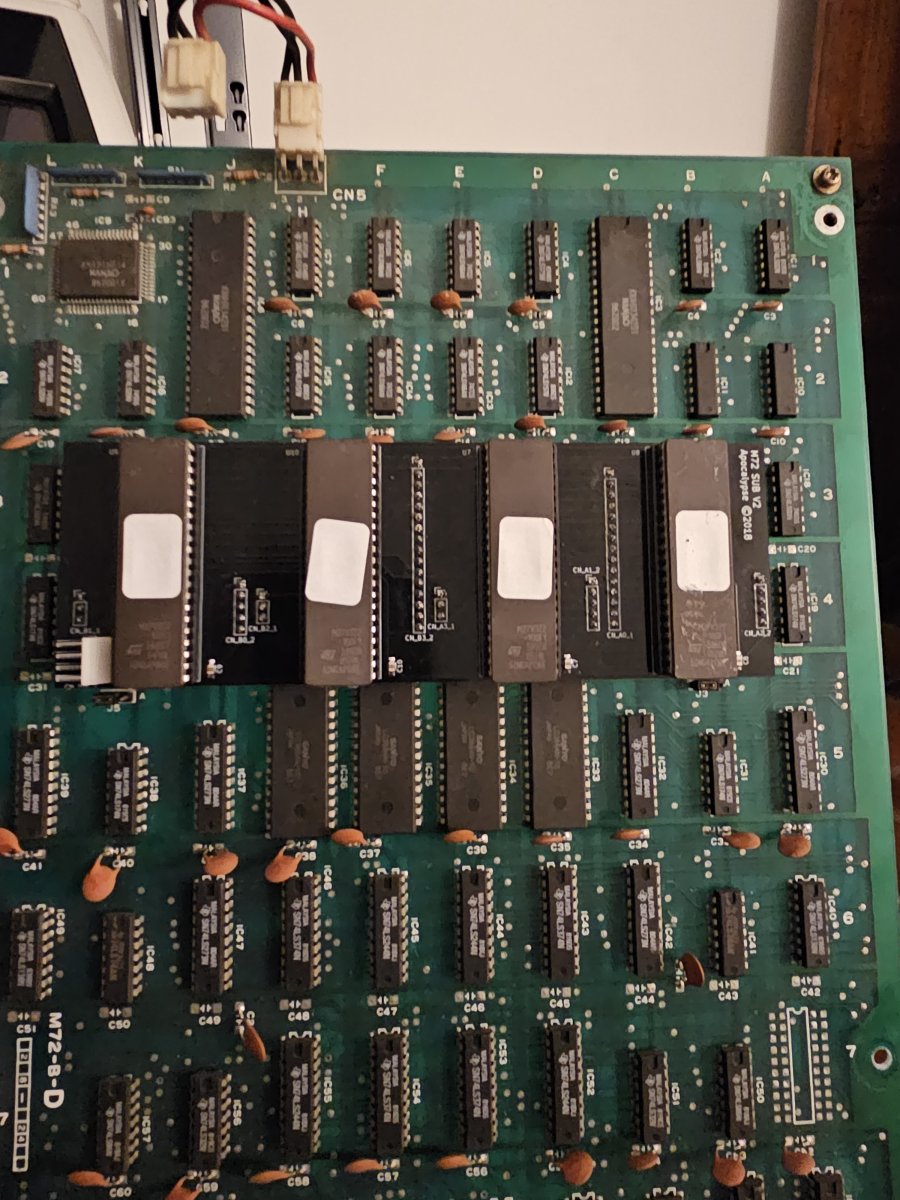

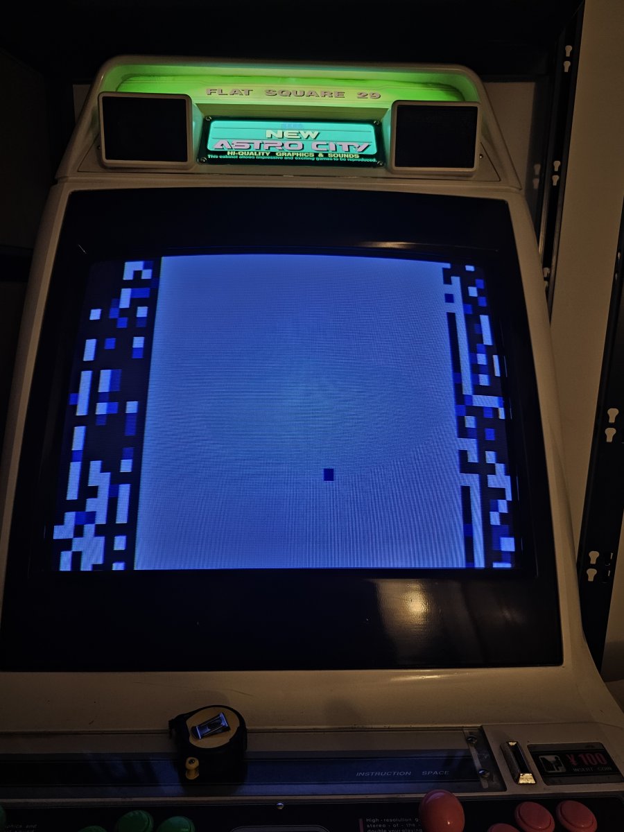

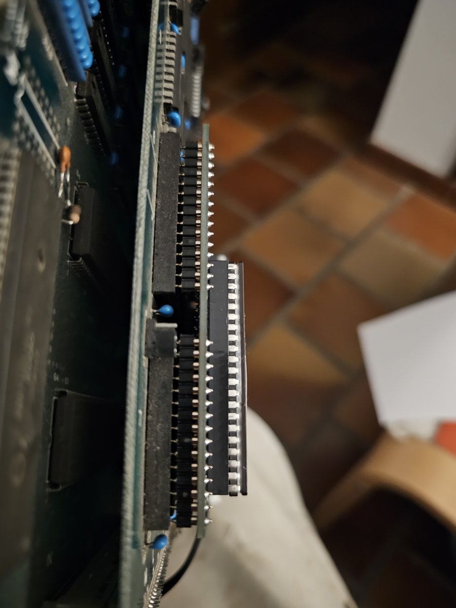

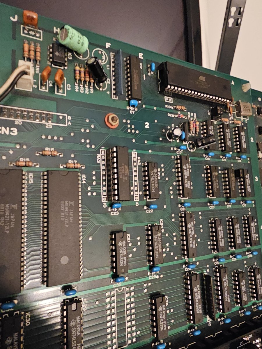

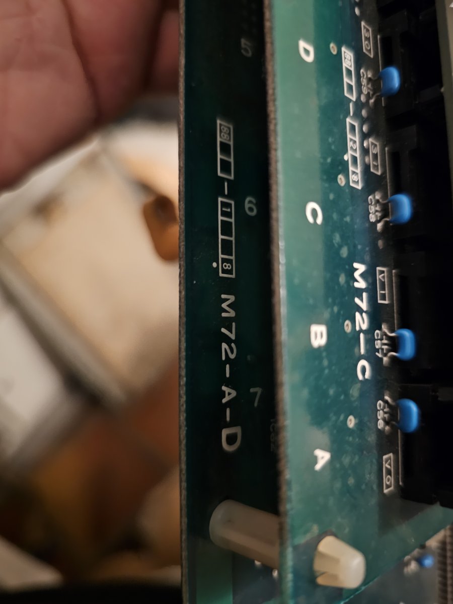

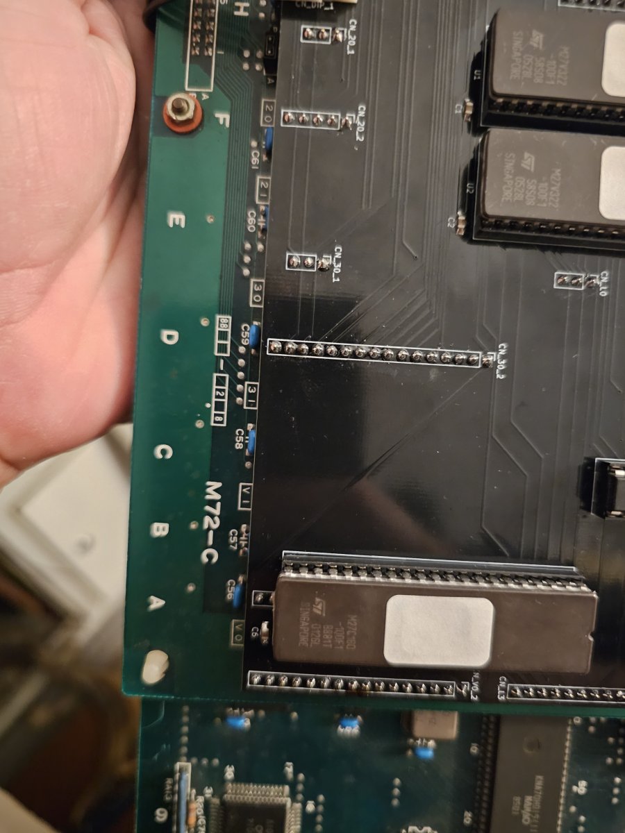

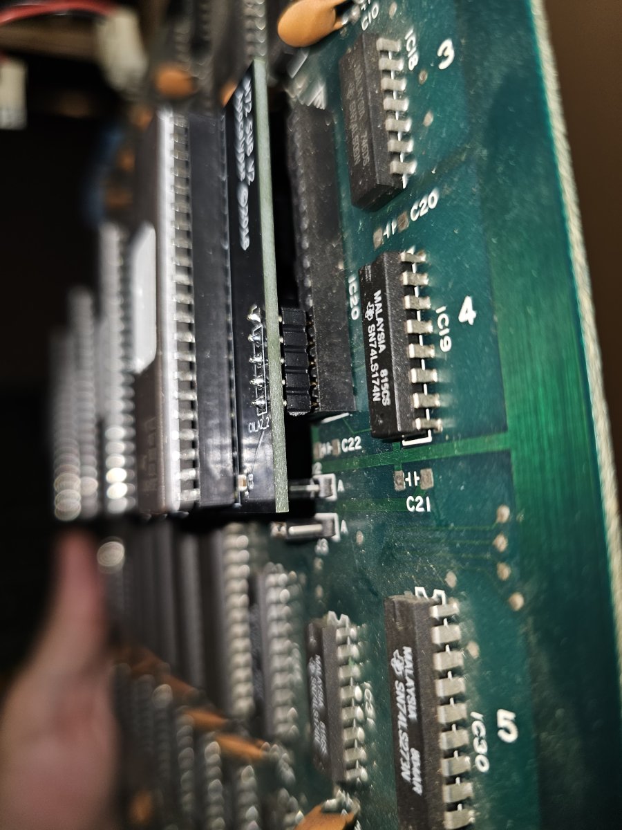

I just received it it Washington really fast. But I have an issue.
I double check all jumpers and the pins of both board everything is Good.
It start on that screen and stay on it.
What can i do?
It's on a Dragon Breed m72
