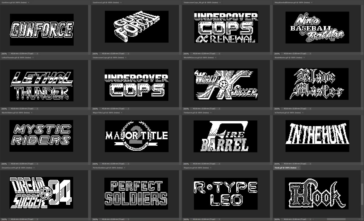

Here are all the M92 Multi game logos for an OLED selector. It hasn't been officially announced that there will be a selector, but I figured I'd draw these up just in case sometime in the future someone smart can come along and build an OLED selector for the Multi.
Attached is a zip file of indexed .bmp's, ready to be converted to binaries when needed.
I'm looking forward to this multi!
They look so awesome! what a great idea. Would it be possible to get Geostorm instead of gun Force 2? Thats the proper name 😄
