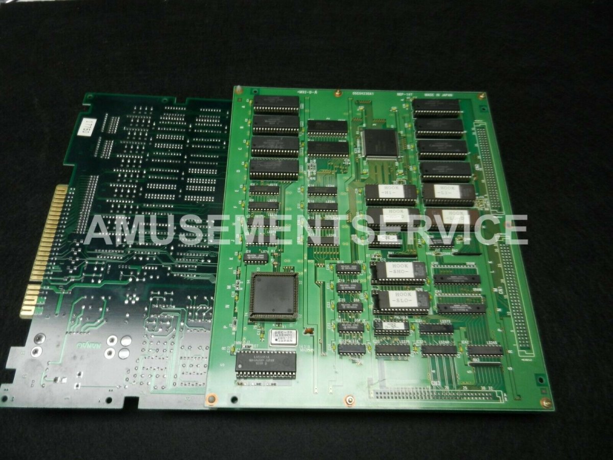

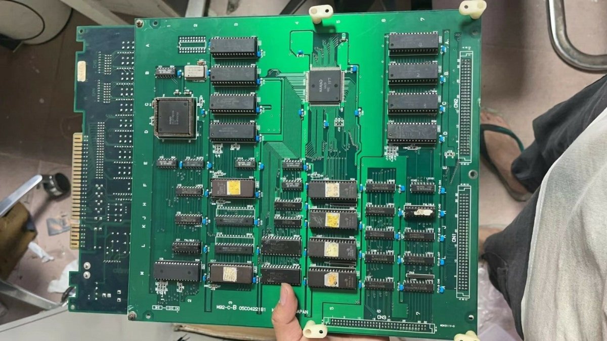

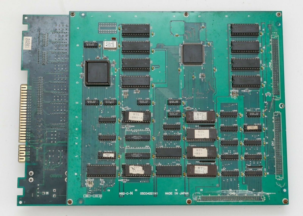

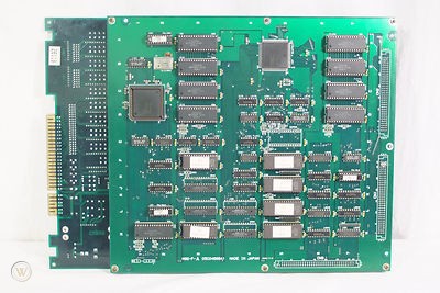

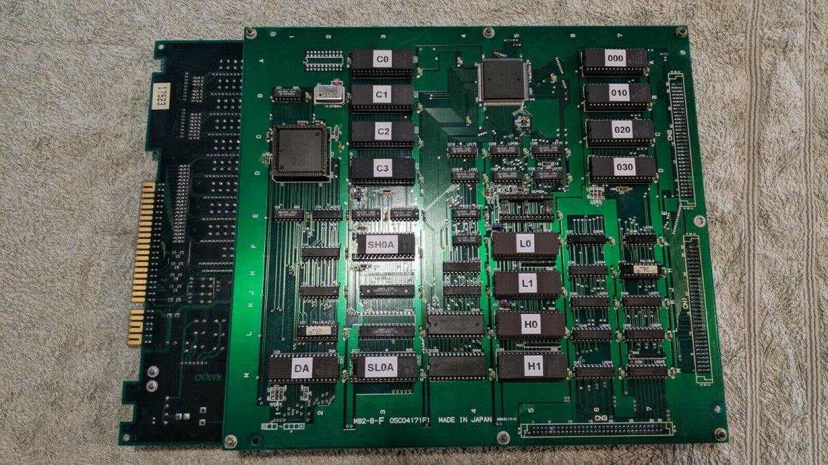

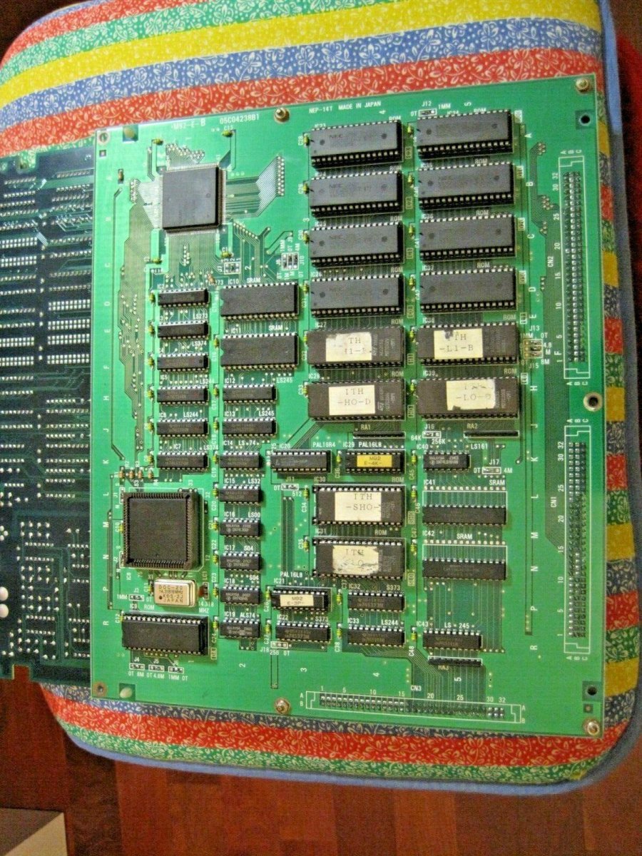

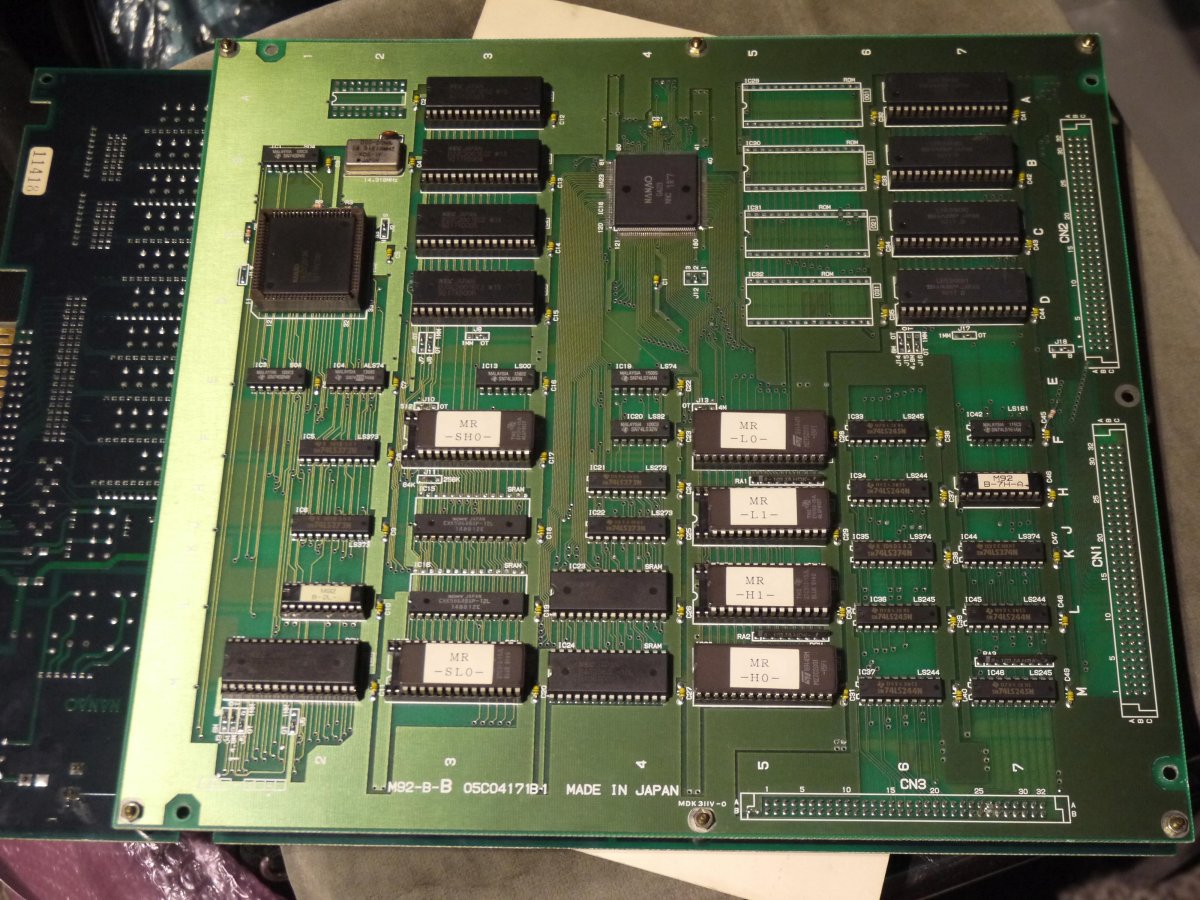

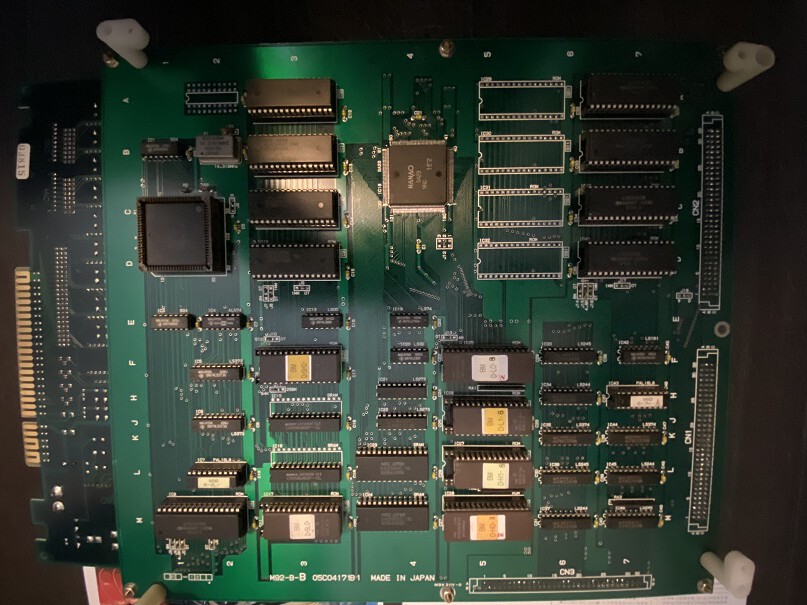

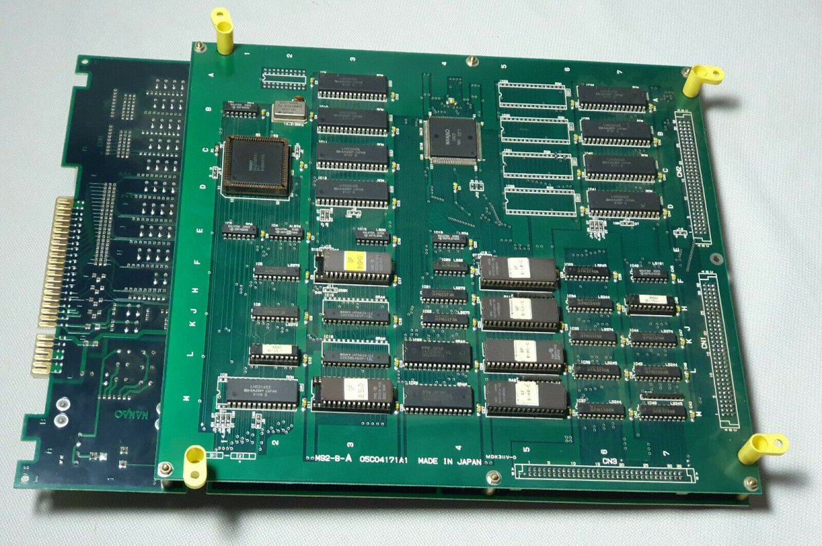

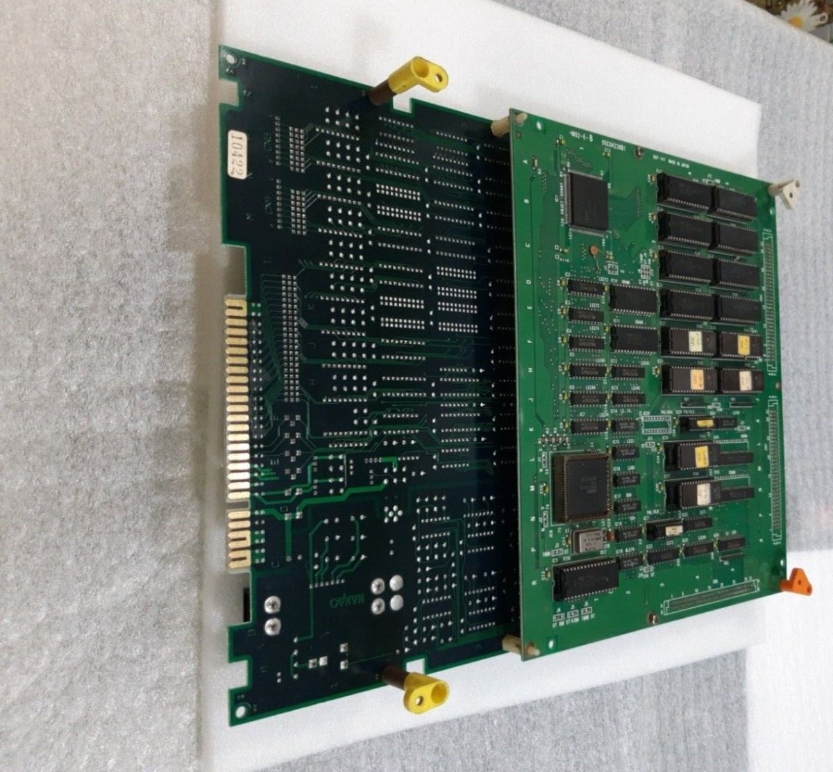

What does this 0BJ8 custom chip do?
All A boards of all games the same with M92-A-B lettering.
It seems that Blade Master has the same board as Gunforce 1. It means no MULTI and only fully reversed ROM board? I am attaching pictures of the B boards I have found. Only Dream Soccer 94 (1994) and Perfect Soldiers (1993) are missing. If someone has a picture of those boards pls put them here...
Pls check them guys and confirm which board is usable and the best for MULTIes.
IREM92_1991_M92-B-A_Gunforce 1
IREM92_1991_M92-B-B_Blade Master
IREM92_1991_M92-C-B_Lethal Thunder
IREM92_1992_M92-B-B_Mystic Riders
IREM92_1992_M92-B-F_Major Title 2
IREM92_1992_M92-C-N_R-Type Leo
IREM92_1992_M92-D-A_Hook
IREM92_1992_M92-E-B_Undercover Cops
IREM92_1993_M92-E-B_In The Hunt
IREM92_1993_M92-F-A_Ninja Baseball Batman
IREM92_1994_M92-B-G_Gunforce 2
And how will look like the fully reversed ROM board? There are geniue chis on B boards. The sound CPU and the sprites chip if I am not wrong?
And what is this 0BJ8 custom chip for?
thats a mitsurugi question. idk how they make it work
All ROM boards use PLLC 08J27291A1/8J27291A4/8J27291A7/8J27291A8 etc.. parts. These are sound CPUs. Do they differ each other? Are these some official parts or a geniue ones?
Earlier ROM boards uses GA23 parts while never ones use 08J27504A1 and PD65082. What do these chips do?
The sound CPUs on original M92 boards run encrypted code, with the decryption keys "baked" into the CPU. They each have different part numbers for that reason. FYI: there is a jumper adjacent to the CPU that you can change to have the sound CPU run decrypted sound code - useful when converting an original M92 ROM board to another game.
We're not sure how the M92 Multi will handle the sound yet, but since Apocalypse was able to successfully decrypt & re-encrypt the sound code on original M92 games years ago, it's a safe assumption that this Multi will run with the original ROM dumps with the encrypted sound code.
