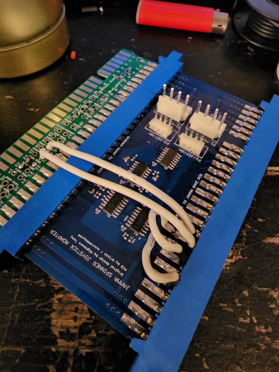

This is what I did. Not working for me. I know in theory it should. I checked my connections and soldering and still just rotates to the left constantly. I made sure there is visible space between the pads and lifted pins. And verified all solder locations are correct.
i pulled everything off one by one to isolate the issue, and it is that p1 to left input. everything else works as it should
i rewired it and it still has that issue

My pass thru adapter is fully wired. This is a Pic I took half way through , before I tied the left and right to the jamma pass thru adapter

i figured it out. i had already lifted the pins to L and R. turns out the culprit was a surface mount resistor going into the Left input was missing. i must have hit it with the desoldering gun while desoldering pins or something. i replaced all the surface mount resistors going to L and R and now it works 100%
thank you very much for your help @Bonky and @West
