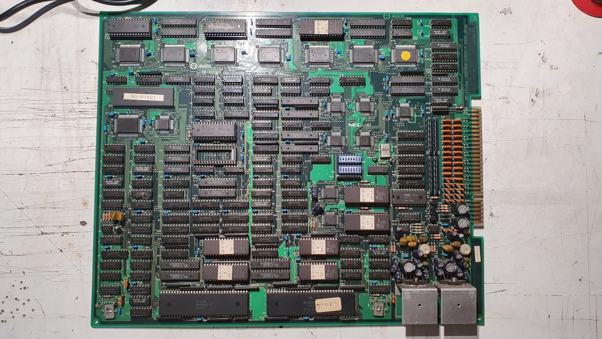

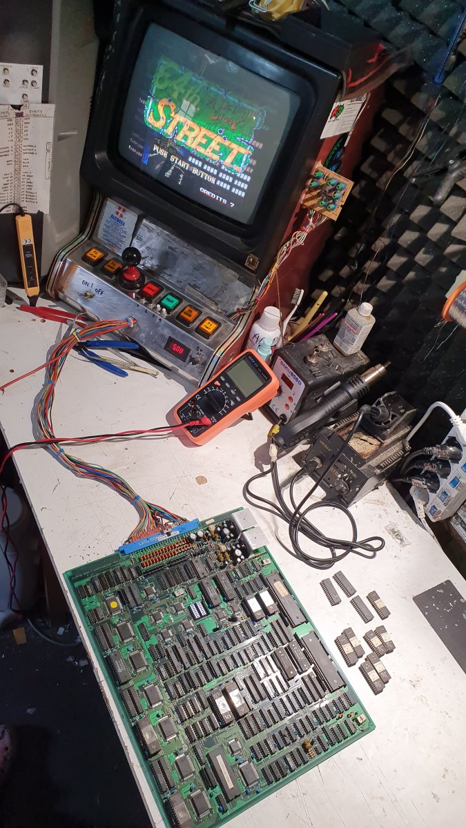

Thanks for the informations, i don't know if this cares anymore but the patch works on real hardware (BigStriker to 64TH).
I didn't had to change the birom, fortunatly.

Using the big striker prom on cybattler just had some of the background objects blocking your view but otherwise fully playable.

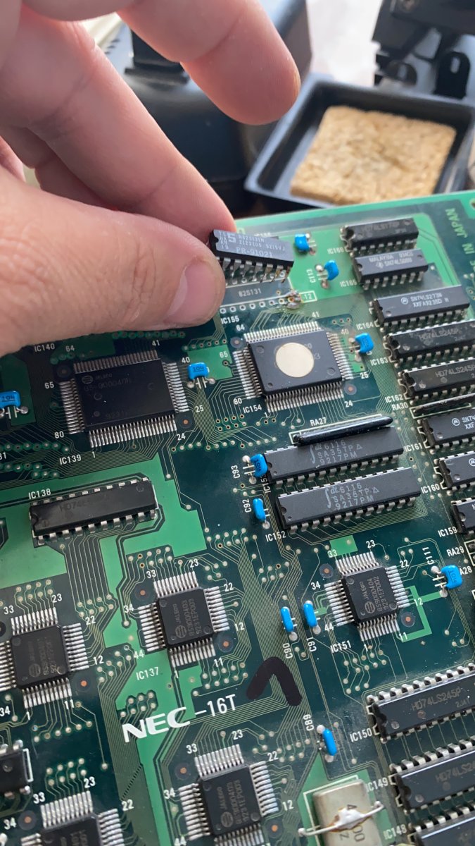

Indeed , tried and this is what i got (anyway , here i placed wrong the eeproms thats why it looks like this and i understood what you mean -> the game with bog striker bprom is playable , is almost 100%) :
View: https://youtube.com/shorts/nuzjPS37Ekk
