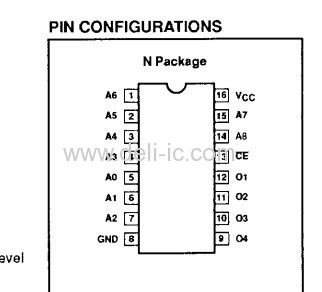

Can someone who has done this conversion do me a favour? I've got an original I'm trying to sort out and I think the PROM has died
I need to know which pins show activity on the PROM, I have several that show nothing at all and I'm not sure if that's intentional or not.
Also, @twistedsymphony - from your programming, do you know which pins are input and which are output?
the BPROMs are standard 82S131
I Honestly don't know if all of the address lines would show activity based on how the main board uses them.
