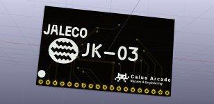

Do you have broken 'JK-03' ceramic customs (which are used for inputs) or the 'JK-01' one?
I have reproduced the first (I still have to send design to manufacturer, I attach a 3D preview) but I can do also the latter.

Do you have broken 'JK-03' ceramic customs (which are used for inputs) or the 'JK-01' one?I have reproduced the first (I still have to send design to manufacturer, I attach a 3D preview) but I can do also the latter.
Yes, smashed jk03's, maybe 2 gone on each board... and more The JK02 was nicked off one to save a legend of makai.
I was searching my junk pile over the weekend and need a lot of customs that you can remake, (silkworm, konami, etc, etc).
I will send you a message or something soon regarding the matter :)
Yes, smashed jk03's, maybe 2 gone on each board... and more The JK02 was nicked off one to save a legend of makai.I was searching my junk pile over the weekend and need a lot of customs that you can remake, (silkworm, konami, etc, etc).
OK, happy to help you.As for the 'JK-02' it can be reproduced as well but I miss a sample to analyze.
