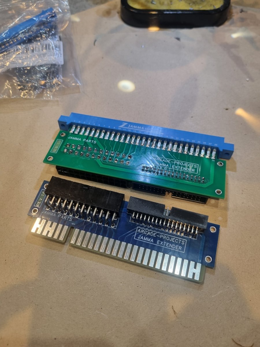

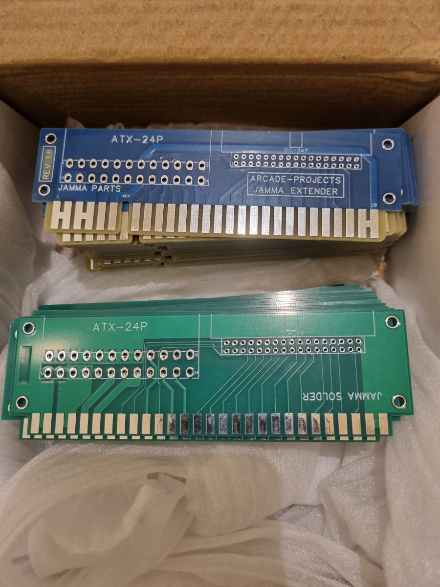

Pcbs arrived, parts still in transit cables yet to be ordered. The blue looks spot on 20% bevelled finger, the connector end I thought was a manufacturer issue but alas when i checked my order I forgot to tick blue solder mask leaving it green. So that's just that for now.

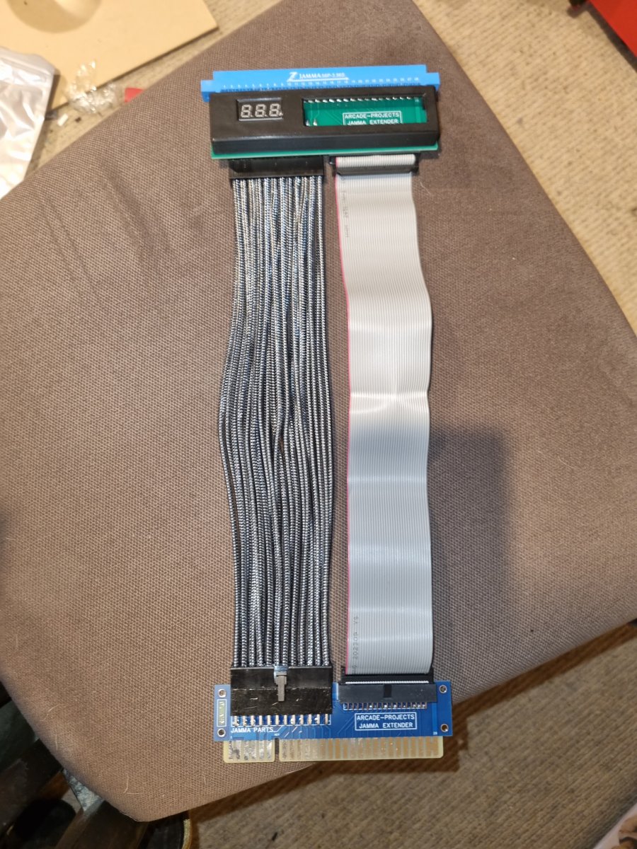

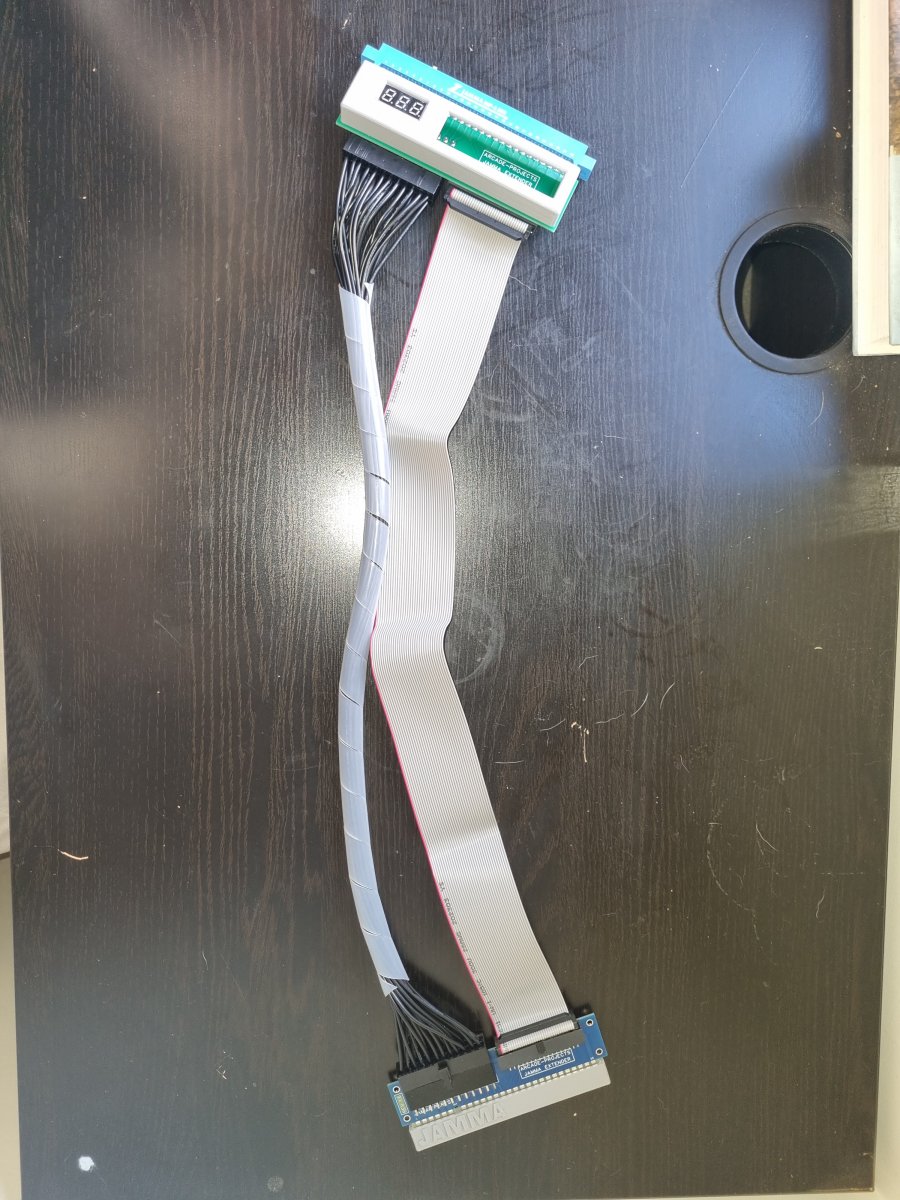

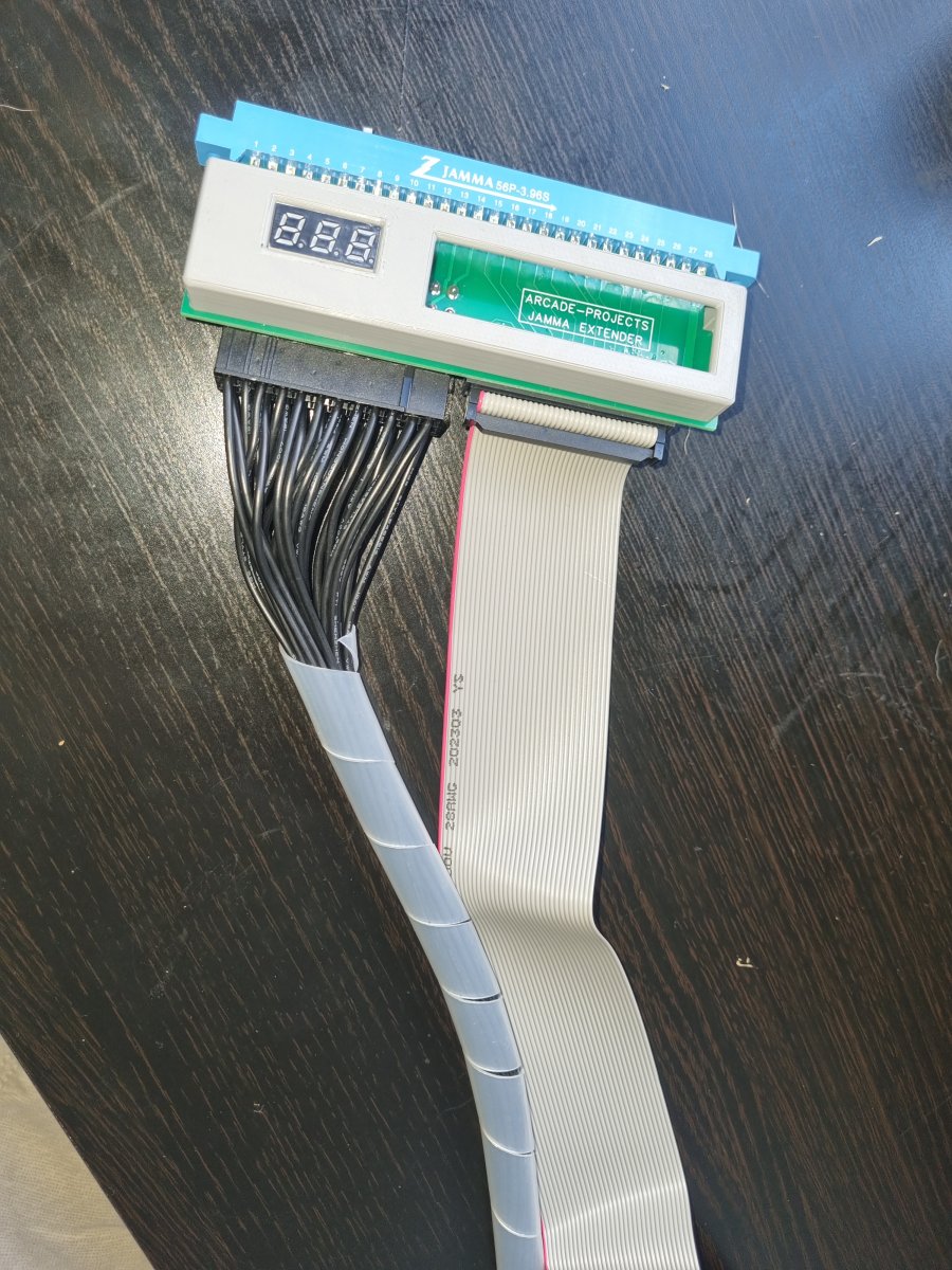

One finished in 50cm, I sort of wish some sellers could measure better, they are both 50cm cables but the atx is about 3cm longer than the idc.

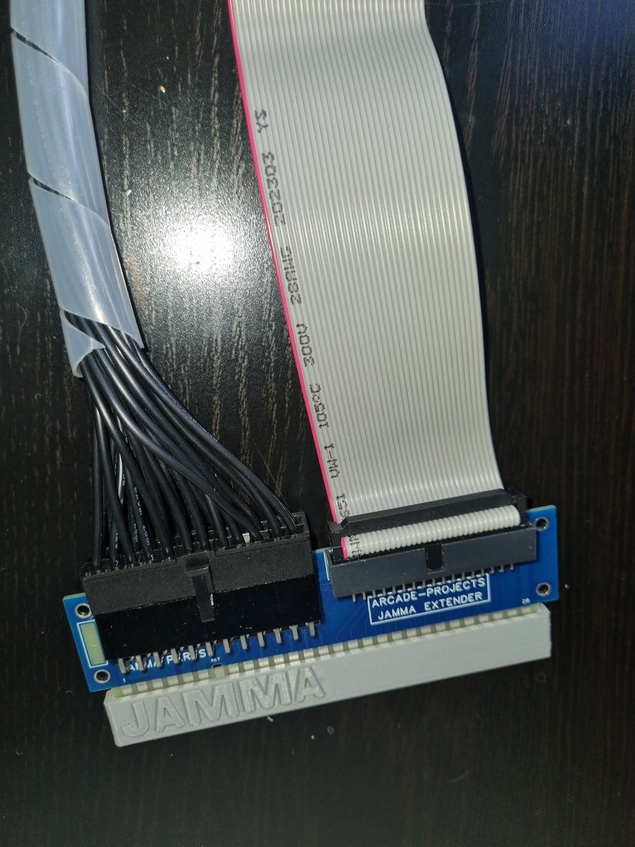

I keyed the jamma plug because I typically use the wire colours to identify direction when i am digging around in the back of a cab and they are not on this cable.

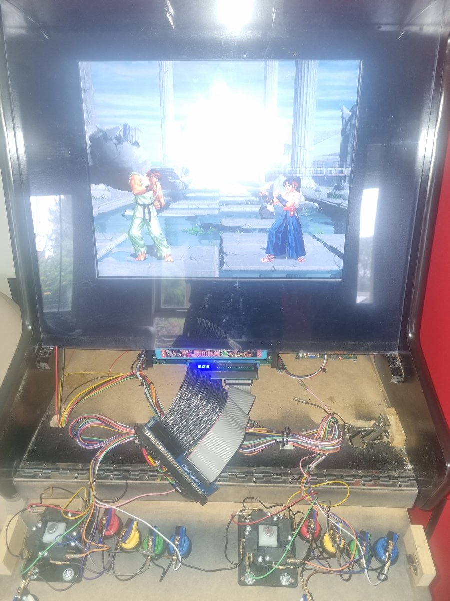

I ordered 50 of each PCB as the cost after special deals was almost the same as 20 of each but once these are gone I am not sure if I'll do more. While I did a few without a voltmeter, I really liked this function and ended up soldering a voltmeter into all of my remaining cables. It would be interesting to hear opinions on the value of a voltmeter that measures at the JAMMA edge as I have found it useful but can see issues relying only on this reading for more complex applications. Photos below of a play test of one in my MVS cab.
