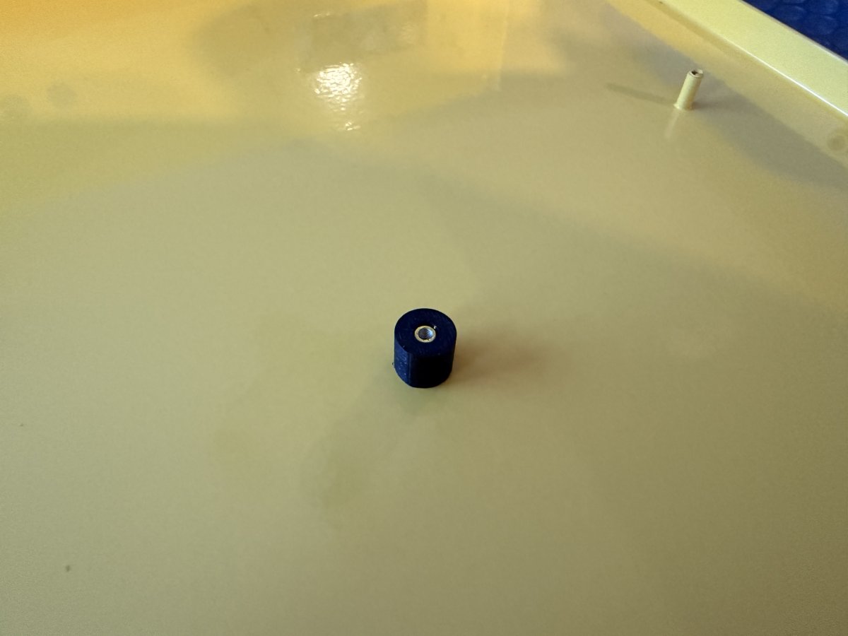

I’m going to include these spacers with each case shipping out to accommodate the variances between boards. If anyone wants to print some - let me know and I’ll send you the file. It’s stupid simple.
Also - first 5 preorders shipping this week!!

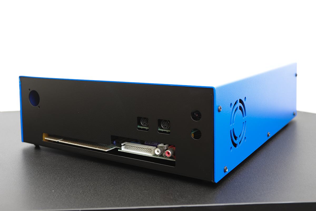

I am doing 5 more cases with blue covers and black bases (both with a textured, non-gloss coloring) that have the bottom stand offs for the board mounting to give space for the comms board, added two rectangles for the s-video jacks, and moved one of the 12mm holes to be below the other to allow for everything to fit. Huge thanks to @Mitsurugi-w for loaning a comms board to check.
One interesting thing that needs to be overcome is the support for the comms board. None of the holes line up with the A board, so I suspect some 3d printed support will be needed. Maybe a long spacer that sits between both boards.
I have FIVE new CPS2 case shells with the initial setup that supports the Comms board. It’s near perfect, but the JAMMA header and such is recessed into the case a bit and I want to refine the back a bit before run two. Interested in one? They are available on the site now and shipping within a day or two of order.
This new version of the case supports the Link PCB. To do this, we had to move the overall PCB mounting further into the case which recessed the JAMMA edge. If your JAMMA connector has ears - it will not fit onto the PCB, it will be blocked by the case. You can trim those off (carefully at your own risk) and it will fit. Because of the way the comms board fits into the B board, this had to be done to ensure everything could be assembled as easily as possible. Additionally, we created two "support pillars" that you will need to fit under the comms board and screw into. This prevents the board flexing down and holds it in place better. It won't stop it from moving UP though. I intend on solving that in the next interaction of these cases by adding a securing post to the bottom of the case. The Comms Board and overall assembly sits back about 5mm from the edge the case. The next revision will address this as well.
The colors are: Blue Top and Black Bottom. Fitment is TIGHT. Be careful separating the halves so you don't scratch them at the mating points.
Due to the need for MINOR revisions. I have discounted these $20. This discount will not follow through to the next iteration. These are in stock and shipping now.
Mind if i get the STL? bought mine a while back.
