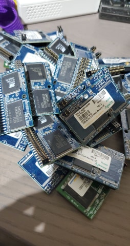

Most likely its a modified DOM that has the Drive Serial # / Model Modified to match the security checks in U98... still just easier to burn a U98 and then program a flash drive.. they are easy to get / find.
those old ssd's/dom's are terrible - they are so slow!
i have a couple somewhere from old HP thin-client pc's
