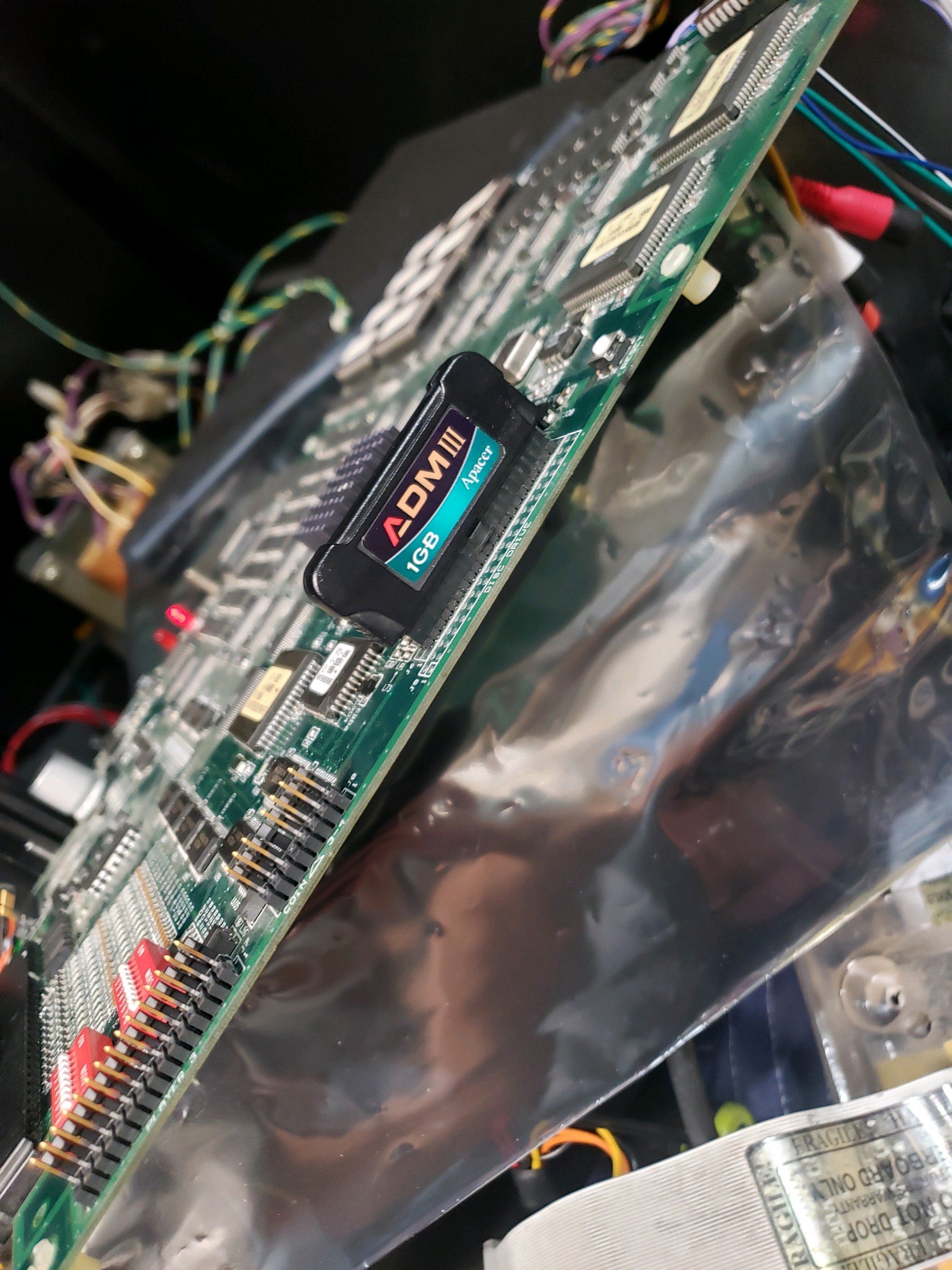

I had seen an old sales thread on KLOV about replacing the KI2 hard drive with an IDE DOM, as well as post by @acblunden2 considering a DIY version, and thought, 'Well, I already have half the parts, let's give it a try.' I particularly like having the DOM on this board since it's shorter than one of the heatsyncs, and doesn't stick off the edge of the board like the CF adapter I have. I've only played a bit but didn't notice any unusual behavior vs my hard drive (though I'm admittedly not that discerning when it comes to this particular game).
In case you want to reproduce this, I used a USB-IDE adapter, some gender changing pins, a 44 pin DOM I picked up off eBay, and good old diskpart and chdman.exe. I assume you already have a CDH and the boot rom done. The process is identical to creating a CF card, but here you go:

That's it, plug it in the board.

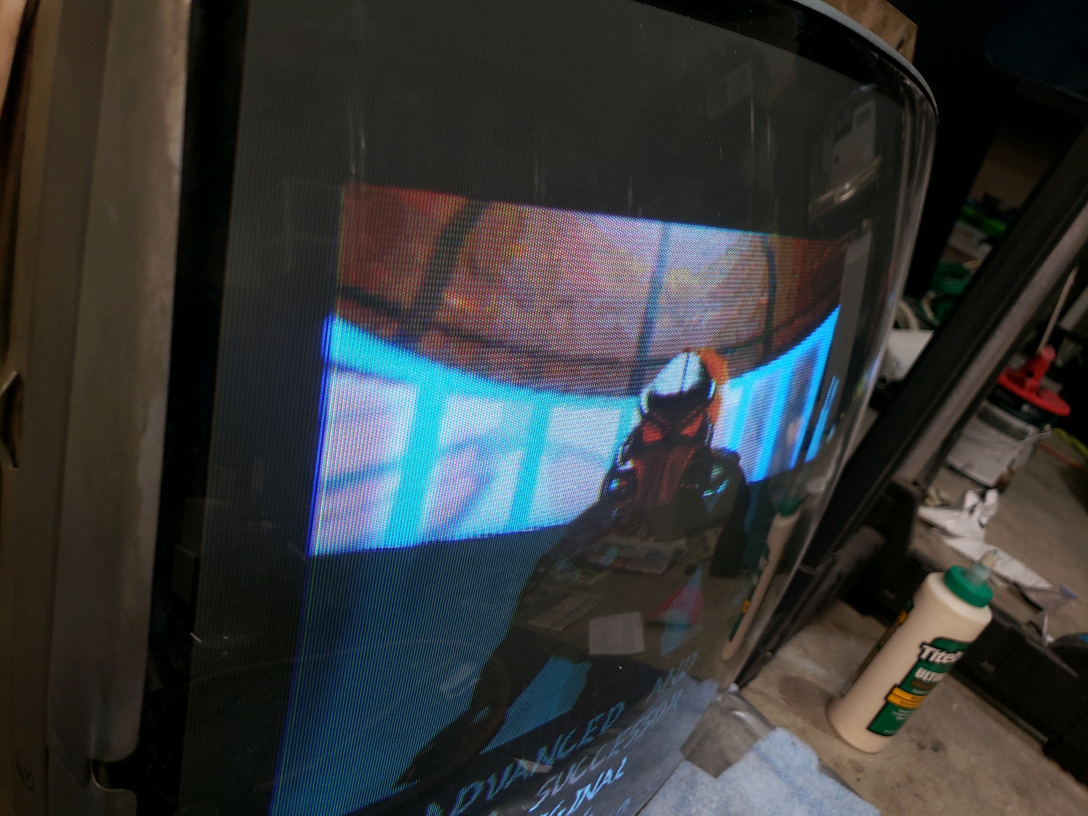

Promptly lose to the computer, hit test mode and adjust the difficulty. Lose again. How do you combo again?

thanks for posting this, was having issues with that CDH. needed something a little more secure for what I'm doing.
@ekorz Oh I was just going off of what you said :). Wasn't sure what this flash drive thing was called. I've heard of the CHD files though. I went ahead and ordered all the parts needed!!
thanks for info. !
don't know about sound, since I don't have that hooked up yet. Looks like it works to me though :).
