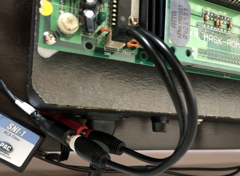

I made a cable for my SF2T board (3 pin JST to stereo RCA) & notice a definite improvement in the audio over mono. It does sound “clearer” and a little more defined with sound effects being split between left & right channels. I think non stereo CPS1 games output mono from this connector but with one channel being weaker than the other. Either way, the most important thing from this CN5 connector is that it appears to be already line level which is a huge plus for anyone that has an amp feeding this audio to speakers!
Also, the pot (VR1) for audio no longer raises or lowers the volume when using the CN5 connector (turning it while on makes no difference in output). O__o Appears that the audio volume from the CN5 is controlled from the amp you’re driving this into...

You don’t have to remove VR1. The CN5 connector works without needing to use it as its line level output apparently isn’t attenuated by it (I have tried this in my pic/setup shown above). Just leave it in place...it will still work with JAMMA mono audio.
