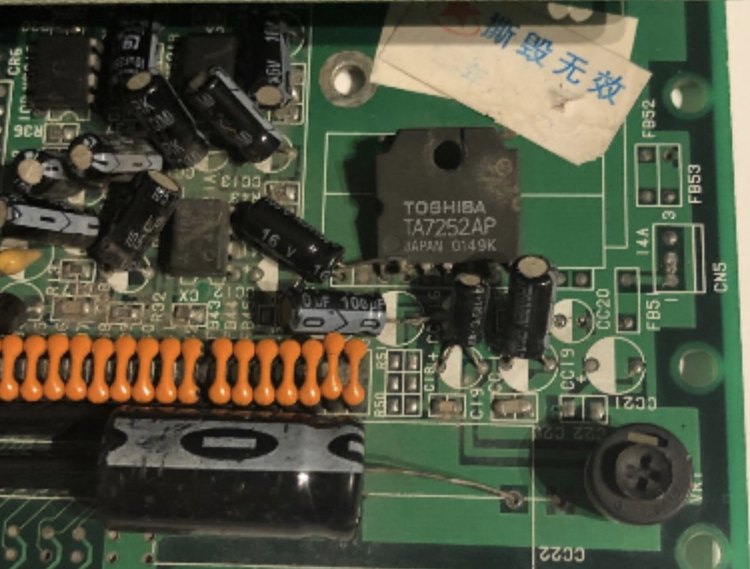

What does the audio section look like? Is it orignal or the hack job like i pictured above. If it's a hack, then you options are limited because of non-original parts. I would just message the seller and ask for a solution.

Yup, that's one of the cursed rebuilt audio boards. In addition those are not original ROMs, so I'd wager that your C board has been modified as well. Welcome to the club!
Those A boards are really rough. Avoid them if you’re looking for a multi donor.
They’re loosely populated with crappy caps and the sound pot has two settings only. 0 or 100. I have no idea why people are still wasting their time. There’s so many “proper” CPS-1 boards in the wild still that can be got for roughly the same price, if not just $30-50 more.

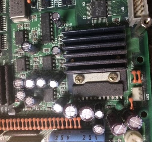

The sound section repopulation is junk. Even for casual use they should be avoided. Look at all the missing caps, components, heatsink, etc. Pretty sure this kinda shite will put a strain on the main board and probably kill it over time.
Capcom:
LegendHK:
