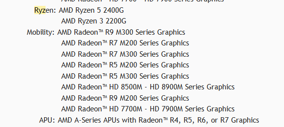

One thing that I wonder though, is if the crt drives work with built in graphics on cpu chipsets?
100% true. I've done it several times on with AMD A-series board sets with integrated graphics.

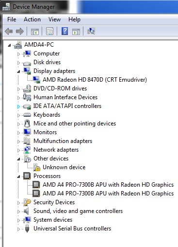

Just installed CRT Emu on the PC used in this discussion. Works just fine. I'll post a screengrab later.
And in terms of gpus if it's limited to amd gpus which is what I see on every page giving guides.
CRT Emu only works with AMD graphics cards. This is true. Not a bad trade off as Nvidea cards are much steeper in price.
Is it the same if I opt for something modern like a ryzen? Thinking about those mini form factor computers like NUCs but with AMD
As long as Calamity wrote a CRT Emu driver for your NUC, in theory it should work. It is impossible for him to stay up on all the hardware changes, but he has written CRT Emu for Ryzen-based graphics.

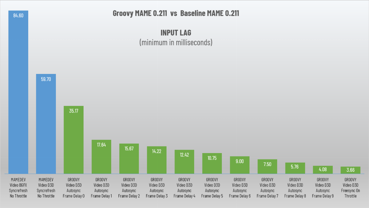

That video is actually missing options to further improve input lag. Calamity posts about it in the comments of the video.
Here are the measurements taken by oomek with his lag tester device:
All the way down to 3ms of input lag if your cpu has the power. I leave mine at "framedelay 2" as that has practically no lag.
