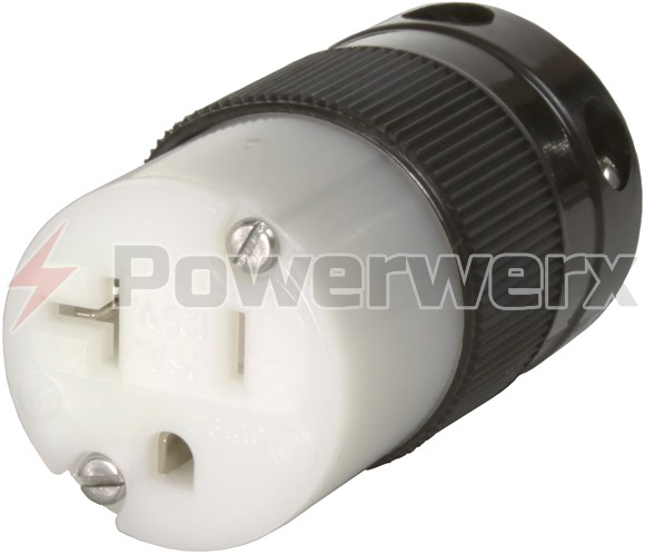

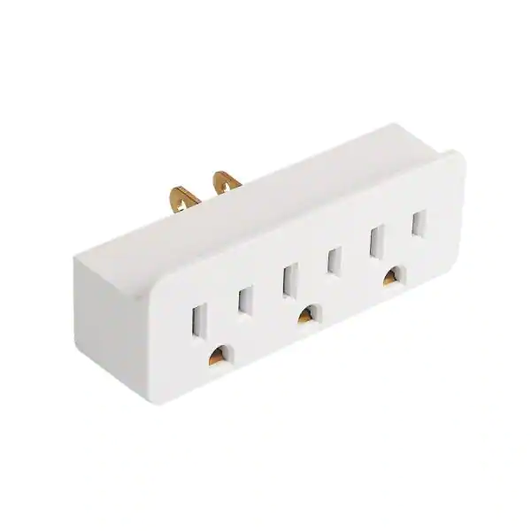

Cool @brad808. It does look like you need a PC to have an open frame however, yeah? Not everyone can situate their PC like that in their cab. Another user said he wanted his PC to be a NUC, so that is not an option in that scenario.
In this discussion, we will be powering the PC through the cab wiring instead of externally. We will be installing an AC plug very much like what @twistedsymphony has shown. In terms of the actual socket to be used, I'll add suggestions for other types such as these:
or this
Heck, you can even use this as long as you shield the connection to the prongs.
All situational depending on your cab and other factors.
