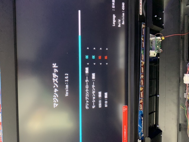

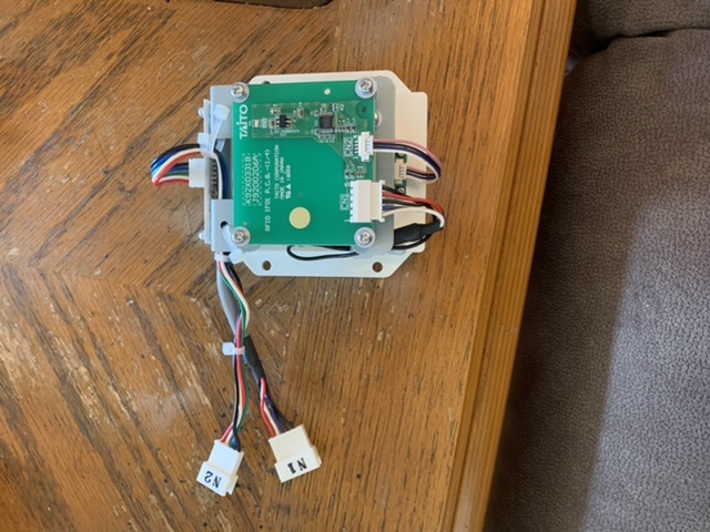

Thanks again. It looks like we have the same rfid but mine has 2 plugs labeled N1 and N2 where yours looks to have one maybe labeled V. The wiring diagram may have been compressed some during upload and isn’t really readable now any chance you can upload a clearer pic if possible. I may try to contact taito to order the harness cause making it myself seems like it would take a lot of time. Do you know part numbers of what you’d like to order. I can add it to my list when I email them for a quote although I’m in New York and you’re in Germany not totally sure if it would end up being cheaper for you but I’m willing to help if you need.

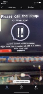

I also just tried putting all accessories in positions you had them in even though I still don’t have rfid. The nunchuck and leap controller both show ok but the usb io still shows ng. The message on screen after boot says “please call the shop. I/O Biden error(not sure what Biden has to do with this :P ) an error has occurred in the i/o device. Please check if the connection with the usb io is broken. Error 200

If you could show me a picture of the Japanese text, I could probably explain the Biden error to you :) .
About the RFID readers, at least the base board seems to be the same, but those readers you've got are AFAIK from a Dissidia Final Fantasy cab and unless you figure out the pinout on those, I can't see how you could use them for MD. I will send you a clearer picture of the wiring diagram shortly.

EDIT: For the pinout of those RFID readers you've got, maybe this will help you: https://www.arcade-projects.com/for...ica-rfid-card-readers-k92x0331b-pinout.13923/
I think you’re right about it being from final fantasy cab. That wiring diagram is great! From that diagram I can even figure out the pin outs for the rfid.

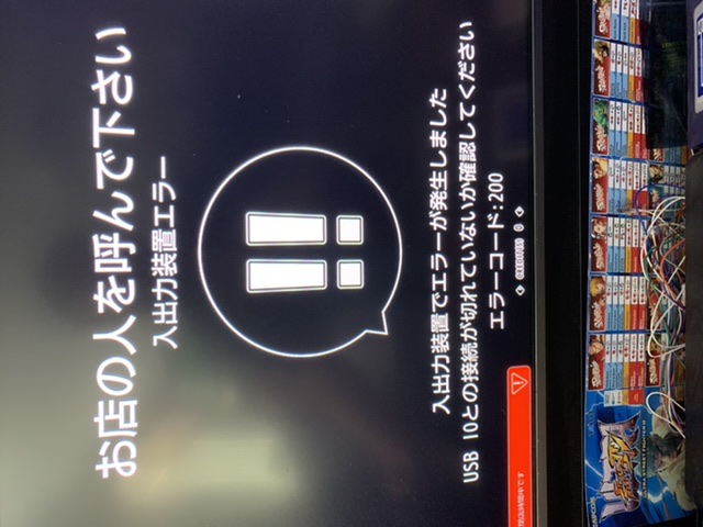

Here are some pics of errors on boot:

I don't see anything even remotely connected to Biden :) . The relevant part "Nyuushutsuryoku souchi eraa" literally means Input Output Device Error.

Google translate app isn’t always correct apparently. Thanks for clearing the Biden thing up.

If I buy the new harness from taito I will need to redo plug on my rfid. Is ylr-08v the correct plug to buy for that when compared to yours?
Yes, those brackets are what you need for the Vewlix L/F series. For the Diamond series you'd want the DISPLAY BASE BRACKET [E3021373]
The plug is most likely a YLR-12V. I say most likely because the digikey description is probably wrong. "Number of rows" is 3 and not 2.
At least there are 3 rows on my plug.
EDIT: By the way, looking at those screenshots you posted, there exists an even later version: 2.0.4 of the game. If the image wasn't ~180GB in size I'd upload it somewhere for you.
Cool I didn’t realize there were 3 rows I thought it was 2. I’ll order that and send email to taito about a quote and let you know what they say. Thanks again for all the help.
