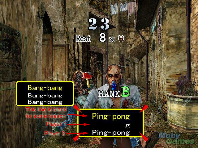

really it's an issue with EVERY text bubble as the first line of the bubble is supposed to display the word. so if you're playing 2 player you'll see the word 3 times. once for display, then the line for player one then the line for player 2.

you don't need a second player to see the problem. hopefully this picture helps:
when using the English dictionary files that top line always comes in blank.
in the english version it's the same text as the the lower line (or lower 2 lines if 2 player), but in the Japanese version the top line text is ALWAYS different since the top line displays the word in Japanese (kanji/katakana/hirigana) with the bottom line(s) in english (romanji).
I have to imagine the format of the Japanese dictionary files are slightly different to include the different top text while the english dictionary files don't have this since it's not needed.

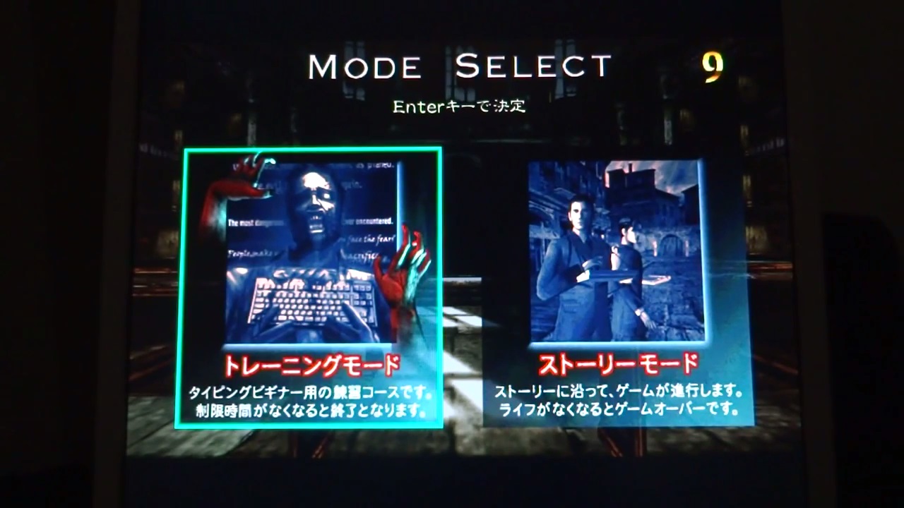

Going through the game a bit I've started identifying areas that will need manual translation. Most of these are just one or two words, and some of these could probably be blanked out all-together but others will be more work.
01. The Mode Select Screen
This is arguably the most important translation as it lets the player know which game mode they're selecting.

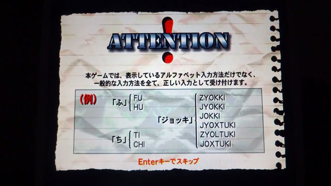

03. The Attention Screen:
This Screen seem to be instructing the player that they can type a single Japanese word multiple ways. Since this is completely irrelevant to the English version I wonder if this screen could simply be bypassed. Again, not clear if this is text or an image.

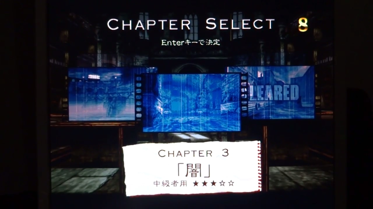

04. The Chapter Selection Screen
chapter name and description could probably be taken from the English version

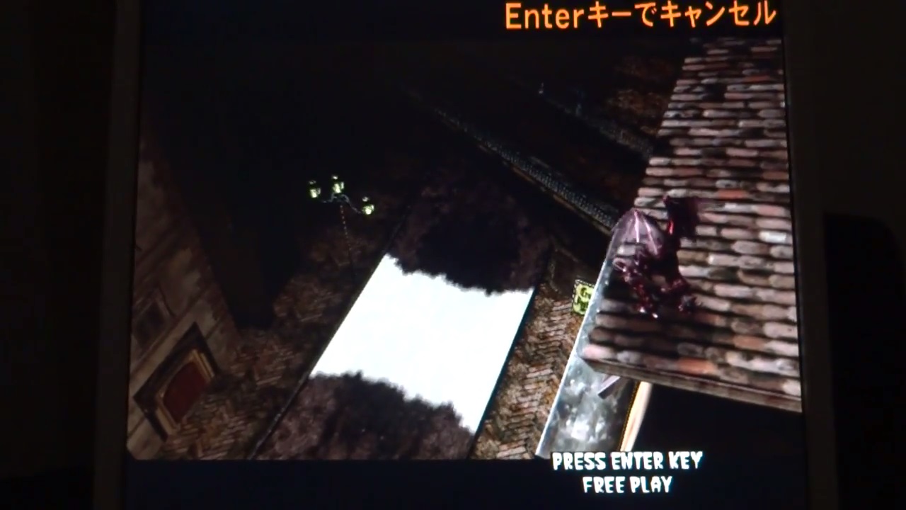

05. "Press the Enter key to skip" text
This appears on several of the other screen as well, I wonder if the text is only stored in 1 place and then referenced multiple times.

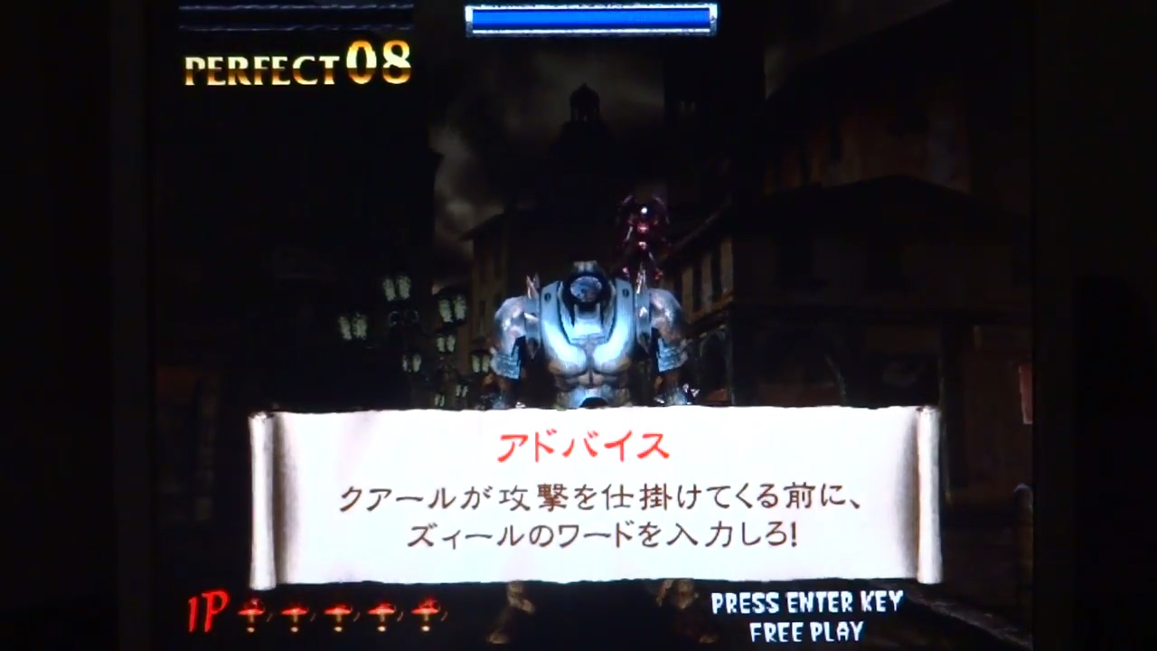

07. Boss Instructions
before each boss battle there are instructions on how to defeat, The text could probably be taken from the English version. After Mode Selection this is arguably the most important translation as it's relevant to game play.

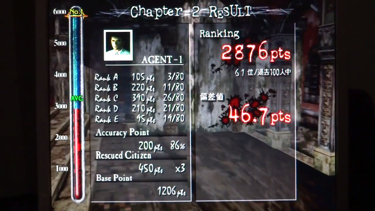

08. Score screen:
At the end of each level the score screen has some text on the right hand side.
