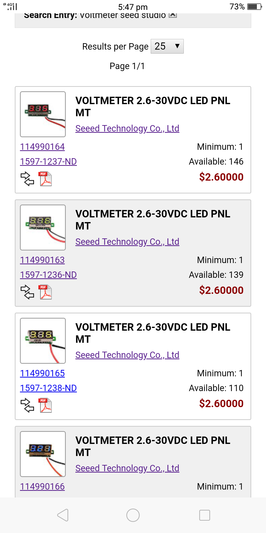

Can anyone suggest a suitable voltmeter part that can be added to the jamma connector. Digi key part preferred. Thanks

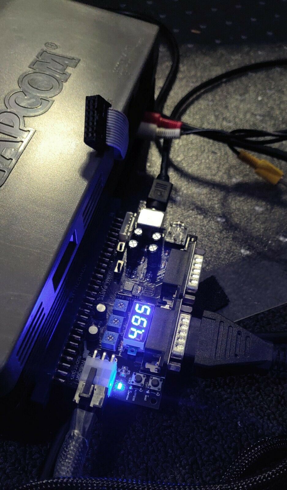

confirmed that exact voltometer (i got from online auction site for very cheap) fits just fine with some good double sided tape between the 1P DB15 and the R/G/B pots. Wired/soldered directly to the electrolytic cap between the pots and the THS amp.

Looks great and functions well :) This is using a digikey Meanwell 85 PSU.

@Frank_fjs Would something like this one work for the volt meter? If not can you provide link to one that will please. Also i see them coming 2 and 3 wire version. Will it matter?
Ebay Volt Meter
The third (in my case it was a yellow wire) is often used to accommodate higher voltage readings (30-100v), in the case of this PCB, you dont go any higher than 5 or 12v, so I removed the yellow wire and bridged the yellow and red wires on the actual voltmeter itself.
Yes I got mine from ebay for a few dollars each. I cant decide if yellow or blue looks better. Green is good too :)
