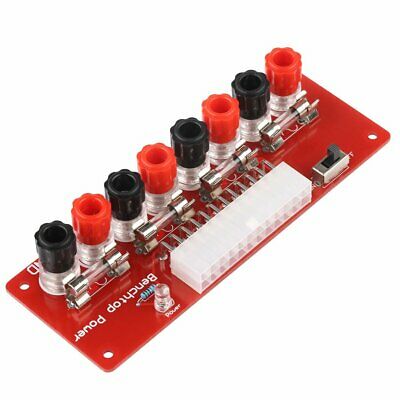

Would a computer power supply be suitable?
If it's of decent quality, yes. You lose the ability to adjust +5V however with a good quality ATX PSU it's seldom necessary.
You also have to consider that modern ATX PSUs don't output -5 which is required for audio for a small handful of games. You can overcome this limitation by using an older ATX PSU, circa 2003 and earlier, or incorporating a simple voltage inverter PCB.
You can grab an ATX breakout board to make power connections a lot easier.

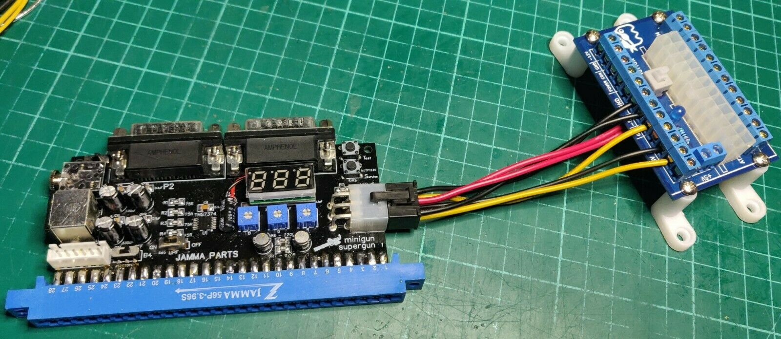

I have some of these which I bought - https://www.ebay.com.au/itm/292979346263
Then you can use any old PC power supply. Just harvest an ATX PSU (power supply) from any PC from the last 8 years or so and it should be fine.
For me this feels like the easiest power supply at the lowest cost, considering PC power supplys are everywhere and cheap and this adapter is under $15 AUD
Basic wiring from the power adapter to the mini gun via a molex 6 pin connector and wallah
Love seeing all the alternative thinking here! Clever solution @evilsim and adds a power switch to the setup too.
We should fabricate a similar ATX breakout PCB. Opens the path to Pico ATXs too.
