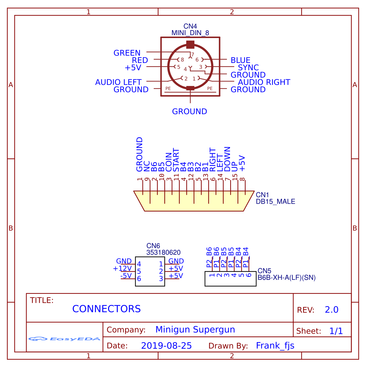

The Mini DIN pinout:

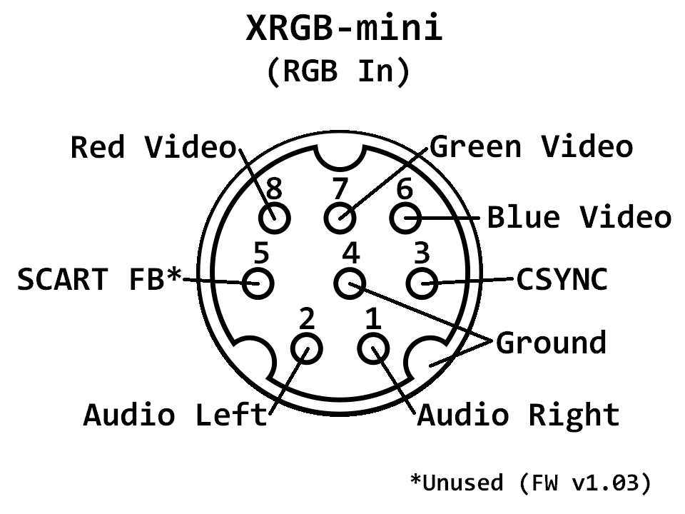

EDIT: on the XRGB-mini diagram above (8 pin mini din pin out) I normally wire 5v to pin 5.
If you do this with Tims 8pin mini din to scart adapters, the voltages on pin 8 and 16 of the SCART port will be accurate (will set tv to RGB fast blanking + 4:3 mode)

Pin 5 of the Mini DIN 8 connector goes to pin 8 in the SCART (Audio/RGB Switch). Blanking is pin 16 in SCART and it should be between 1 and 3V for RGB. I use a 180 ohm resistor in my SCART cable between pin 8 and 16.
More information here: http://martin.hinner.info/vga/scart.html

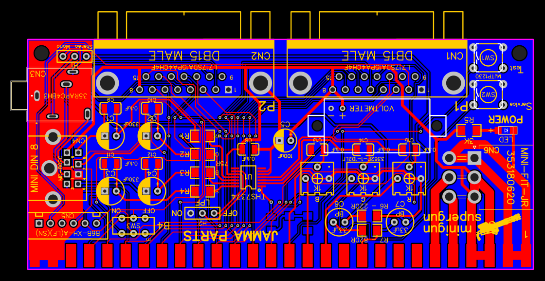

Version 2.0 won't be released as it's turned into a version 2.1. No major changes, namely:
  • Routing improvements.
  • Eliminated 5 x vias (for a total of 40 now).
  • Small ground plane added to top layer surrounding mini DIN 8 connector to provide some electrical shielding between video / audio / power lines.
  • Moved voltmeter downwards slightly (towards jamma edge). It fits fine as is but was a little close to the DB15.
  • Moved TEST and SERVICE tactile switches slightly further away from the edge of the PCB to give a little bit more room for mounting options.
  • Labelled the kick and power connectors with pin numbering on the bottom silkscreen.
  • Updated the VIDEO schematic to fix some minor errors and matched the component identifiers to the PCB labeling. Added a CONNECTOR schematic to show mini DIN 8 / DB15 / KICK / POWER pinout.

Was fun to solder it up. Well designed!
2.1 looks neat too.
