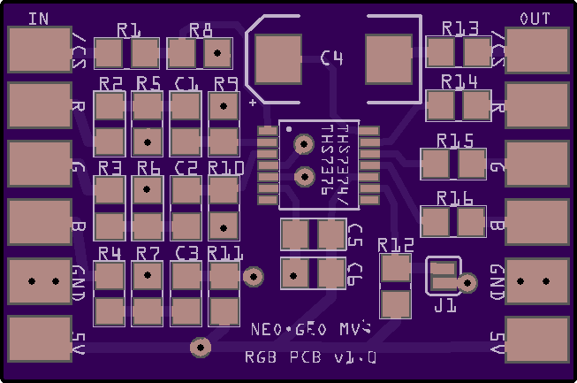

also, I would like to consolize a couple of MVS boards.. wouldnt it be optimal to use the video circuit from the minigun?
I can see many ppl recommend this one below thou.. anyone tried both?
That might work. Pitch and dimensions are the same, only discrepancy is that the JST uses 0.9mm holes whereas the Molex specifies 1.2mm. Not sure how much leeway there is, it might still fit.

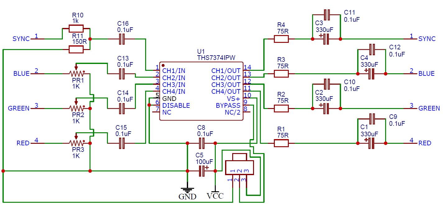

Minigun video circuit would work fine for this.
The difference between the board you linked and the Minigun circuit is:
- The other board uses fixed resistors instead of a potentiometer for the video levels, which means you cant adjust R,G and B intensity. This should be fine as long as you only want to support one type of hardware.
- The other board uses DC coupled output instead of AC coupled output. Both are reference designs. In theory, AC coupling can be more reliable/better on some video devices (but I have not seen much of a difference on my Trinitron or through OSSC)
Minigun video circuit would work fine for this.The difference between the board you linked and the Minigun circuit is:
Thanks for explaining man :)
Yeah the pots I totally get, was more curious about the rest of the design since I didnt find anything about that in the manual I had.
The manual only had the design used in the minigun pcb.
I will order some extra parts and make some separate video circuits for the mvs boards I want to consolize :)

What manual is that?
Anyways, just driving the output with 75 ohm resistors is totally safe, and as mentioned is one of the reference designs of THS7374, see the right side of the picture on page 1 in http://www.ti.com/lit/ds/symlink/ths7374.pdf
Most RGB bypass console mods do this as far as I've seen.
I use the one below in my consolized but the image output is too dark.
I have a Sony CRT and a CSY 2100 clone.
With the minigun it works fine because I can adjust the pots.
