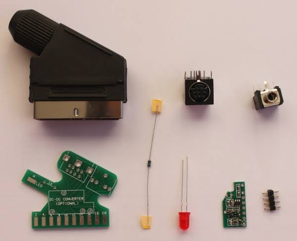

We've touched on this topic before, but as a reminder these mini DIN 8 to RGB scart kits from eTim are a great way to connect the video and audio of the Minigun Supergun to a monitor / OSSC etc.
The included DIN 8 cable isn't very good and best replaced with a higher quality cable.
The advantages being:
Proper scart voltage output on pins 8 and 16 for automatic RGB selection, switching and 4:3 aspect ratio.
Can run audio down the mini DIN 8 cable or separately via a 3.5mm stereo audio cable.
Can feed stereo audio from the RCA output of CPS2 (and other games that support external stereo output) to the 3.5mm socket of the DIN 8 / scart kit. Easy no fuss way of enjoying stereo audio.

Nope. Audio from the jamma edge never gets passed through. The 3.5mm audio input of the eTim scart kit is switched and therefore cuts audio from the DIN input.
Simply run a mini DIN 8 cable from the Minigun to the eTim adapter. This takes care of video.
Run a twin RCA to 3.5mm connector from the CPS2 RCA output to the eTim adapter 3.5mm audio input, boom stereo audio output over whatever your eTim scart adapter is connected to.
Audio from the Minigun DIN output (jamma edge) / eTim DIN input is disconnected due to the 3.5mm audio input of the eTim adapter cutting audio to the DIN.
Perfect and easy solution. :)
Ahh! I noticed that I get audio on the minidin but when I plugged in the audio jack it got disabled.
I assumed that the switching was being done on the minigun.
Not to confuse things, but the Minigun acts the same way. Once you connect to the 3.5mm jack of the Minigun audio to the DIN is cut.
However for the sake of what we're discussing here, CPS2 stereo audio, the 3.5mm jack of the Minigun isn't utilised.
Whats the Booster converter (DC-DC Converter) in that for? Do you need to put it in?
DC booster is optional.
It benefits CRT TV users as it boosts the 5V coming through the cable to 12V, and also creates a separate 3V. For scart pins 8 & 16. These signals assert RGB mode and 4:3 aspect ratio.
No benefit or reason to install it if you're using an OSSC.

In your scenario, you'd want to:
Run the RGC cable as per normal.
Insert a 3.5mm cable / adapter into the Minigun 3.5mm connector. This will cut audio to the Minigun DIN. You don't need to connect the opposing end to anything, it's just being inserted into the Minigun 3.5mm connector to disable audio being output over the DIN.
Something like this for example:
Feed the CPS2 RCA output into your amp.
You can't disable audio from the jamma edge via the CPS2 service menu.
