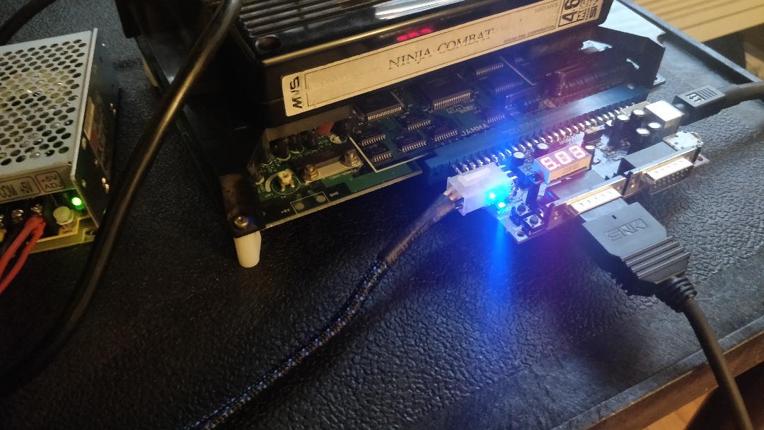

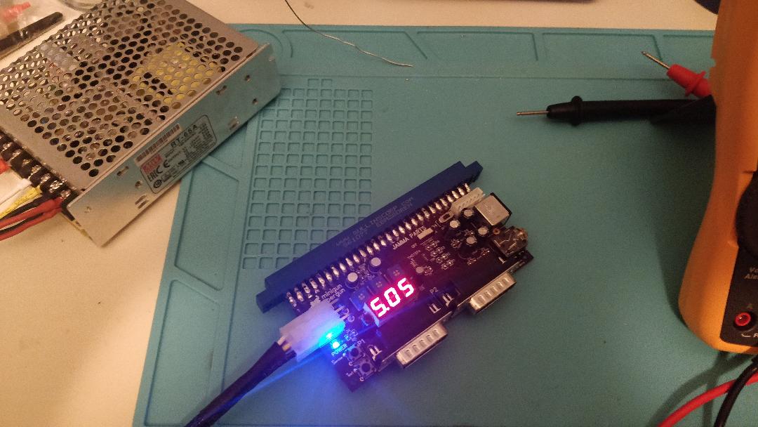

I ordered some of these pcbs and parts and finally built up the courage to take a crack at it. I am still a newb with soldering but have come a very long way from my first venture into the hobby which was panicking about soldering 4 wires to my DS CPS2 kit :P
Check it out, I put together my first supergun. I was so pumped when I powered it up and the 5V showed and nothing blew up! I was still a little nervous so I gave it a test run on Ninja Combat LOL.
Happy to say the thing works great. Tried it on 4 boards so far and everything works great.
Thanks again. This has really boosted my confidence in being able to keep my head above water in the hobby when I need to roll up my sleeves.
